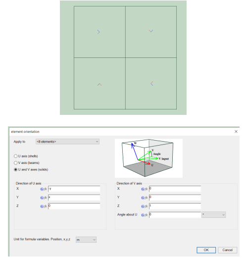

    “3) can't define element orientation for solids. it's locked to global xyz. so even though ccx uses solids for composites, you can't actually make and run a solid model yourself “
    Solid Element orientation accepts formulas. You are not forced to align it with the general axis. You could orient at least radially and tangentially.

  • maybe something was updated wrt solid element orientation. i did my testing a long time ago. back then, even if you defined an element orientation for a solid, it was ignored. you can view the element orientation by clicking on an icon in the toolbar. i would check to see if it was actually applied.
