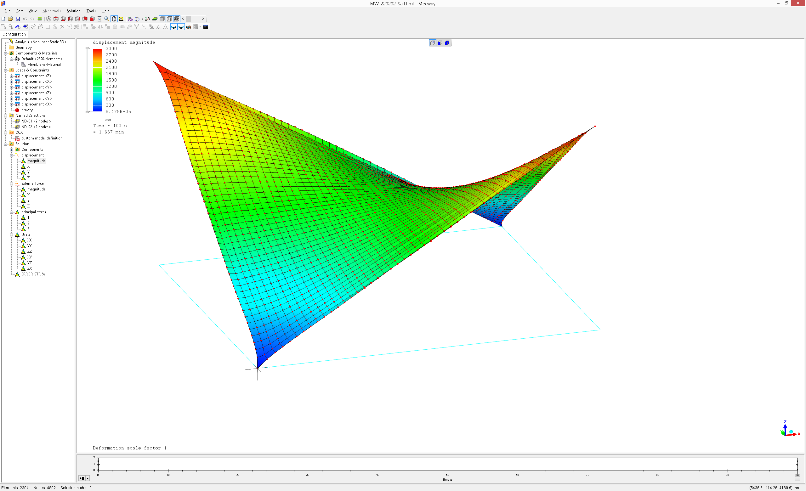

Form-finding on tensile structures.
Good evening COMMUNITY and VICTOR:
I enclose you a form-finding prototype on tensile structures. I modelled a square on the floor and lifted 2 corner nodes 3 meters up. To do that I used boundary conditions(displacements). I hope you enjoy the resulting 3D shape. It turned out to be a hyperbolic paraboloid. Regarding the fabric/woven material, I used TENSION_ONLY material, visit "custom model definition" on the general tree. To achieve the final shape quasi-static non linear 3D analysis on MECWAY v14th CCX 2.19 in-built needs to be performed.
Best regards
MANUEL MARTÍN
  • Very Nice example Manuel !. Thanks.
    ¿May I ask you something?
    I have notice there are some additional materials properties defined in the custom model definition.
    I have read in the ccx manual about them to understand their meaning and
    0.0005 (refers to thickness of the shell in meters)
    • Enter the CONSTANTS parameter and its value. The value of this parameter is 2.
    Following line:
    • E.
    • absolute value of the maximum allowed pressure.
    • Temperature.
    15E9, Young Modulus.
    5E6, absolute value of the maximum allowed pressure.
    N/A Temperature.
    What does “Absolute value of the maximum allowed pressure” means? Is it the Yield Strength?
    ¿Which values prevail when there is a custom model definition, E=15E9 or the values defined in MECWAY?
  • Dear DISLA:
    The TENSION_ONLY material only can be declared in "the custom model definition" item because MW does not yet support this material straightforward.
    -Regarding 0.0005(in meters according to VICTOR'S directions)=0.5mm. This is the thickness of the fabric used on shell elements.
    You are right about the constant definition. By the way, I did not include temperature definition.
    Only one thing to point out, the maximum allowed compression needs to be written down in |absolute value(N/m=Pa)|, otherwise it won't work out.
    In case you are interested in TENSILE_ONLY/COMPRESSION_ONLY materials, I recommend you to visit my recent post about "Clay arch simulation" in which I use a COMPRESSION_ONLY material assigned to tetrahedron elements. This kind of material model is required to perform brittle material simulations such us concrete, masonry or clay. I hope, maybe some day, that CALCULIX will code "smeared cracking materials" for simulating brittle materials however, right now, it is fine for me.
    Thank you very much for your comments. I really appreciate it.
    MANUEL
  • @Manuel.
    Thank’s for your response. I’m not sure 100% of which properties prevail when defining a custom model. Check carefully because the “Mass” tool use the density from MECWAY not custom model.
    If some values in the Solution Tree are computed internally using density, the result may be wrong. Don’t know about the others E, Poisson,…
  • I will open the .inp file to check out the values.
  • Very nice, especially that it appears to have captured wrinkling near the edges. Can you tell if that's real or some sort of error?
    @disla. Good point that the mass tool in the solution ignores any density defined in the CCX branch. Formula field variables depending on mass would have that problem too. But I think all the built-in field variables like stress, displacement, etc. use only the solution data from CCX, and at most transform it, such as converting stress components to principal stress, so that should all be fine.
  • Good morning VICTOR.
    About the wrinkle on the edge:
    I agree with you, the wrinkle on the edge is nice and MW caught that behaviour perfectly.
    In real like, that wrinkle needs to be removed.
    To do that, I must must cut off fabric on the edge(modifying the 3d model) and add a perimetral pre-stressed steel cable. I must design a 100% tension fabric (0% compression).
    MANUEL
  • edited March 2022
    Form-finding-Sail shape. [JMF]
    Perimetral steel it's being crucial to keep some initial tension and make it converge.
    Wrinkles may develop at the lower edges too.
    Runs in about 5 min with Pastix.
    ccx 2.19 is required.
    Thanks for your inspiring example Manuel.

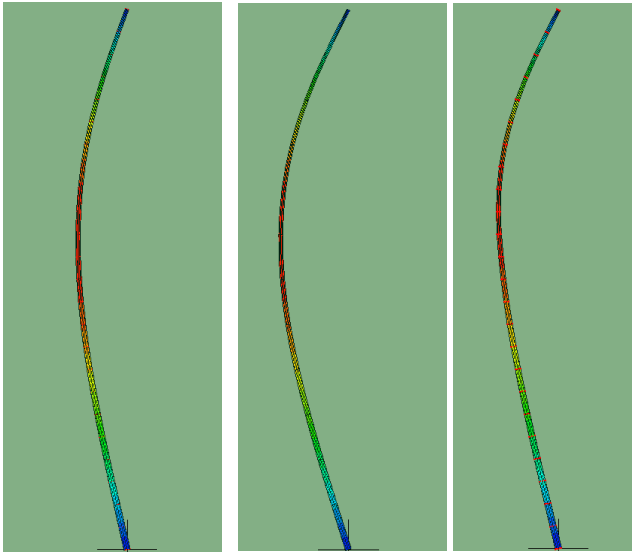

  • Hi JMF11,
    Hard problem and not too much information on the net. I have never built or design a Sail, that is the first to say and I assume it can be a very deep subject as it involves FSI. I have found you asking a similar question on other forums and mostly related with windsurfing sails as reference.
    I know these kinds of sails well as I windsurf since I was a child but never thought about them from an engineering point of view. As a very simple beginning , I would start looking at them as a simple buckling problem.
    ¿Have you noticed that good sails get almost their final shape just after the mast assembly? 90% of the sail shape is mostly recognized once you assembly the mast. (Talking about windsurf sails).
    I would start looking at the first buckling mode of different masts profiles. Masts with different thickness patterns (thickness of the section and thickness variation with hight).
    That would help me to :
    -Adjust the mast curve to the luff curve . The curve will move up or down depending on the thickness profile and material stiffness.
    -Get the tension required to start the mast bending (Buckling)
    -Get some qualitative shapes.
    -Get an idea of required thickness and resulting weight.
    -Will help you to discard some options and focus on a design line.
    Try to start with some SDM standard mast or one you like as starting point and then make small changes to see their effect .
    I think this could be an affordable first step if you do not have too much experience with fea. Buckling analysis of a mast should be from the computational point of view, fast, not too difficult to set up, easy to make it work, not convergence issues and easy to make changes and experiment different shapes.
    Forget about the sail itself by the moment. I'm sure you can get results in a few days that will increase your enthusiasm and will help you to further progress.
  • edited April 2022
    This webpage could also be helpful to predict your Mast performance and to see in which category it lies.
    I would use it to calibrate/validate my profile. Try to reproduce fabricator IMCS. FEA model can give you all the numbers to compute IMCS.
    Note IMCS is computed from a bending test not Compression test (Buckling). I can imagine it is much easier to set this test in a workshop.
    https://unifiber.net/windsurf-masts/bend-curves
    https://www.unifiber.net/windsurf-masts/mast-measurement
    As I comment , I would focus first on the mast.
    Edited. Added a liml file as example on how I would set up the mast. See how the shape change (qualitative) just with one mm. Keep in mind Buckling deformation shape (quantitative) is scaled and not real. To get the real shape you need to go to Nonlinear. (later)
    I guess you need a good modeled mast to further use it to introduce some realistic loads on the sail.
