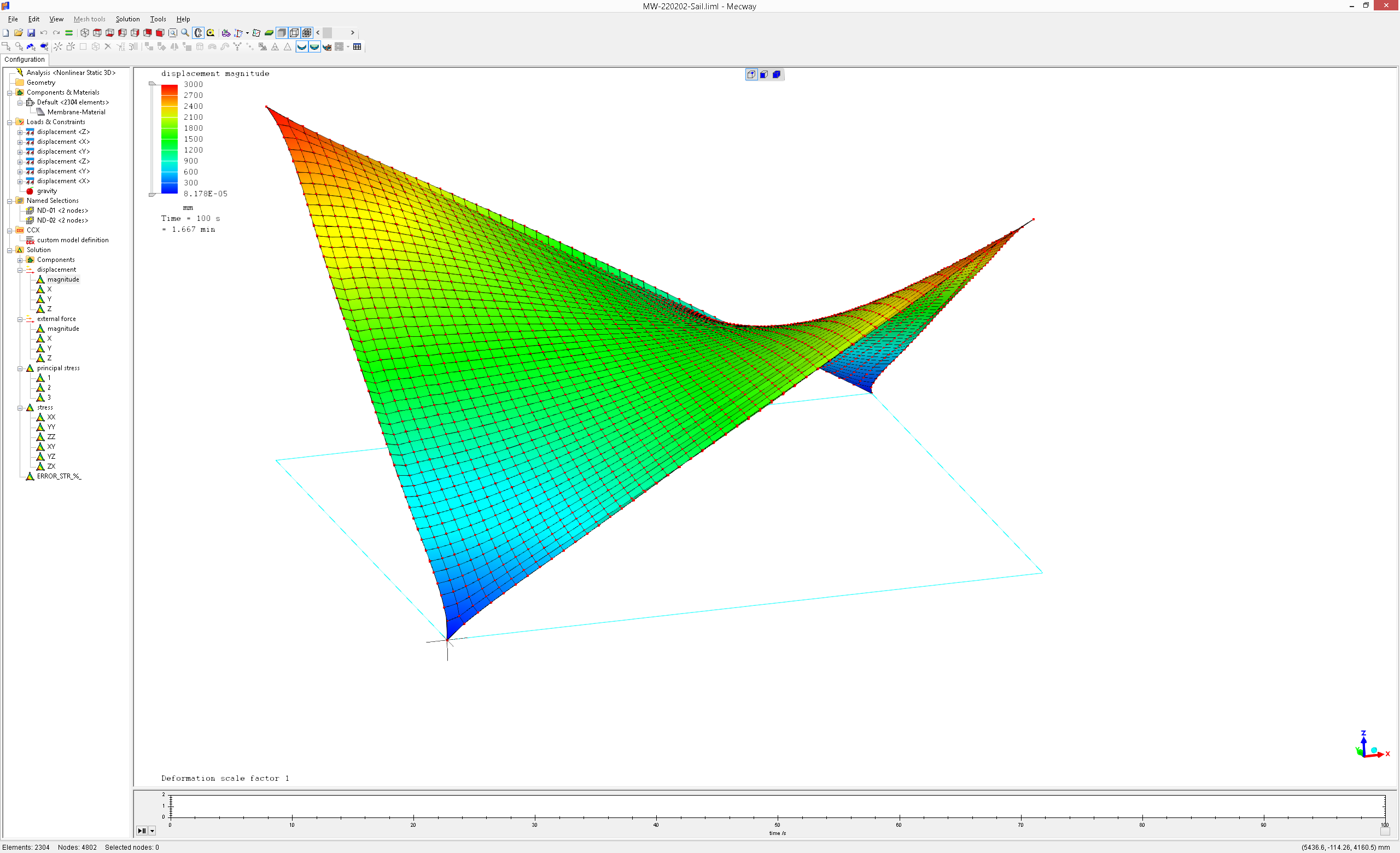

Good evening COMMUNITY and VICTOR:
I enclose you a form-finding prototype on tensile structures. I modelled a square on the floor and lifted 2 corner nodes 3 meters up. To do that I used boundary conditions(displacements). I hope you enjoy the resulting 3D shape. It turned out to be a hyperbolic paraboloid. Regarding the fabric/woven material, I used TENSION_ONLY material, visit "custom model definition" on the general tree. To achieve the final shape quasi-static non linear 3D analysis on MECWAY v14th CCX 2.19 in-built needs to be performed.
Best regards
MANUEL MARTÍN

The TENSION_ONLY material only can be declared in "the custom model definition" item because MW does not yet support this material straightforward.
-Regarding 0.0005(in meters according to VICTOR'S directions)=0.5mm. This is the thickness of the fabric used on shell elements.
You are right about the constant definition. By the way, I did not include temperature definition.
Only one thing to point out, the maximum allowed compression needs to be written down in |absolute value(N/m=Pa)|, otherwise it won't work out.

About the wrinkle on the edge:
I agree with you, the wrinkle on the edge is nice and MW caught that behaviour perfectly.
In real like, that wrinkle needs to be removed.
To do that, I must must cut off fabric on the edge(modifying the 3d model) and add a perimetral pre-stressed steel cable. I must design a 100% tension fabric (0% compression).

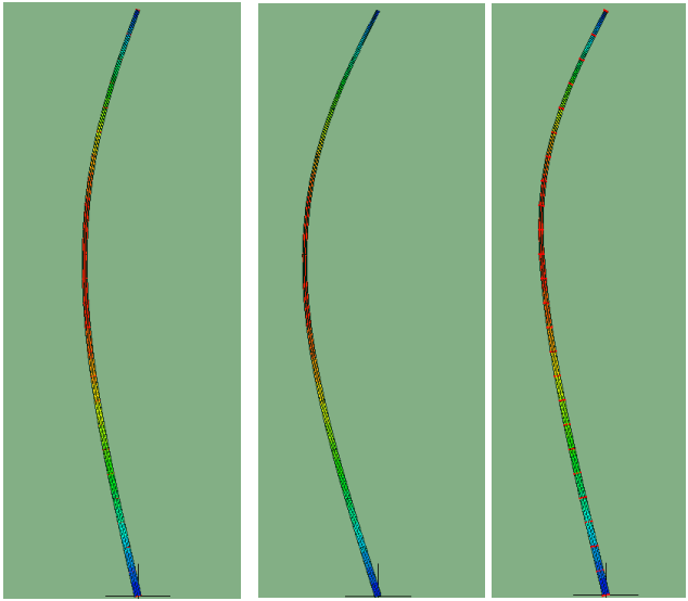

I know these kinds of sails well as I windsurf since I was a child but never thought about them from an engineering point of view. As a very simple beginning , I would start looking at them as a simple buckling problem.
¿Have you noticed that good sails get almost their final shape just after the mast assembly? 90% of the sail shape is mostly recognized once you assembly the mast. (Talking about windsurf sails).
I would start looking at the first buckling mode of different masts profiles. Masts with different thickness patterns (thickness of the section and thickness variation with hight).
That would help me to :
-Adjust the mast curve to the luff curve . The curve will move up or down depending on the thickness profile and material stiffness.
-Get the tension required to start the mast bending (Buckling)
-Get some qualitative shapes.
-Get an idea of required thickness and resulting weight.
-Will help you to discard some options and focus on a design line.
Try to start with some SDM standard mast or one you like as starting point and then make small changes to see their effect .
I think this could be an affordable first step if you do not have too much experience with fea. Buckling analysis of a mast should be from the computational point of view, fast, not too difficult to set up, easy to make it work, not convergence issues and easy to make changes and experiment different shapes.
Forget about the sail itself by the moment. I'm sure you can get results in a few days that will increase your enthusiasm and will help you to further progress.
I would use it to calibrate/validate my profile. Try to reproduce fabricator IMCS. FEA model can give you all the numbers to compute IMCS.

Edited. Added a liml file as example on how I would set up the mast. See how the shape change (qualitative) just with one mm. Keep in mind Buckling deformation shape (quantitative) is scaled and not real. To get the real shape you need to go to Nonlinear. (later)

Mast example: Euler buckling load of a hallow tube (Initial vertical tensile load transferred to the luff)
F = n * π^2 * E * I/ L^2
You can easy double the tensile on the luff and ruin the convergence playing with E or moving from 1mm to 2 mm thickness.
