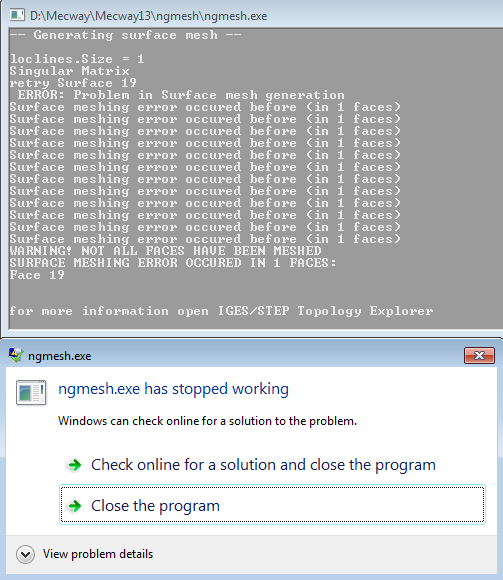

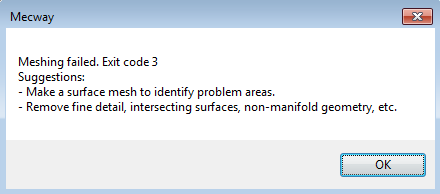

When I try to mesh the attached model (step + liml), Netgen (default) fails with the errors below. However, Netgen 6 succeeds. (The step file was generated with Rhino. Rhino's check for naked edges didn't show any problems. Also, I tried making a surface mesh (per Mecway's diagnostics) but the same error occurred.)
The Netgen (default) mesher says that there is an error (singularity matrix) on surface 19. Gmsh shows that surface 19 is the small quarter circle at the bottom of the center hole. Any ideas?

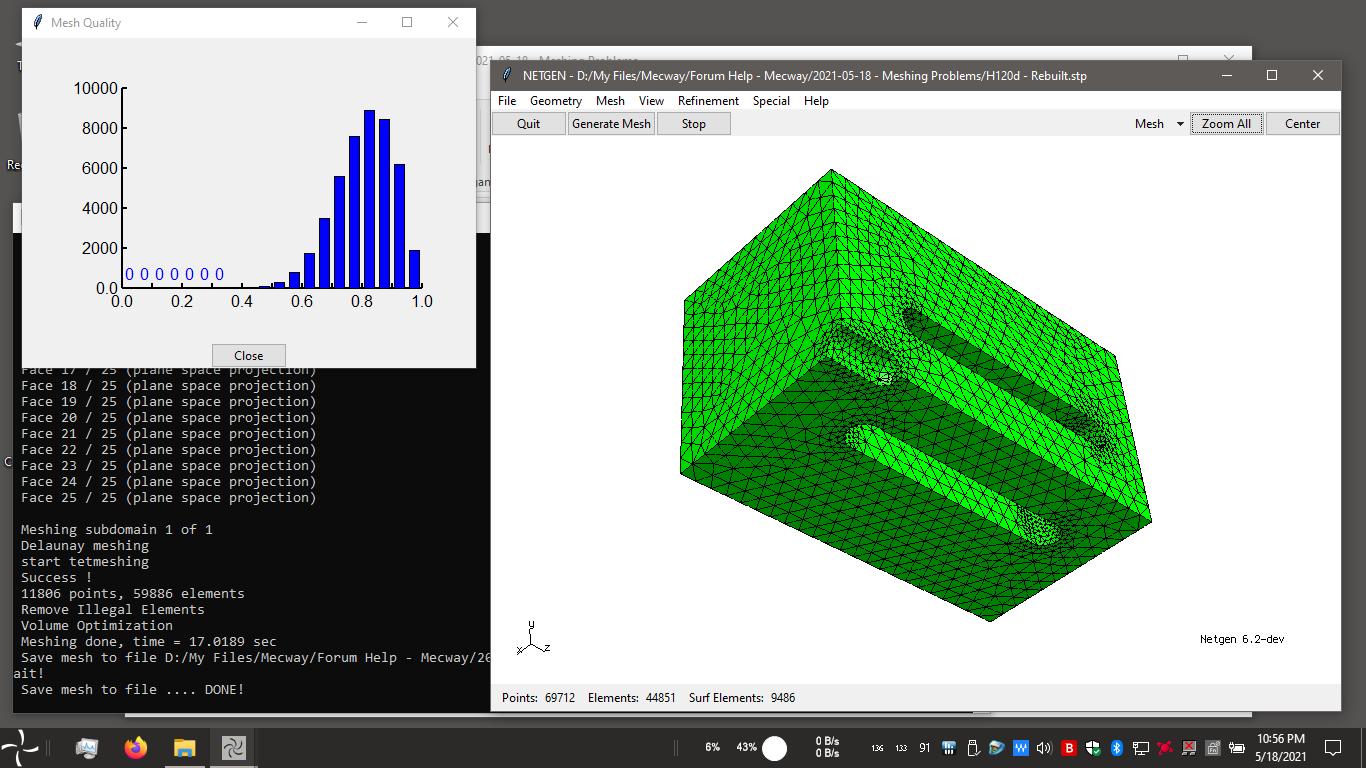

The messages are meant for the Netgen program. The topology explorer is in Netgen. So the messages don't really apply to Mecway. The base Netgen option is a modified version of an older Netgen program. The Netgen 6 option was something Victor added in later on. I'm not sure of the reasons. They are both Netgen, just different versions. I don't know if the Netgen 6 option has the modifications made to the base Netgen option. You can download the current version of the Netgen program and try it out if you want. I'm going to try out your files and see what's going on. When I have problems in the Netgen program I can't tell where it is failing either. There may be a way but there is not good documentation for the program.

I'm still wondering why Mecway's default Netgen mesher failed while the Netgen 6 mesher succeeded. I assume the default mesher has some advantage over the Netgen 6 or else it wouldn't be the default. There must be some significant differences between the two else why include both. Of course I could always try remeshing with Netgen 6 but I'm just curious about the default's failure, that perhaps that I need to change something with my modeling technique.
Gmsh successfully meshed this model. JohnM commented here (https://mecway.com/forum/discussion/849/meshing-techniques/p1) that Netgen "will often fail to mesh when GMsh works." Per your suggestion in that thread, I tried setting a min mesh size for Mecway's default Netgen mesher but that didn't help.
I see you have commented here (https://mecway.com/forum/discussion/989/mesh-quality) about having some problems with Mecway's implementation of Netgen. I'll have a look at Netgen's native mesher.

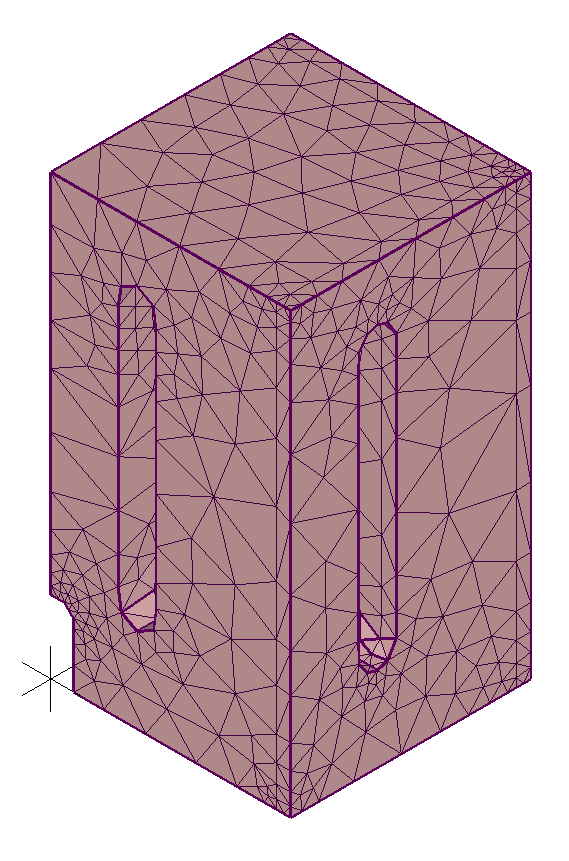

I deleted that surface, replaced it with one created from planar curves, and then joined everything. This new step file now meshes with Mecway's default mesher. Note the desired mesh on the top surface at 3.8 mm from the edges.

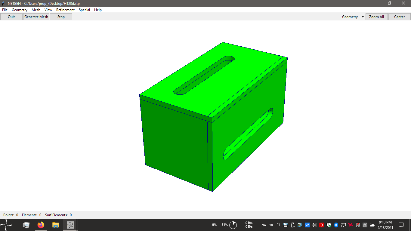

you caught on to something that i do sometimes too. in rhino if you have a seam in the model netgen will pickup on that and make the surface mesh follow it. i was thinking that might be why there was a problem. i guess that wasn't the problem in this case though. the more seams there are the denser the mesh becomes. so it's not a great idea to have a bunch of seams unless you need them. one model i had netgen couldn't mesh unless i added more seams. that wasn't good for me because it made the mesh huge. i do use the seams for boundary condition application though. it makes it easy to select things in mecway if you used seams to break things up as needed.
edit; hmm that's odd. when i check your step file in rhino 5 it says everything is fine. visually, the small hole looks fine. however, i tried rebuilding just the hole and it works.
