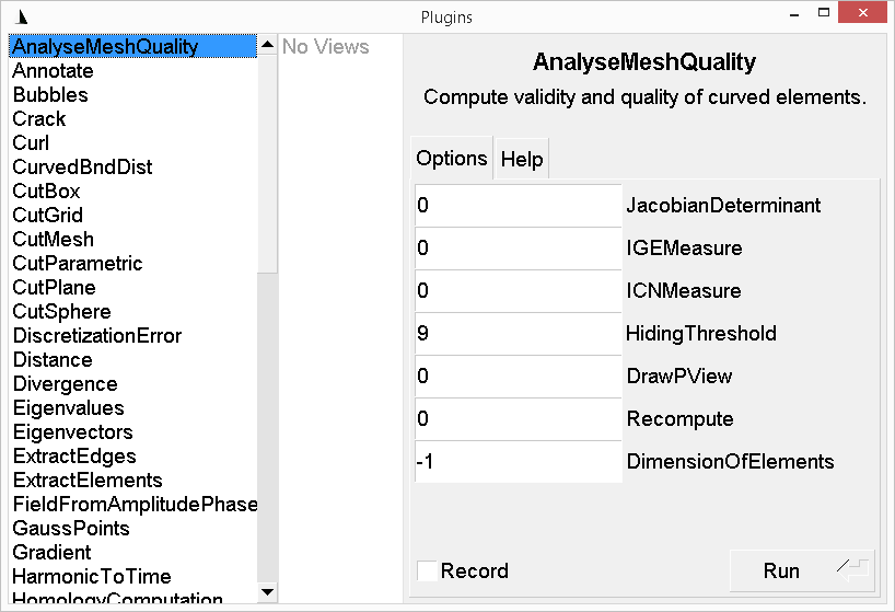

  • Good morning JASE:
    I want to share a couple of thoughts with you:
    I do not know in MW but you can certainly do it when you mesh using gmsh(ONELAB-statistics->Mesh).
    If I am not mistaken, you can query about this info when using SALOME-MECA.
    MW always warnss you about distortioned members(negative jacobian,...)
    MANUEL

  • Thanks to Manuel and Victor for their inputs . So I understand that mesh quality is not yet a MW feature (but may become it soon ? ;-) ).
    BTY, mmartin's screenshot is a bit unclear to me. Where does it come from ? Plugins in MW ? or elsewhere ?
    Thanks for your support.
    Jase
  • Hi Manuel,
    After re-reading the post, I came to theguess that the plugins are the ones available in Onelab. I'll have a look to it. Thanks for the hint.
    BR
    Jase
  • My apologies for the confusing screenshot I previously sent.
    You are absolutely right. I remembered about the mesh quality plug-in from Onelab (gmsh package).
