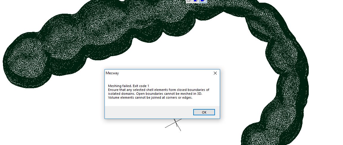

Hey @disla, I tried that option but Mecway failed to import it without error message, so i converted stl mesh to .unv and i got an error, attached is the image. I am also attaching my .stl hollow file, in case you find whats wrong with it.
Hey @disla I repaired some errors in meshlab and imported the new stl file into mecway but it gives the same error as before. Attached is the new stl file
Since this is so thin, I think you should extrude the old surface mesh (Mesh tools -> Extrude) instead of using Automesh to create a volume mesh. By extruding, you'll get prism elements which are a little better than tetrahedra from Automesh 3D.
This STL file isn't watertight, at least not after importing. That will prevent it from meshing. You can find the faults with Tools -> Labs -> Find non-manifold shells which selects the bad edges. If the Labs menu isn't there, turn it on with Tools -> Options -> General -> Labs.
ERROR: TRIG 29503 has 2 neighbours!!!!
ERROR: TRIG 29512 has 5 neighbours!!!!
ERROR: TRIG 29515 has 2 neighbours!!!!
ERROR: TRIG 29516 has 2 neighbours!!!!
ERROR: TRIG 29519 has 2 neighbours!!!!
ERROR: ++++++++++++++++++++
ERROR: 8 wrong oriented neighbourtriangles found!
Netgen has an Stl Doctor.
https://ngsolve.org/files/windows/
Hope it helps.
