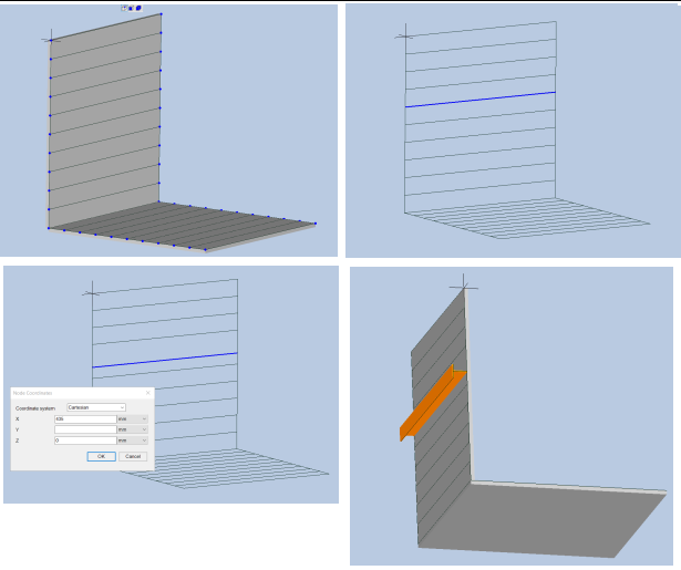

    Beam elements can't be offset. What I normally do is to align the closest set of nodes to the final stiffener position using Node's Coordinates/Mesh tools menu. Then, select the aligned nodes and press line/surface to get the common line and extrude it to build the desired stiffener shape. It is easier than drawing the stiffener and then merging or stablishing the contact. It would be a stiffener made of Shell plates. It also works on curved shapes.
  • edited July 2022
    For complex stiffening paterns or double curved shapes you can also draw your stiffener profile on a node and then Sweep it along a path drawn on the shell surface. Of Course you will need connected nodes along the path.

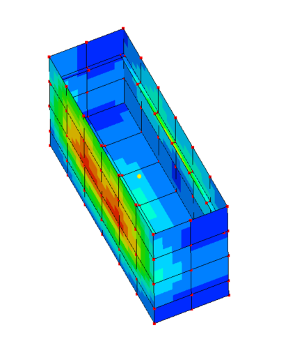

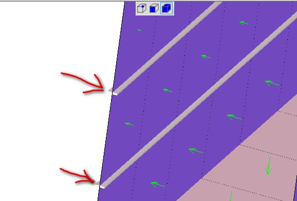

  • Dear Disla,
    thanks again for your feedback. Beams offset will be improve the program in the right direction.
    I tested in the meantime several options to create modifiable stiffeners and came to the conclusion that your first hint is the best for my type of models.

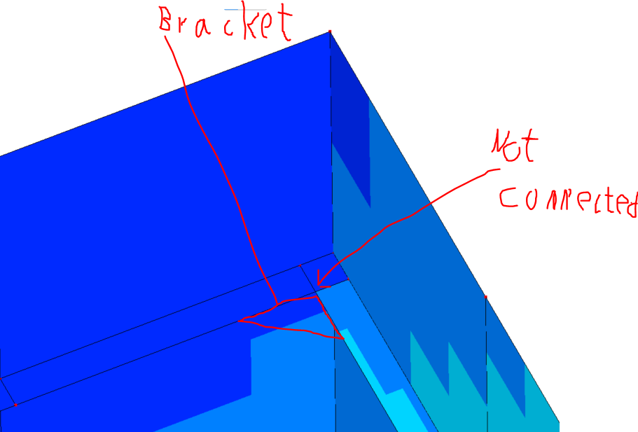

    I also accept that the end connection of faces are not connected correctly. See pictures
    So in this case they are defined with sniped ends. This is fully okay when the structure is designed in this way.

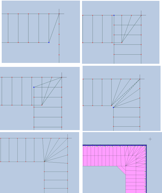

    My way to create a fixed end connection:

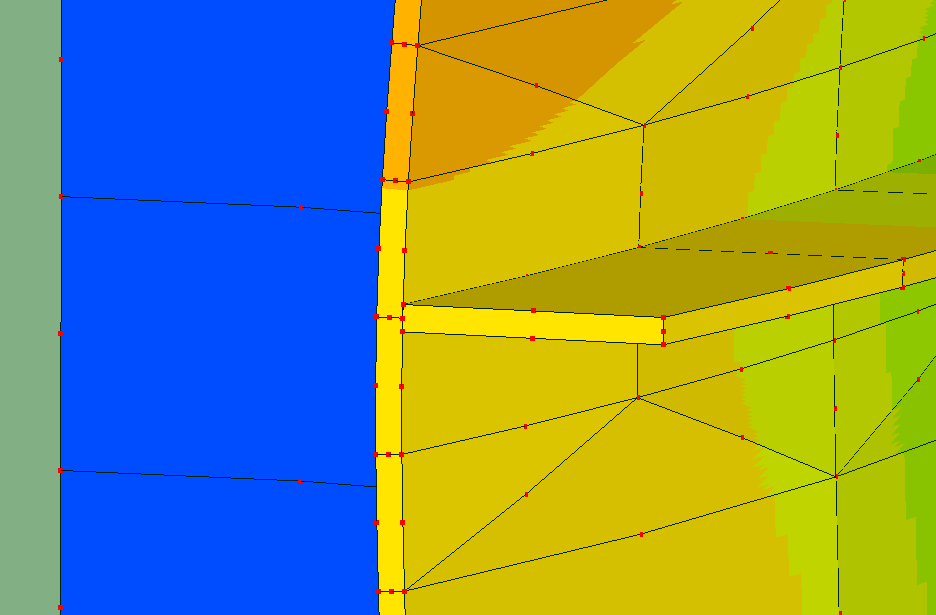

    If the stiffeners connected by a bracket the grid has to be refined and a bracket can be added by a Element type "tri3" or "tri6". For sure this not comfortable but feasible.

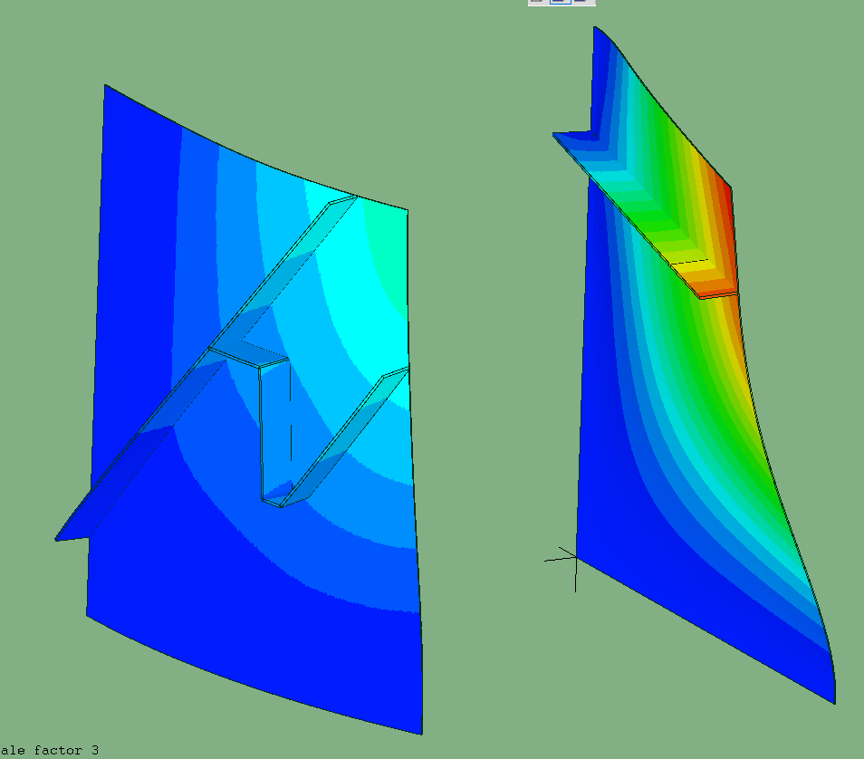

  • edited July 2022
    I normally don’t stiff from the inside (except for the trays on distillation columns as they are the stiffener and the tray support at the same time)
    In my applications there would be product accumulated on top of the stiffener and it is not ok.
    In your case I would proceed as shown in the picture with an additional final refinement. It is directly handmade extruding.

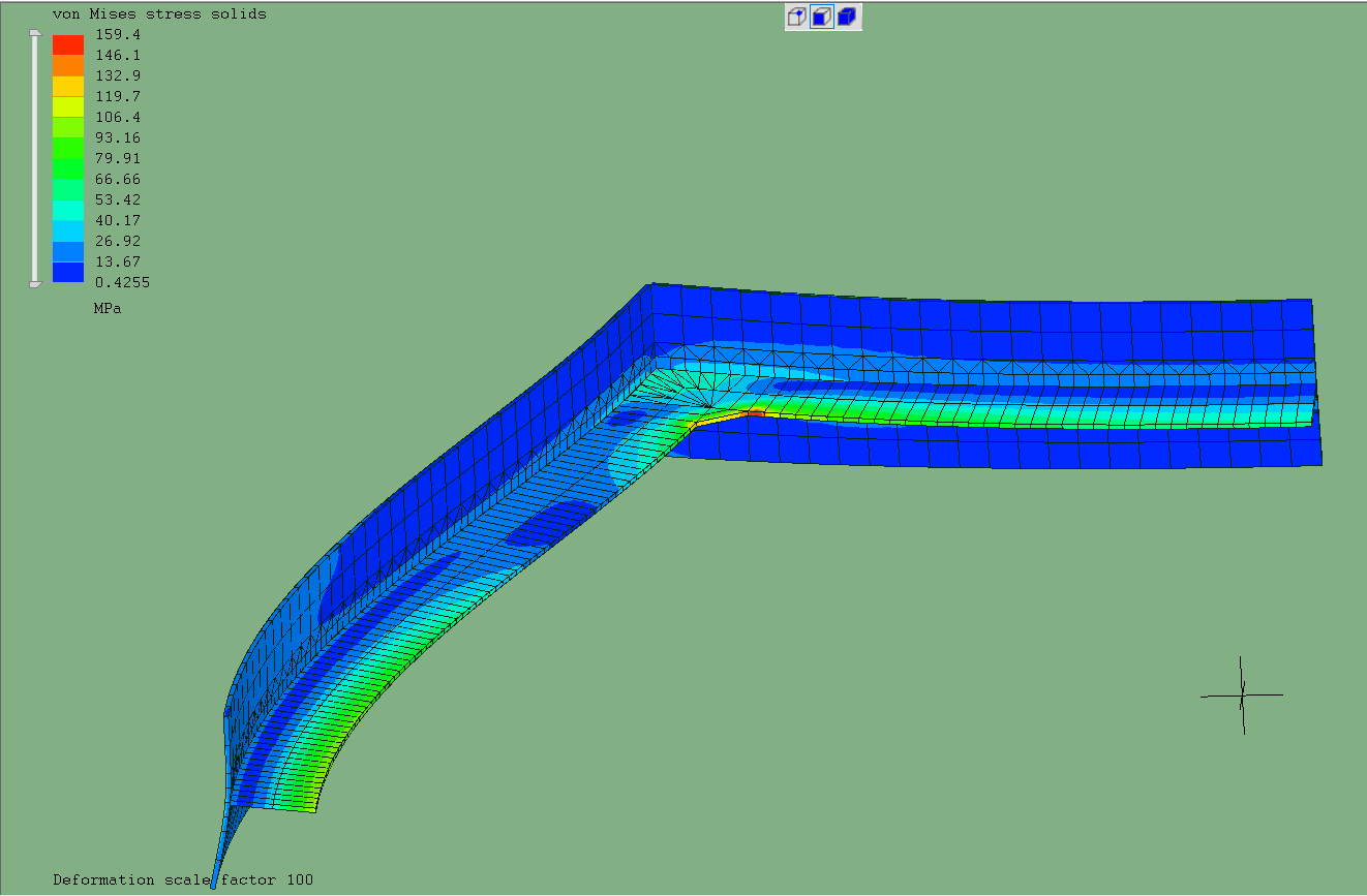

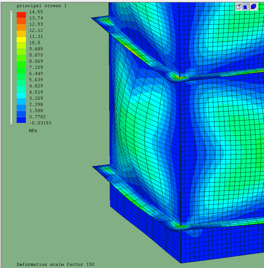

  • edited July 2022
    The file with quadratic elements (>1000 nodes) looks much better.
  • edited July 2022

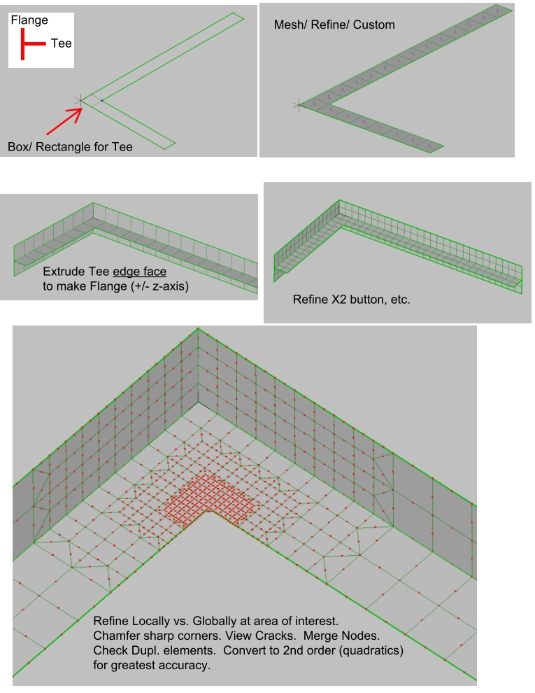

    Hmmmm. Aspect ratio of triangles look a little sharp, but results were comparable to a full quadrilateral model.
    When modeling shells, I try and use the largest element size possible, then refine from there.
  • edited July 2022
  • @cwarpe
    Looks great!
    @Nordlicht
    Your chute looks symmetric. If your box is a rectangle, you could apply symmetry and you only need to model one corner.

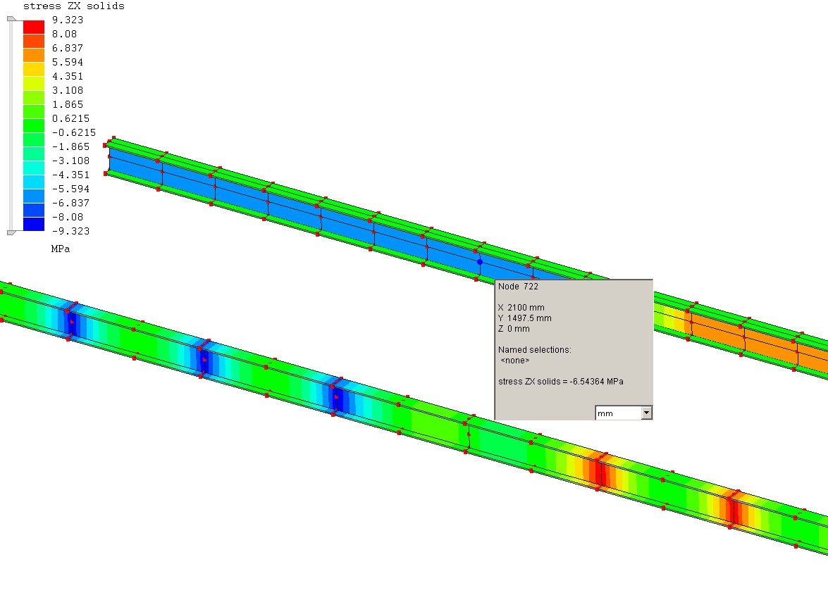

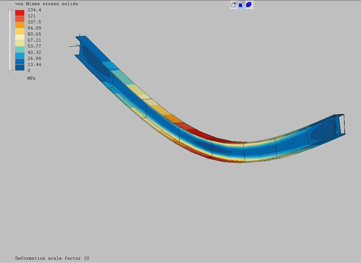

  • edited September 2022
    The offset card allows to build custom beams in ccx extending considerably the available sections.
    I have tested with a custom build IPE160 but I don’t really think it is worth the effort unless one builds a library or needs a specific custom profile.
    This kind of assemblies requires a bunch of nodes to get reliable results compared to the internal for example. Some of the elements are not very accurate.
    Shear ZX Stress seems to show discontinuities in-between elements.
    Never know, maybe someone finds an interesting usage (probably as custom Stiffeners ,composite beams, or more detail on stresses inside the elemnts) . I have attached the tested IPE160 file and the comparison results for a punctual load. Good result is obtained with 312 nodes compared to the 5 nodes with the internal solver.
  • I looked at this model
    I noted a strange behaviour of shear stress. It's unreliable in therms of value and distribution.
    Maybe is better to use shell elements.
  • edited June 2023
    Right.
    EDITED:Reduced integration doesn't seem to have this problem.
