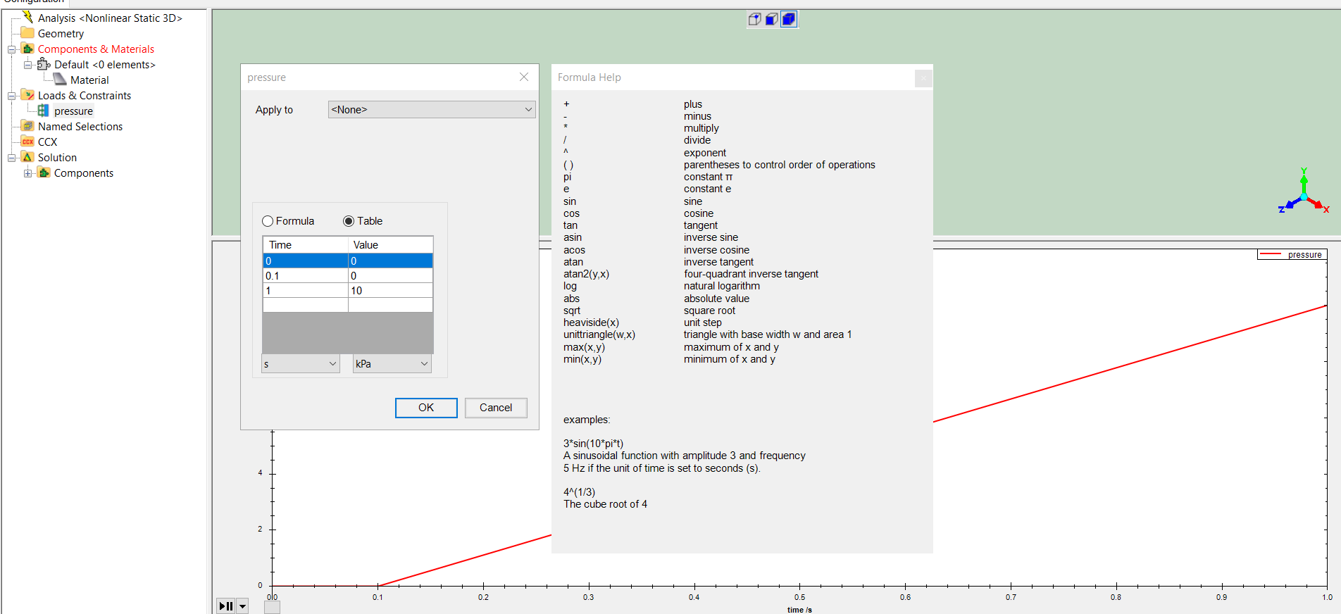

    In the arch analysis there are mainly two load conditions: self weight of the model and variable load due to traffic. I'd like to run an analysis by applying the self weight first and then the traffic load. This because the self weight stabilizes the arch, while the traffic loads tend to produce tensile stresses.
    As far as I understand, the CCX solver allows to increase all loads at the same time.
    Isn't it possibile to run two different load steps, the first by applying the selt weight only and the second by applying the traffic loads after the self weight is already applied?
    Thanks,
  • edited June 2022
    You can do that easy defining a load table.
    When Nonlinear Quasistatic analysis is active, loads can be entered as a function of time by means of a function or a table. Wait some seconds before activating the pressure load. You have a lot of possible combinations. Load functions are also available like heaviside, sin, cos, ...if you want to introduce them in a more complex way.
    Once you familiarize with the software you can also introduce a load that cross the bridge. It is explained in the forum. Mpg video Attached.
    https://mecway.com/forum/discussion/comment/5741/
  • Thanks disla, I've defined the load tables and it works fine.

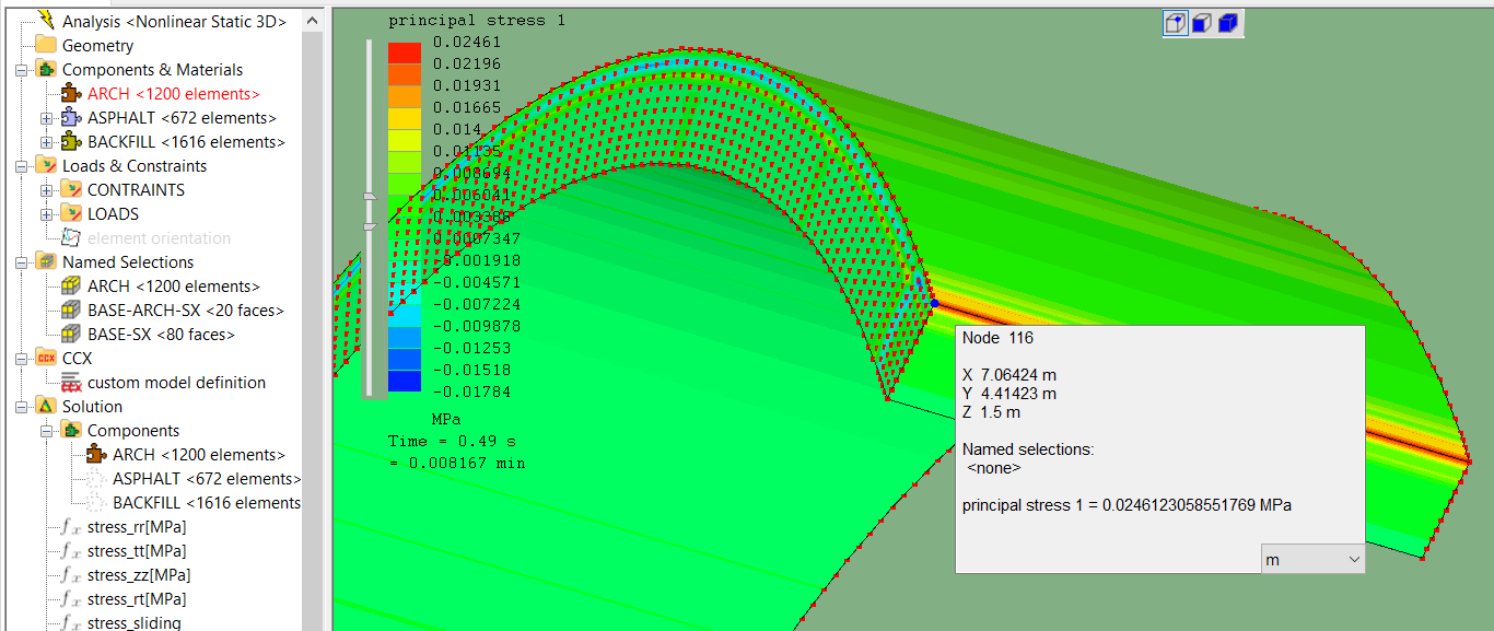

  • I'll report a few strange things I have found by analysing and comparing the results of the non linear analysis with a linear elastic one.
    1. In terms of stresses over the arch, the two solutions are equivalent, except at springings, where the non-linear analysis provides smaller stresses (about 15%). However, in the non linear analysis, at midspan I get a tensile stress of 0.03 MPa even though I've specified 0.02 MPa as maximum tensile stress value in the compression only setting. What do you think about this?
    2. If I measure the volume of the arch (29.24 m3) and calculate the corresponding mass by considering the density value specified in the custom model definition (2100 kg/m3), I get a total mass of the arch equal to 61404 kg.
      By calculating the mass of the arch on the basis of total vertical reactions, I get a value of 42628 kg, about 30% smaller than the real one.
      I don't understand why I get this discrepancy. Since the weight of the arch is much smaller than the weight of the backfill, the global error in terms of reaction is low (about 5%), but I can't understand why there should be any difference.
      Looking at the value of the error (30%), it might be due to something related to the shell thickness (3 m). Any hint on this?

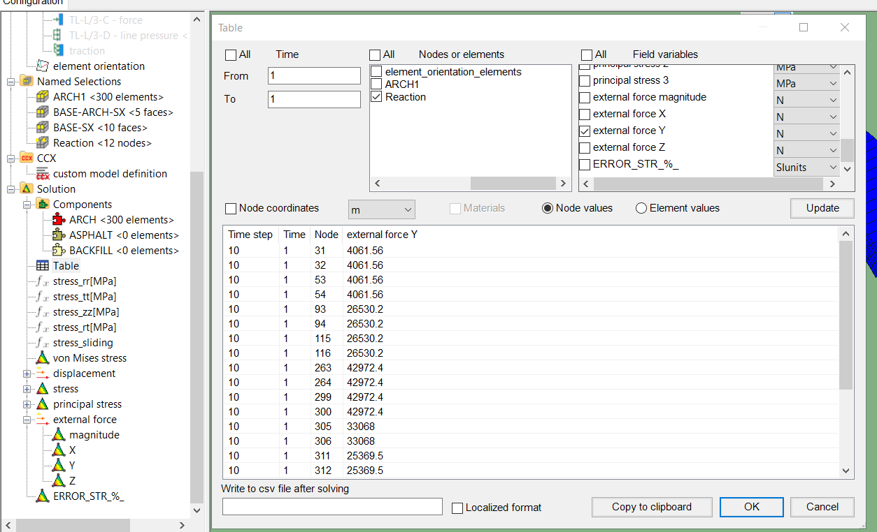

    2- ¿How do you get the reaction forces from shell elements?
  • 1) In my analysis, at time 1.0 s, the principal stress 1 at midspan is 3.2 MPa, which is the same of the tangential stress "stress_tt".
    2) I was looking at the sum of external forces in the y direction over the named selection BASE-SX.
  • Weight and reactions are very close too. It think it will get better with some refinement.
    You can create a New table in solution.
    Check in the manual.

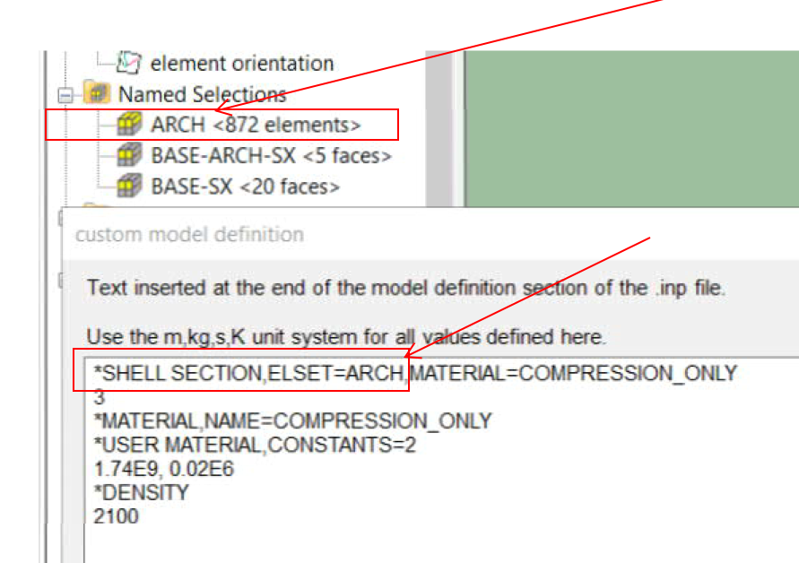

  • I found your problem.
    You have not defined the element selection called ARCH.
    Your custom model ELSET is pointing to nowhere.
    Maybe Victor can take a look at this as it should fail and it is not.
    Take into consideration these are kind of tricky things are out of normal Mecway procedures.
  • Even if I define the Named Selection ARCH, I don't get any difference in the solution.
    Did you manage to obtain different results?
    My model still provides a wrong result of the arch weight, that I measure by using the function Sum applied to External forces in the y direction over the named selection BASE-SX.
    In the same way, the maximum principal tensile stress at midspan (and in the same way the tangential stress, which should be equivalent in that point) at step 10 (t=1 s) is equal to 0.032 MPa, larger than the defined 0.02 MPa.

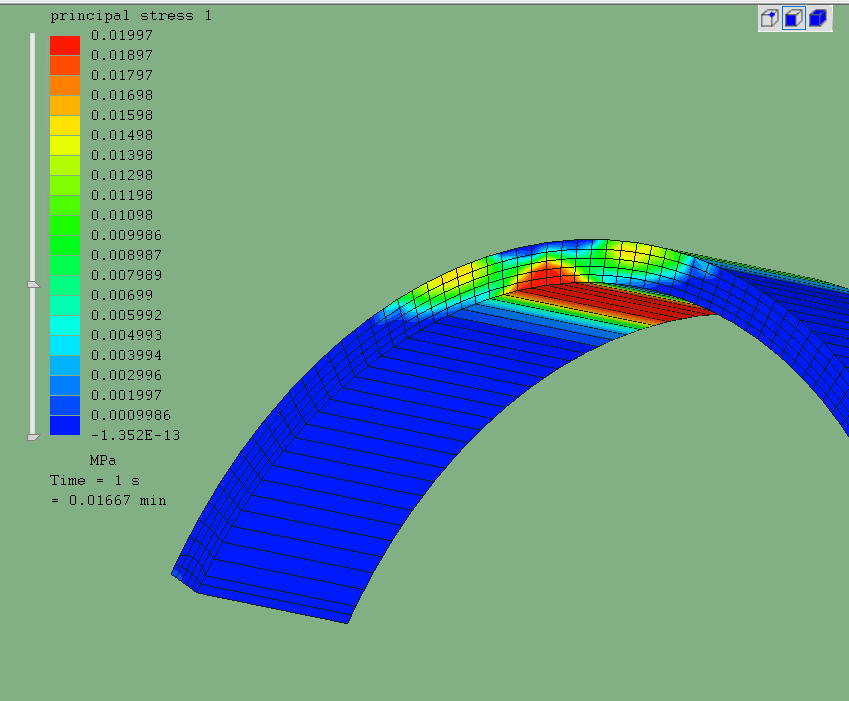

  • @AndreaC91, principal stress 1 at that location reduces to 0.019 MPa with a Refine x2 applied. I guess the tensile stress is being tested at integration points inside the element so it might be higher at the surface.
    BASE-SX is only one side's support. Not sure if you doubled that? I get 801kN as the sum of external force Y on all the Y constraint nodes (displacement_nodes(2)) at t=0.5 s. Is that the erroneous value?
    I'm pretty sure density is always mass per unit volume, not area, so I wouldn't expect thickness to be a problem.

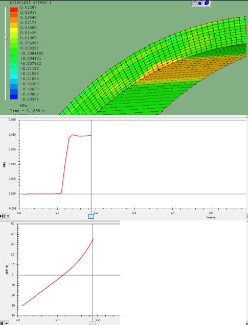

  • edited June 2022
    Hi Mike and thanks for your comment.
    I started again from Andrea file and one additional refinement makes the big difference.
    @Andrea.
    I have set up the whole model as Compression only and everything keeps below 0.02 MPa.
    If I set only the Arch, it exceeds punctually to 0.024MPa but it is in a corner where the node is shared with a regular element (Node value is averaged so it can exceed 0.02Mpa.
  • edited June 2022

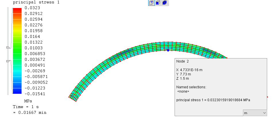

    With respect to the tensile stress value, I can't test the refinement effect due to the limit on the number of nodes in the version I'm currently using but, if this is the solution, there is no big issue.
    However, my main concern on this point was that both the compression-only analysis and the elastic analysis provide the same tensile stress of 0.032 MPa.
    This sounded strange to me but probably it is just a matter of refinement.

    @Victor If I measure on BASE-SX the sum of external force Y at t = 0.5 s, I get 1610 kN. BASE-SX does correspond to one side's support.
    On the other hand, if I measure on Displacement_nodes(2) the sum of external force Y at t = 0.5 s, I get 3204 kN, which is approximately the double of the value I obtained on BASE-SX.
    Now, if I run an elastic analysis, the sum of external force Y over BASE-SX is 1702 kN, which should be the correct value from hand calculations.
    What do you think?
    Thanks,
  • I believe the element properties are applied to the element, not the node. So if the stress in the element is under the tensile stress limit a corner could easily be over it. For a location where the stress does not vary drastically over the element these corner stresses will not have such a large error. The node in fact is a part of all the surrounding elements and constraints and the stresses and strains will never be right at a node. This is why many models have a finer mesh at these areas with rapidly changing strains or stresses.
