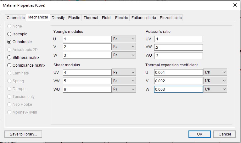

I'm playing around with orthotropic solids and made a simple test model to see where the material constants map into Engineering Constants in the CCX input file. They appear where expected except that the nu12 is mapped twice (nu12 and nu13) and the value for nu13 does not appear. Is this a bug or am I missing something? I've attached the model, the CCX .inp file and the material input dialog.
  • There's a difference in the definitions. The Poisson's ratios in CCX are
    nu12, nu13, nu23
    whereas in Mecway they are
    nu12, nu23, nu31
    For exporting to .inp, Mecway converts nu31 to nu13 using the formula
    nu13 = nu31 * E1 / E3
    It's just a surprising coincidence that nu13 = 0.3 * 1/3 = 0.1= nu12 in your test!
    Directions 1, 2, 3 correspond to U, V, W as you'd expect.

  • Thanks. I was just using numbers to track where they go in the input file. I knew the order was different because of the way the indices are incremented, i.e. 12->13->23 vs. 12->23->31. What I forgot about was the conversion between the mirrored nu values.
  • Easy to not notice with such an incredible coincidence occurring! The same thing confused me while I was checking it.
