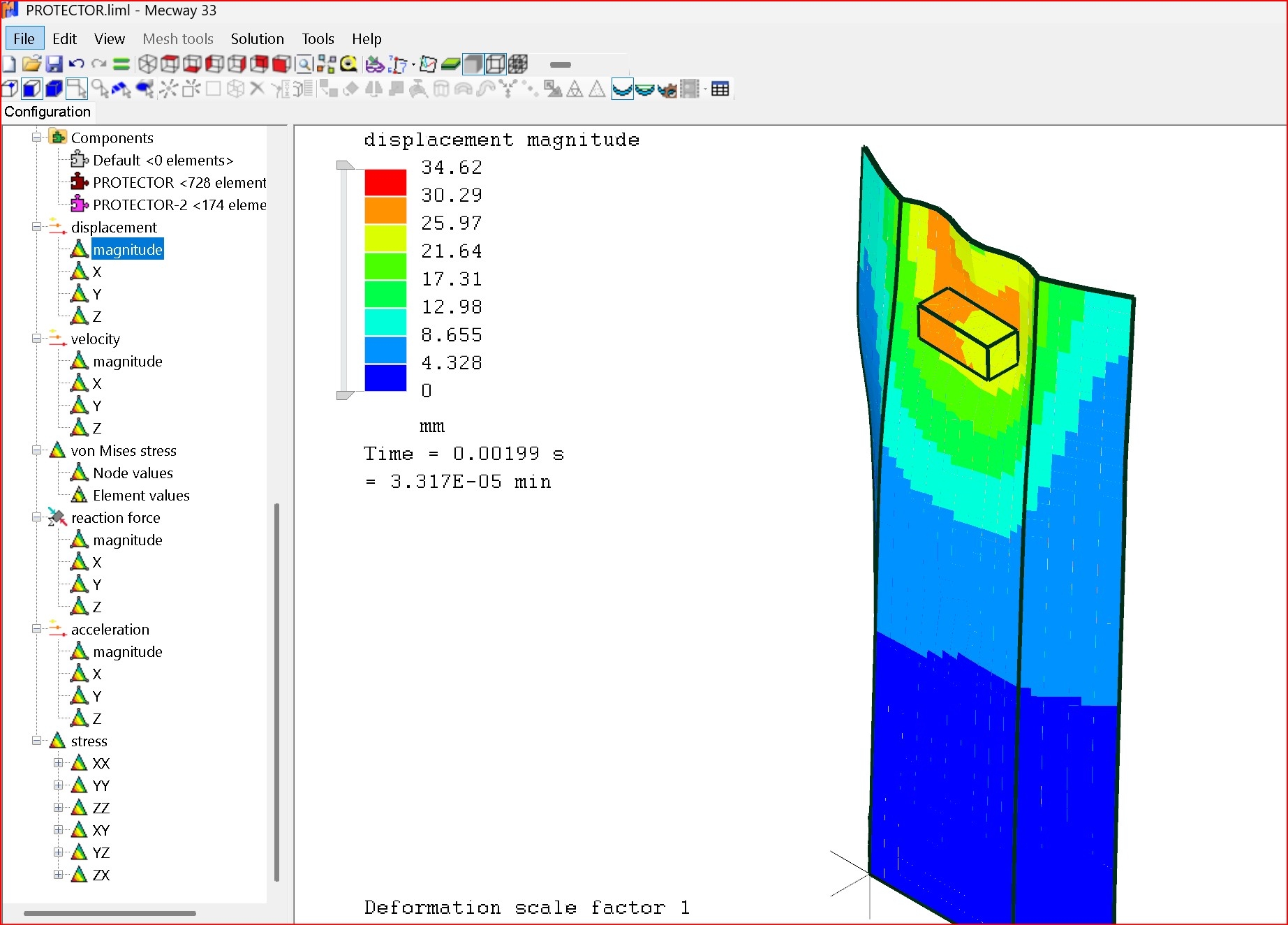

I am doing a very easy model to solve with OpenRadioss. I am on the process of learning this software. I can´t run it buf finally I have mistakes in displacements and velocity. I attach the model, if you can review I will be gratefoul Thanks. JJJ

Hello JJ. The initial velocity is only applied to the surface of one part. The rest of it defaults to zero velocity and that quickly averages out to very slow in the solution.
