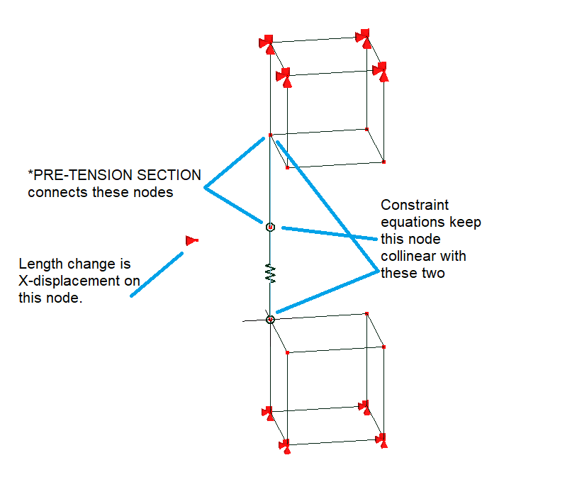

  • My spring is in need of pre-tension, and I am not finding a way to do this. When I have a spring connected to ground, I can "pull" the ground side to put in pre-tension, but if the spring connects two parts, I am out of ideas. Is there a custom model input I can use to get what I need?
  • Hi John,
    Have you tried two springs instead of one and a solid or beam section in between?
    The pretension would be applied to the that mid element.
    This is the idea.
  • edited February 2024
    @JohnM For small displacements, you can use *PRE-TENSION SECTION on a beam in series with the spring but the only way I could find to set it up is quite fiddly, especially if the spring isn't axis-aligned.
    A truss element with thermal strain would be easier if your model allows that.

    Colinearity should be imposed by pairs of nodes on each equation. Writing all nodes in one *equation card isn't enough.
  • Yea, you need 2 equations and if it's at a funny angle, you'd have to do a bit of maths to work them out. Or maybe avoid that by putting *TRANSFORM on the nodes so the DOFs are aligned with the spring. In that case, you might as well write the equations emulating *PRE-TENSION SECTION yourself while you're at it. I think it's basically just ux1-ux2-ux3=0 and ux3=length change.

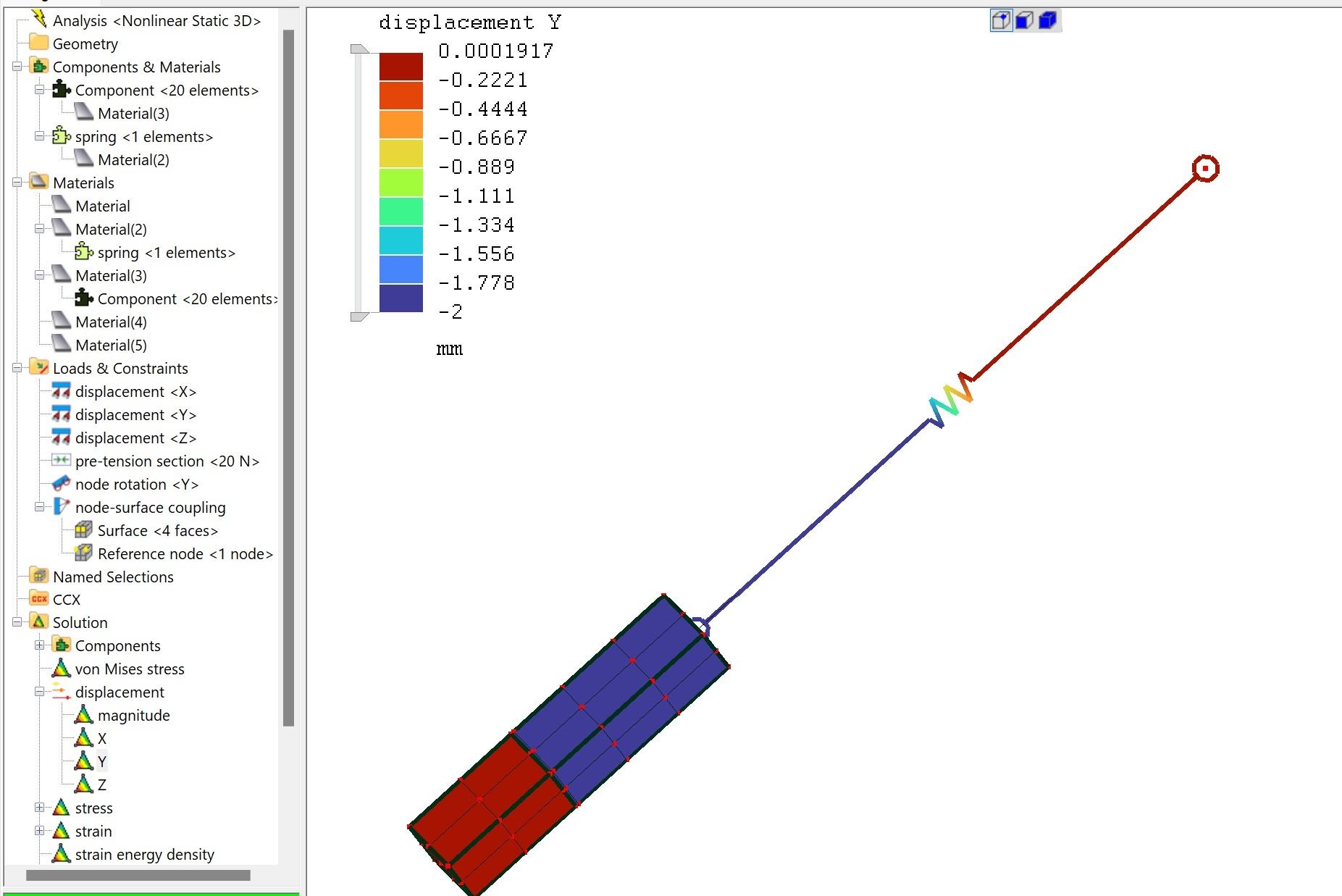

  • i've been using pretension sections as shroud adjusters in yacht rigging models -its a bit of a work up and I imagine it sucks up some computation time but it has appears to work and sort of self aligns also.
  • @fatmac I thought of that exact idea but dismissed it because I thought it was a dumb idea. apparently not! thanks
