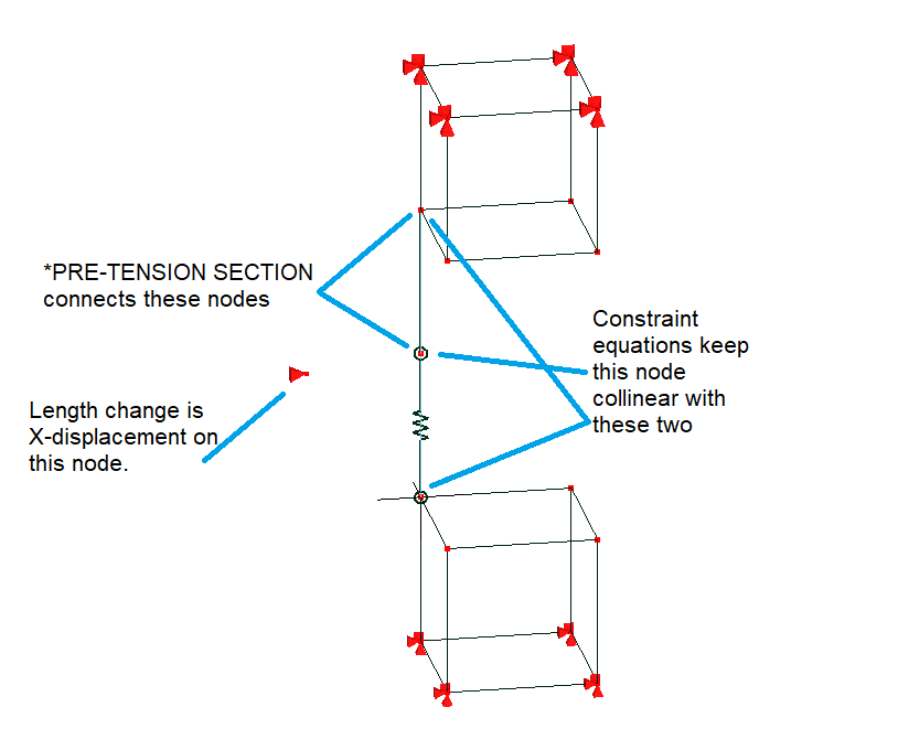

Have you tried two springs instead of one and a solid or beam section in between?
The pretension would be applied to the that mid element.
This is the idea.
A truss element with thermal strain would be easier if your model allows that.
I was setting this up and abondon when realized the amount of equation required.
Colinearity should be imposed by pairs of nodes on each equation. Writing all nodes in one *equation card isn't enough.
