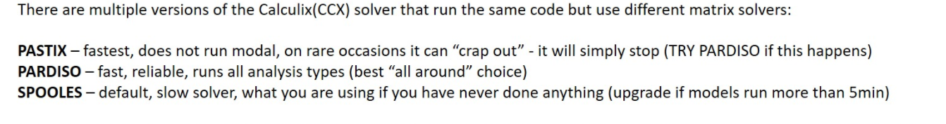

Use the Calculix SOLVER= option to call one of three available solvers:
SPOOLES (This solver requires a lot of memory for large problems)
PARDISO (I generally get the lowest run times by using this solver. It also has the least hardware utilization)
PASTIX (Best multi-core utilization, but not necessarily the fastest option)
Examples; SOLVER=SPOOLES, SOLVER=PARDISO, SOLVER=PASTIX
If the above command is not specified, the ccx_dynamic.exe file uses PASTIX by default.
The run times you get with the solvers seems to depend greatly on the computer hardware you have. For my budget laptop, PARDISO is the fastest solver. It also uses the hardware the most efficiently. Meaning, the power draw is the lowest. PASTIX does a great job using multi-core. However, the run times I get are longer than with PARDISO. Also, it's using the most power. SPOOLES really isn't an option for me, because it can not solve large models with a reasonable amount of RAM.

I've posted the setup quite a few times here and in the Calculix forum. Not sure if it's worth repeating. Victor has a different method. In fact, I think everyone does it slightly differently. So it's hard to answer. It also changes when Intel renames their files.
The last time I tested the Calculix for Windows files, the dynamic version was running slightly faster than the static version. The person who created the files was surprised by that. I run the ccx_dynamic.exe file. It runs Pastix by default now. So I have to manually force Pardiso. I prefer to stick with Pardiso. To run that, you have to get all the files from the Intel oneAPI distribution. I'm not sure what the current version of Calculix for Windows is doing. I would have to download it and see. The version I downloaded was when 2.19 first came out.
