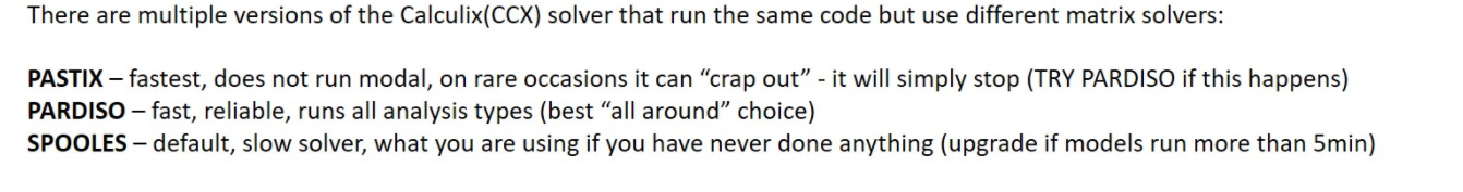

Use the Calculix SOLVER= option to call one of three available solvers:
SPOOLES (This solver requires a lot of memory for large problems)
PARDISO (I generally get the lowest run times by using this solver. It also has the least hardware utilization)
PASTIX (Best multi-core utilization, but not necessarily the fastest option)
Examples; SOLVER=SPOOLES, SOLVER=PARDISO, SOLVER=PASTIX
If the above command is not specified, the ccx_dynamic.exe file uses PASTIX by default.
The run times you get with the solvers seems to depend greatly on the computer hardware you have. For my budget laptop, PARDISO is the fastest solver. It also uses the hardware the most efficiently. Meaning, the power draw is the lowest. PASTIX does a great job using multi-core. However, the run times I get are longer than with PARDISO. Also, it's using the most power. SPOOLES really isn't an option for me, because it can not solve large models with a reasonable amount of RAM.
