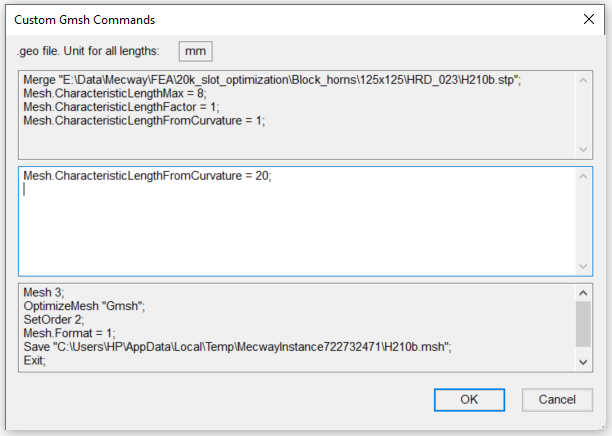

Using Mecway's GUI to gmsh (not the stand-alone gmsh), I have the following custom gmsh commands --
![](https://mecway.com/forum/uploads/editor/v9/j043puynb5dn.png)
A list of gmsh meshing options is here (
http://www.manpagez.com/info/gmsh/gmsh-2.3.1/gmsh_75.php#SEC75). However, I don't see an option to specify the minimum number elements per edge. Is this not possible?
Also, is there a way for Save msh to default to the current model folder rather than C:\Users\HP\AppData...?
Mecway 16.0
Thanks,
Don C.
It can't save to the current folder but you can configure the temporary folder it creates to be somewhere more convenient by adding this setting to user.config which you're already familiar with (in %localappdata%/Mecway_Limited/...):
