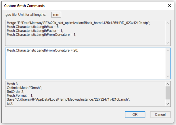

Using Mecway's GUI to gmsh (not the stand-alone gmsh), I have the following custom gmsh commands --
A list of gmsh meshing options is here (http://www.manpagez.com/info/gmsh/gmsh-2.3.1/gmsh_75.php#SEC75). However, I don't see an option to specify the minimum number elements per edge. Is this not possible?

  • I wasn't able to find a setting for min. elements per edge in Gmsh which is why that option isn't available in the GUI.
    It can't save to the current folder but you can configure the temporary folder it creates to be somewhere more convenient by adding this setting to user.config which you're already familiar with (in %localappdata%/Mecway_Limited/...):
                <setting name="TemporaryFolder" serializeAs="String">
                    <value>F:/Mecway_temporary</value>
                </setting>
