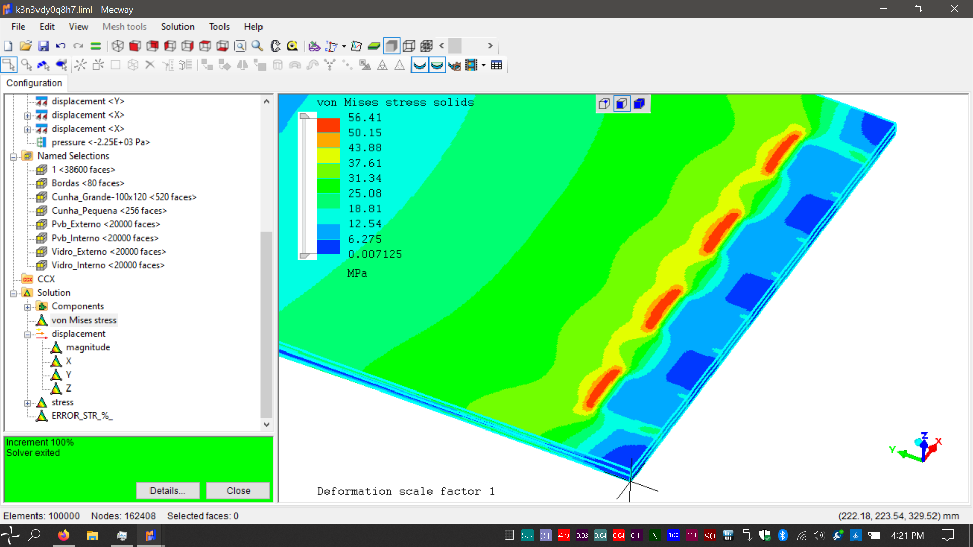

I find it solves with CCX_PARDISO.exe 2.17 dated "niedz., 26 lip 2020 19:57:20" but not with the default CCX.exe 2.17 included with Mecway dated "Wed Jun 16 14:14:29 2021".
using the v2.18 ccx_dynamic.exe file from the ccx website, the pastix solver completed in 4min 35sec, using 3 cores. i have 16gb of memory. the von mises stress is shown below.
keeping the solvers up to date is a moving target. there are several threads on the forum talking about it. everyone's setup is different unfortunately.
It really worked by changing the calculix version as indicated.
as I'm not familiar with programming, I found a compiled version on the calculix forum but not optimized for my PC [since it used only one core], replace it in the mecway folder and everything worked.
link:https://calculix.discourse.group/t/calculix-and-pastix-solver-windows-version/130/22
I will install the libraries and try to better understand how to optimize it.
