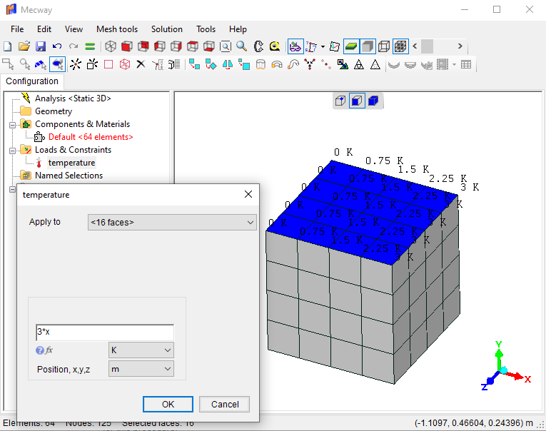

2) Is it possible to apply lineary change tempereture (applied by function ore something like this?). At this moment I try to read node coordinates, order temperature to nodes in excell and put it into 'node temperature' manually.. but in case where I have above 80000 nodes it is a bit difficult...

About temperature - I have a temperature profile defined by function, and I do not need thermal analysis, but I will look into it, maybe it can help me...

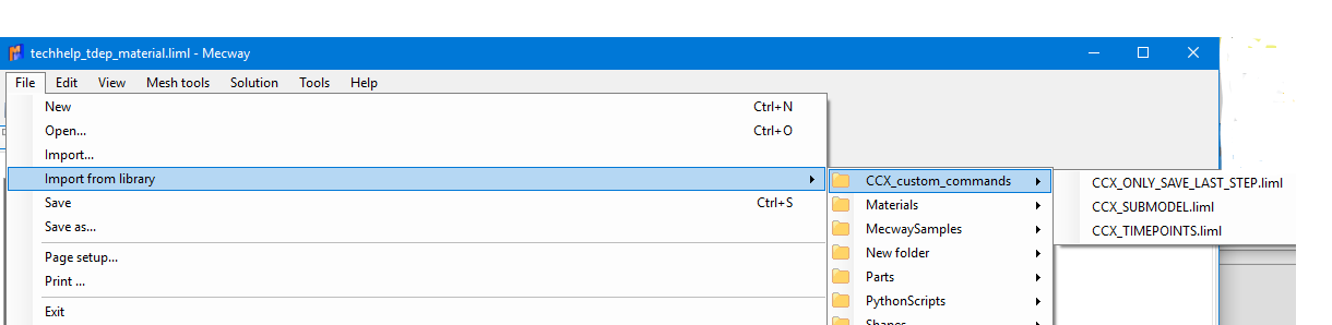

A good way to get smart fast:
1-Run a simple analysis using Mecway with CCX.
2-Look at the CCX input file generated (in this case, the *MATERIAL and *ELASTIC cards)
3-Suppress these commands - "don't generate"
4-Put these commands in a custom model definition
5-Run again, be sure the answers are the same as step 1
6-Swap in the new thing, in this case, temperature dependent properties.
Save your simple example in a library, because you will forget that temperatures need to be specified in K inside CCX (or a million other things you will forget). You can even keep some "helper CCX" input files in a library using the Mecway Library function:
