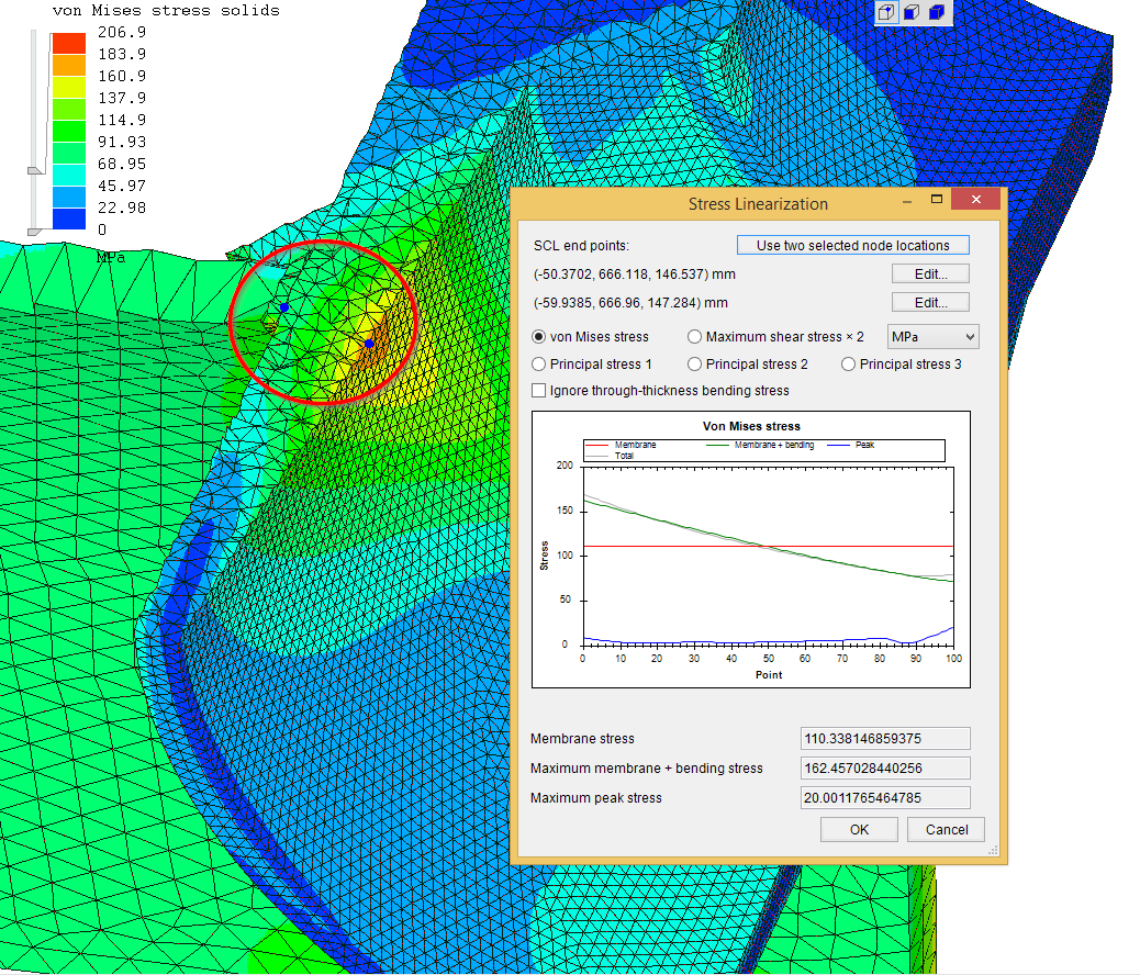

  • I add another, in the Stress Linearization feature, can be the SCL visible when is definied? Now is only visible the nodes, and the line appear when the stress linearization window is closed. Also, when the saved SCL is clicked on the model tree, will be nice that the stress linealization appears again
  • Thanks for the suggestions Clearline and Sergio
    1) Unlikely because of consecutive node numbering which makes this tricky.
    2) No. Although you can get it to save the solution to a separate file with Analysis -> New save after solve.
    3) I'm expecting to have either named loads or named load groups or both for the next version (14).
    I'll see about having the SCL appear when it's defined before closing the window. It should already appear when you click on it on the outline tree.

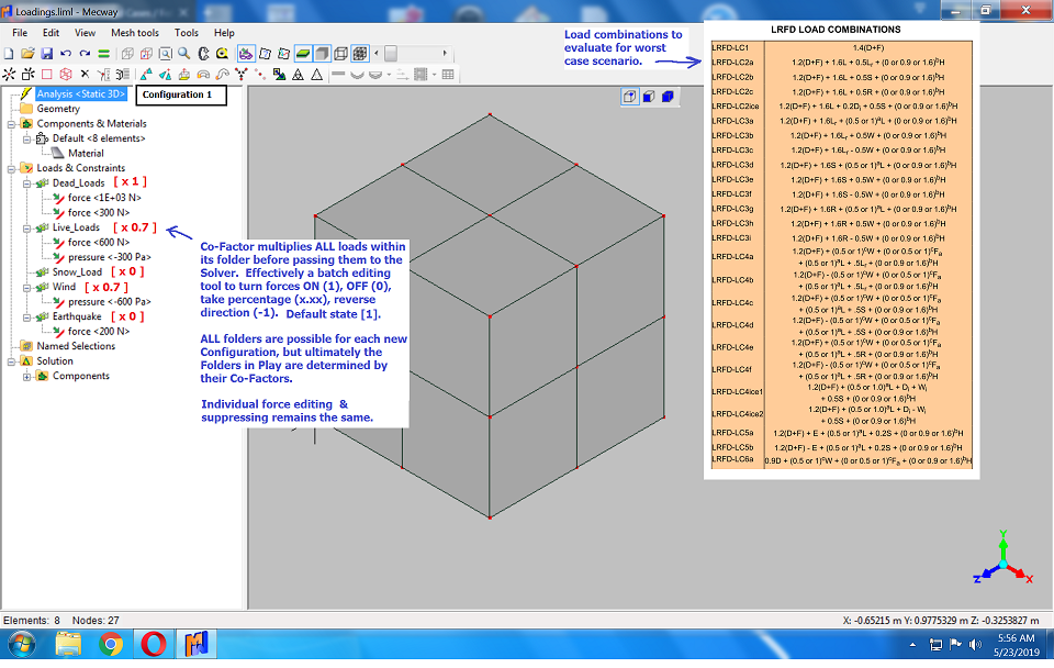

  • @Victor,
    If the named load groups (folders) is still in the works for ver. 14, I'm wondering if the needle has moved yet for adding a multiplier (Co-Factor) outside of the group? This multiplier would apply to all the loads within the group, and would save a LOT of editing time in multi-force models that currently requires the Edit of each individual load. The hope is this could be done within the user interface, without resorting to batch editing external to Mecway.
    I resurrect a previous screen-shot from LISA (showing the folders) that I made comments on. One sympathizes with Engineers for all the various load cases that must be investigated under the International Building Code.
    Finally, a word of appreciation for all the improvements made to date and the helpful advice given.

  • Named loads - yes
    Multiplicative constants - probably but it might be in the form of constants you can include in load formulas and not quite as visual as what's shown on your screenshot.
    Load groups - maybe

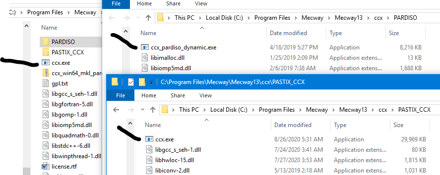

  • There are now several solvers available for CCX (standard, paradiso, pastix...), would it be a big issue to make it possible to have a selection between some solvers.
    Tools-->Options-->Calculix--> [ ] Solver(1) e.g. CCX_2.17
    [*] Solver(2) e.g. ccx_paradiso_2.17
    [ ] Solver(3) e.g. CCX_2.16
    Makes it a bit easier to switch if neccessary. Just for information, to think over.
  • Leave SPOOLES, PARDISO and PASTIX installation in the ccx directory, and it is a trivial matter to switch the link in the Tools-> Options->Calculix menu.
    FYI, PASTIX has failed on me for thermals involving pipe flow elements, and has diverged for nonlinear contact models with hyperelastic elements. PARDISO ran slower, but it converged. I leave all 3 available, and since the *SUBMODEL command was fixed in 2.16, have not had to go back to SPOOLES.

  • edited December 2020
    You only need one ccx.exe file, but linked to these 3 solvers and run it with the command (in the .inp file):
    *STATIC,SOLVER=SPOOLES
    *STATIC,SOLVER=PARDISO
    *STATIC,SOLVER=PaStiX
    for (from ccx 2.17 manual):
    *BUCKLE, *COUPLED TEMPERATURE-DISPLACEMENT, *DYNAMIC, *ELECTROMAGNETICS, *FREQUENCY, *GREEN, *HEAT TRANSFER, *MODAL DYNAMIC, *STATIC, *STEADY STATE DYNAMICS, *UNCOUPLED TEMPERATURE-DISPLACEMENT,
  • @3rav this is interesting because it means the solver type can go with the model, which is handy for us. I understand how to set the *STATIC command, but how do I have a single ccx.exe and 3 links?
  • You can dowload ccx from (CalculiX forum: https://calculix.discourse.group/t/calculix-and-pastix-solver-windows-version/130/16?u=rafal.brzegowy)
    https://www.dropbox.com/s/zd7fj0ceaj8j44n/CalculiX.7z?dl=0
    This archive contains the ccx version linked to SPOOLES, PARADISO and PASTIX
    (ccx_PASTIXandPARDISO.exe).
  • Thank You for sharing!

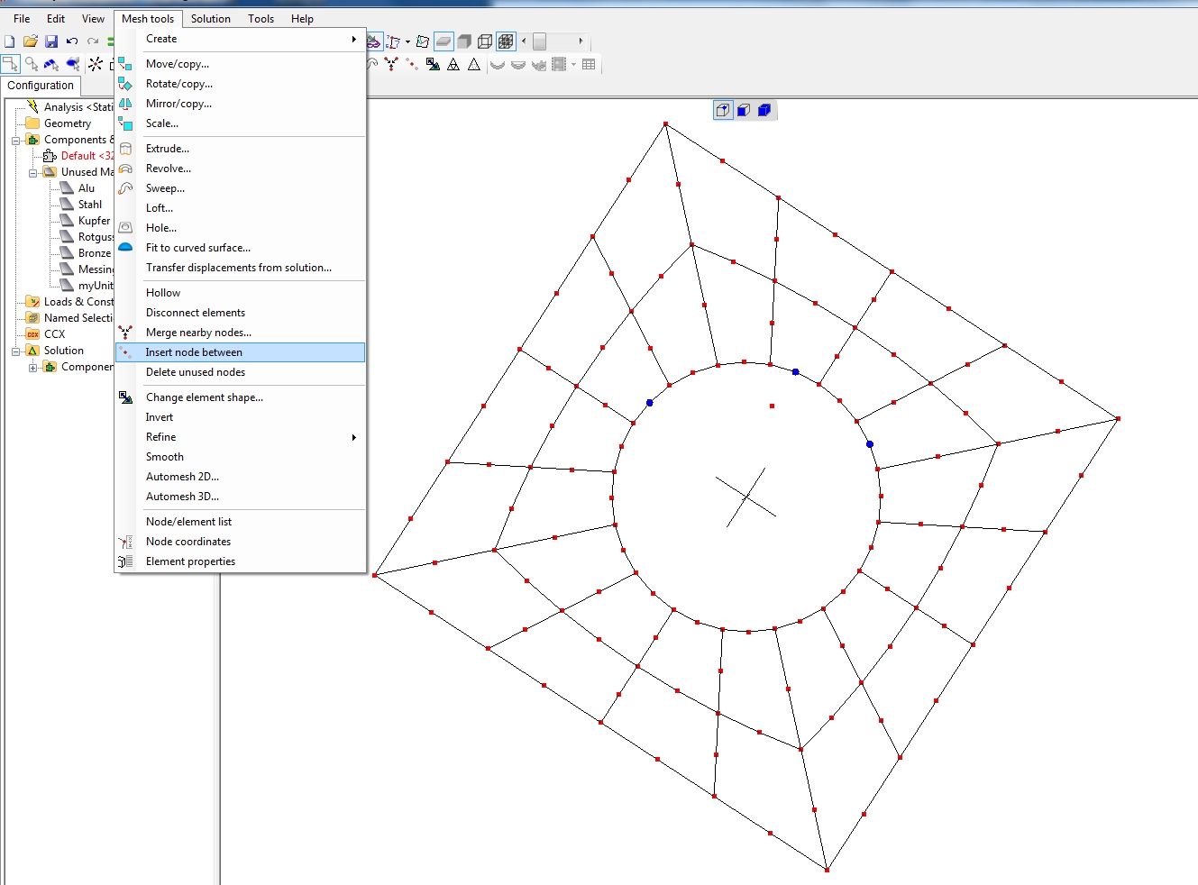

  • I was just playing around with Mesh tools → Insert node
    between to create a node at the centroid of the selected nodes.
    It would be nice if that could also be used to set a node on the center of a circle. At time it doesn't do.
    Is a nice to have function, but may sometimes help
  • You should be able to make a function for putting a node in the center of a circle using the Python API. I don't know the math of it, but the structure of the script could look like this:
