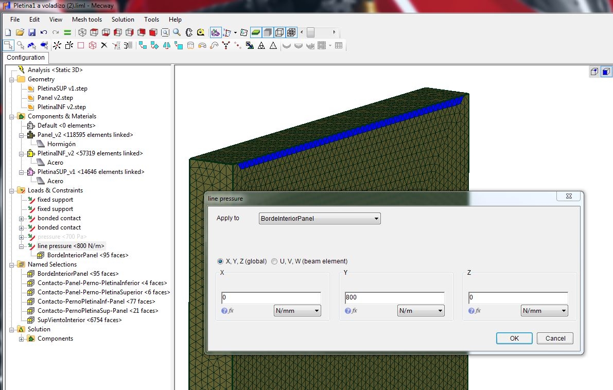

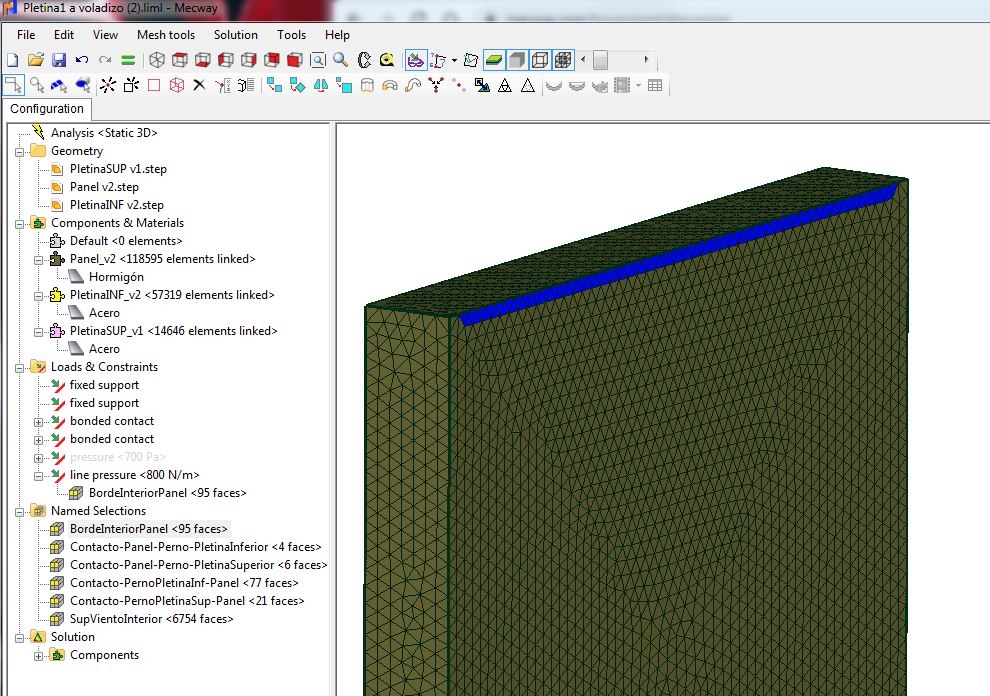

Hi.
I'm introducing a line pressure on a set of faces selection.
But it don't shows in "loads and Constraints" view.
What am I doing wrong?
Best regards.
168.6K
151.9K
May 2020
The
line pressure
load is only for 1D "faces" which are edges of beam and shell elements. You can use
pressure
force
instead and scale the value by the width or length of the strip respectively.
