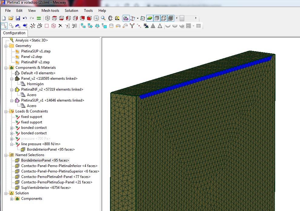

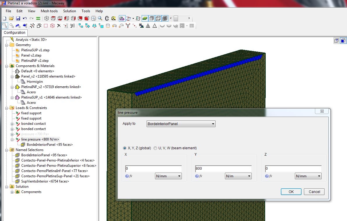

I'm introducing a line pressure on a set of faces selection.
But it don't shows in "loads and Constraints" view.
What am I doing wrong?
Best regards.
  • The line pressure load is only for 1D "faces" which are edges of beam and shell elements. You can use pressure or force instead and scale the value by the width or length of the strip respectively.
