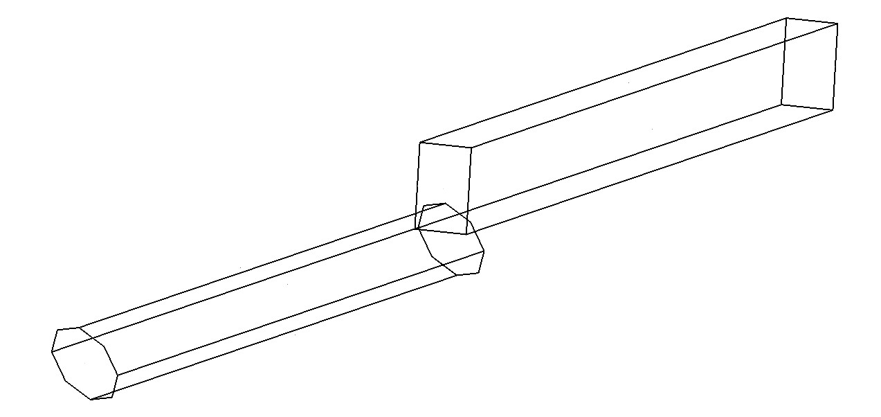

I think that isn't possible. I never use this kind of elements B31 - B32 but from CCX manual the nodes that define the beam are expanded into 8 nodes elements. So you can obtain rectangular section and elliptical section. This automatic nodes generation can't generate hollow sections. To be sure of this you could post on Calculix group.
nicely Dhondt has Civil Engineering backgrounds, he provides very useful command to build an arbitrary section for straight (B31) or curved (B32) beams. these methods more like 1D fiber beam element in other FE software. i'm being study and compare the differences for each methods.
previously i can built rectangular hollow (boxed) section and many other shapes, yes it's look possible too for circular hollow section shapes. can be more complex shapes as you can imagine.

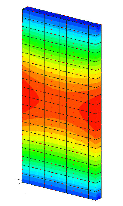

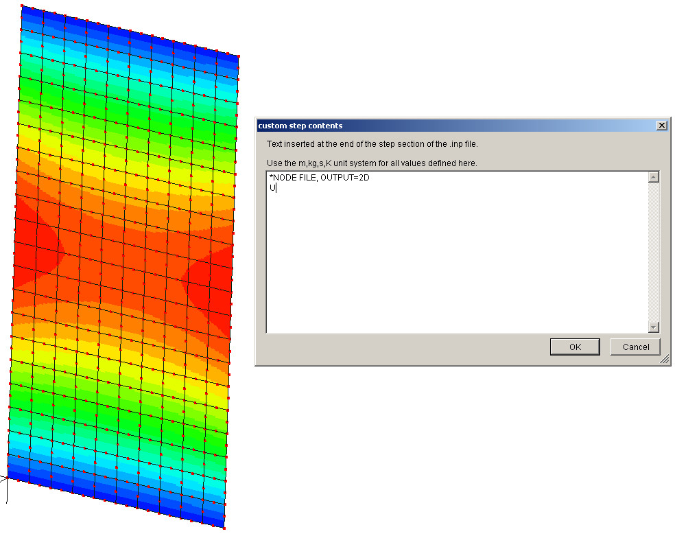

To avoid inappropriate 3D view you can add OUTPUT=2D as a parameter of *NODE FILE.
This option could be usefull also on Mecway but I didn't find nothing into CCX options.
In fact also for shell elements 2D view instead 3D view could be desiderable
