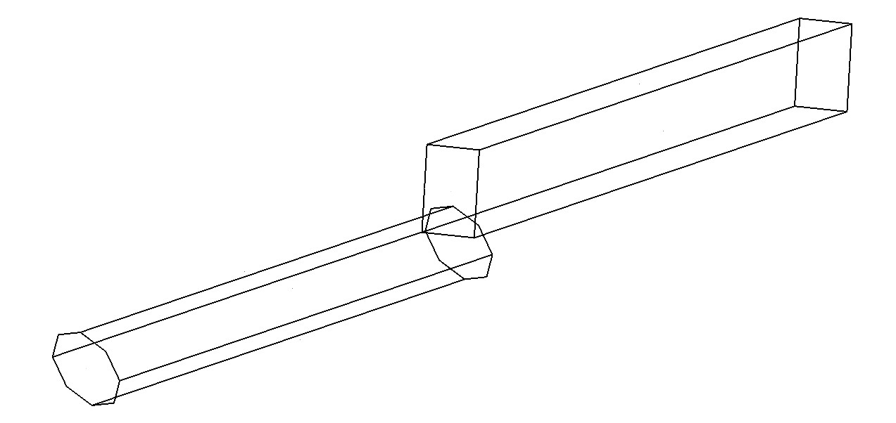

  • Hi Victor, thanks for the example. Ugly thing is that at postproceesing the tubes are showed as square sections :-(
  • Because is a square section. Reading CCX Manual is possible to understand that:
    The actual cross section is taken into account by appropriate placement of the integration points.
    So the calculus  is based on the correction of the position of the integration points.

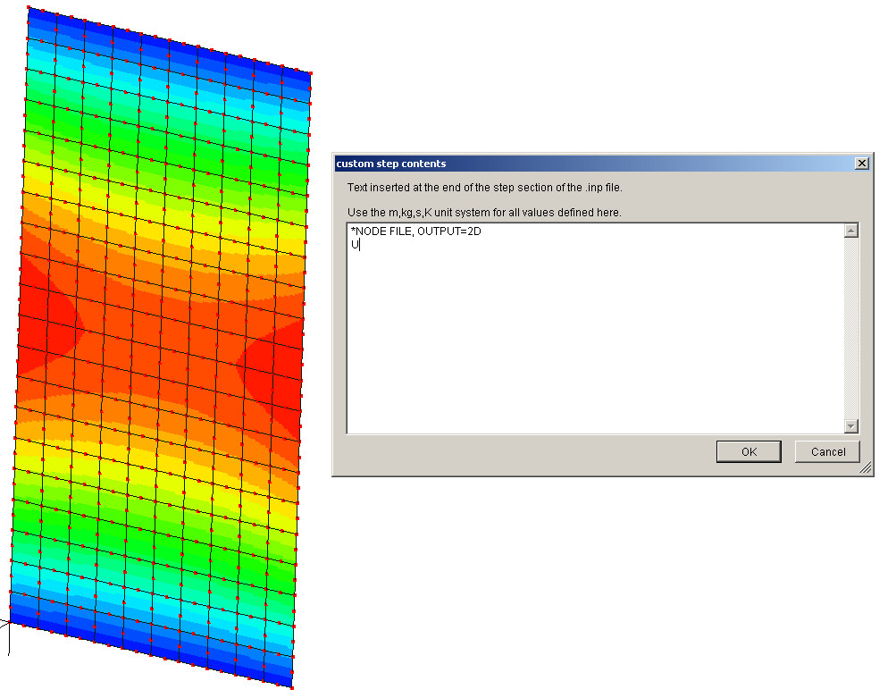

    To avoid inappropriate  3D view you can add OUTPUT=2D as a parameter of *NODE FILE.
    This option could be usefull also on Mecway but I didn't find nothing into CCX options.
    In fact also for shell elements 2D view instead 3D view could be desiderable

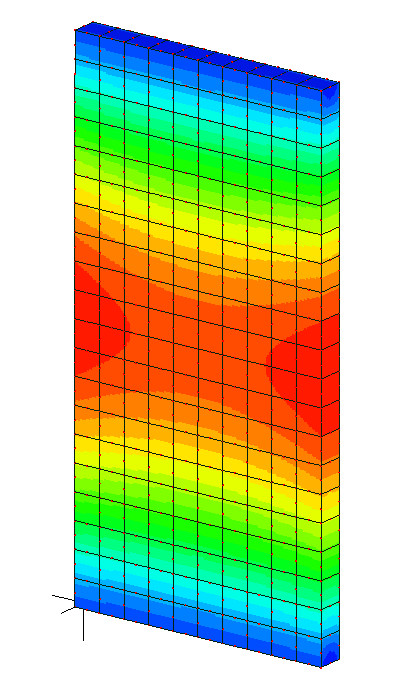

    That's are the things that make's me escape from shell elements while I can, not only in CCX/Mecway but any other solver. For 3D solid modeling guys as me there are severals things to take in mind to don't make mistakes (orientation, sides, conectivity keeping the thikness...and after postprocessing, upper side, lower side...). Have desing a lot of sheet metal parts, small parts (automotive, but not the big panels), and we always work with solid meshes obtained from extrusions of 2D meshes to avoid this mistakes.
  • Take care with OUTPUT=2D on beams. It used to have a bug that caused the stresses to be wrong. Not sure if it still does.
  • As I wrote I never used 1D elements on CCX but reading the manual:
    The displacements are best obtained in the non-expanded view, i.e. using the
    OUTPUT=2D option. This means that for the present results the example
    had to be run twice: once with the OUTPUT=3D option and once with the
    SECTION FORCES option.
