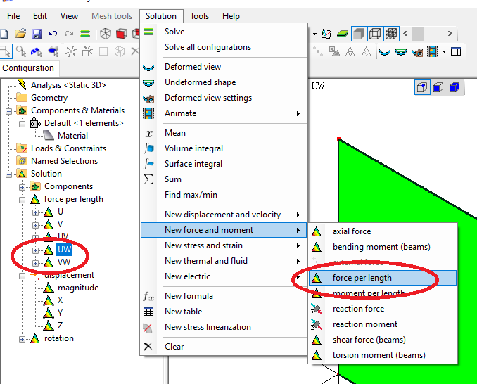

I can't find the new feature shown on the labs menu as " Shell shear force per unit length".
I have been searching inside the solution tree but i can't find it.
¿Does anyone know where to find it?
May 2021
It's part of
force per length
but beware that it can have huge errors. Sometimes averaging the values on adjacent nodes corrects that.
