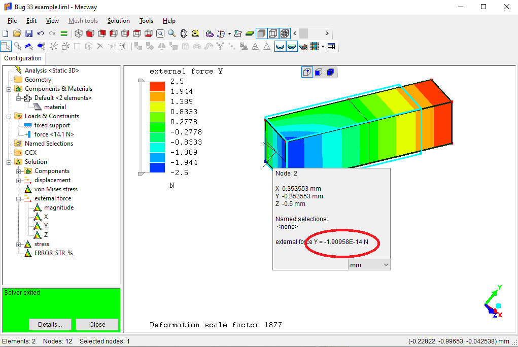

Bug with external force on CCX beams
Bug 33 here https://mecway.com/product.html#bugs
Using rotational DOF constraints sometimes causes components of the external force at some nodes to be zero. Here's an example. The external force Y component should be -2.5 N on each of the 4 expanded constrained nodes, but it's zero on two of them.
