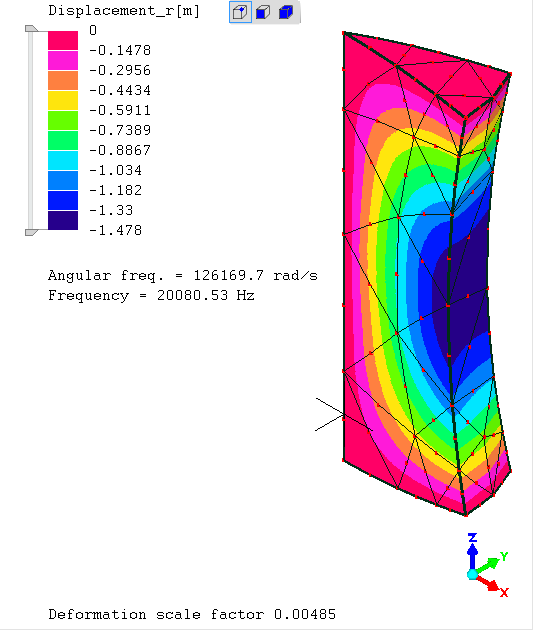

In DisplacementCylindrical.liml the equation for Displacement_r (the radial displacement) is ( x*u.x + y*u.y ) / sqrt(x^2+y^2). However, this causes a problem when a node is located on the Z-axis where both x and y are 0 --> then the denominator = 0 so the overall value is undefined. When clicking on a Z-axis node using Displacement_r, the result is NaN whereas the result should be 0 when the lateral faces have frictionless constraints. As a result, the plot of Displacement_r is corrupted (see image "Mecway - modal radial displacements 1a").

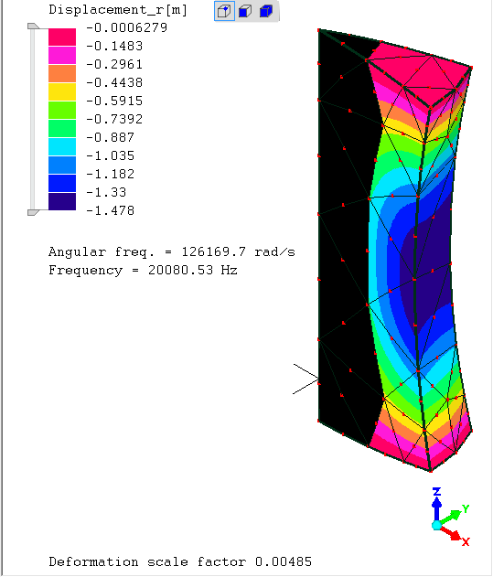

The way I have found around this is to add a small, insignificant value (1e-10) to the denominator to prevent it from going to 0 -- i.e. , Displacement_r = ( x*u.x + y*u.y ) / (sqrt(x^2+y^2) + 1e-10). Then the results are correct (see image "Mecway - modal radial displacements 2a").
