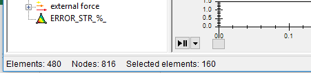

  • One simple way is to look in the tree at the component created. Also, there is a running tab at the bottom, with the third entry being whatever is currently selected:
  • It seems the first 2 fields give the total for all components. Is there a way to find the number of nodes for an individual component?
  • Click on part in tree, that selects elements.
    Click the node icon at the top of the view port, that selects the nodes attached to those elements - the selected nodes will be shown at bottom
