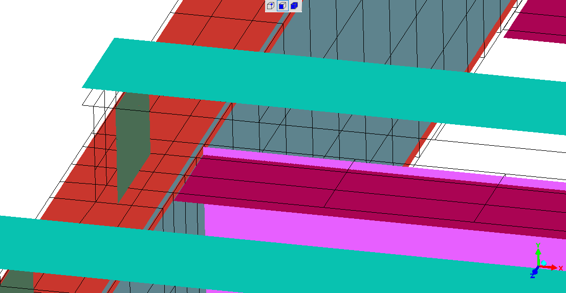

Hi, is there a way to view a shell model with element faces activated, but removing the defined shell offset from display? It´s make hard to check for node conectivity the ghost surface.

No, sorry. Other than zero the offset for all elements then undo or open a saved copy to reinstate them.
