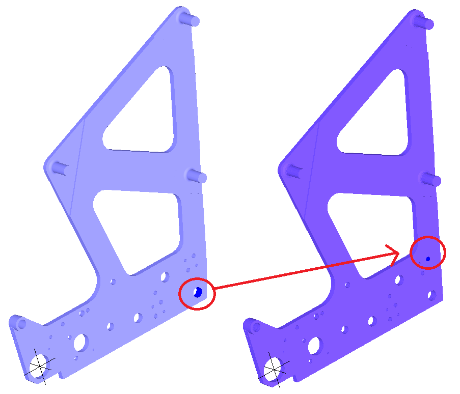

When I assign a constraint from the geometry, it sometimes assigns the constraint to the wrong geometry...
In the case I'm trying to work on right now, I'm trying to add a pinned support constraint to the surface selected on the first picture, but it always apply the constraint to the surface selected on the 2nd image....
I have attached step file and liml file.
Strangely though, I read it in/out of a CAD package and it "fixed" the issue.
I imported the step file created by solidworks to Freecad and generated a new step using freecad and everything was fine then...
don't know if it is caused by Solidworks or Mecway, but for sure there is something weird that sometimes happens there... It is not the first time that I have this issue...
