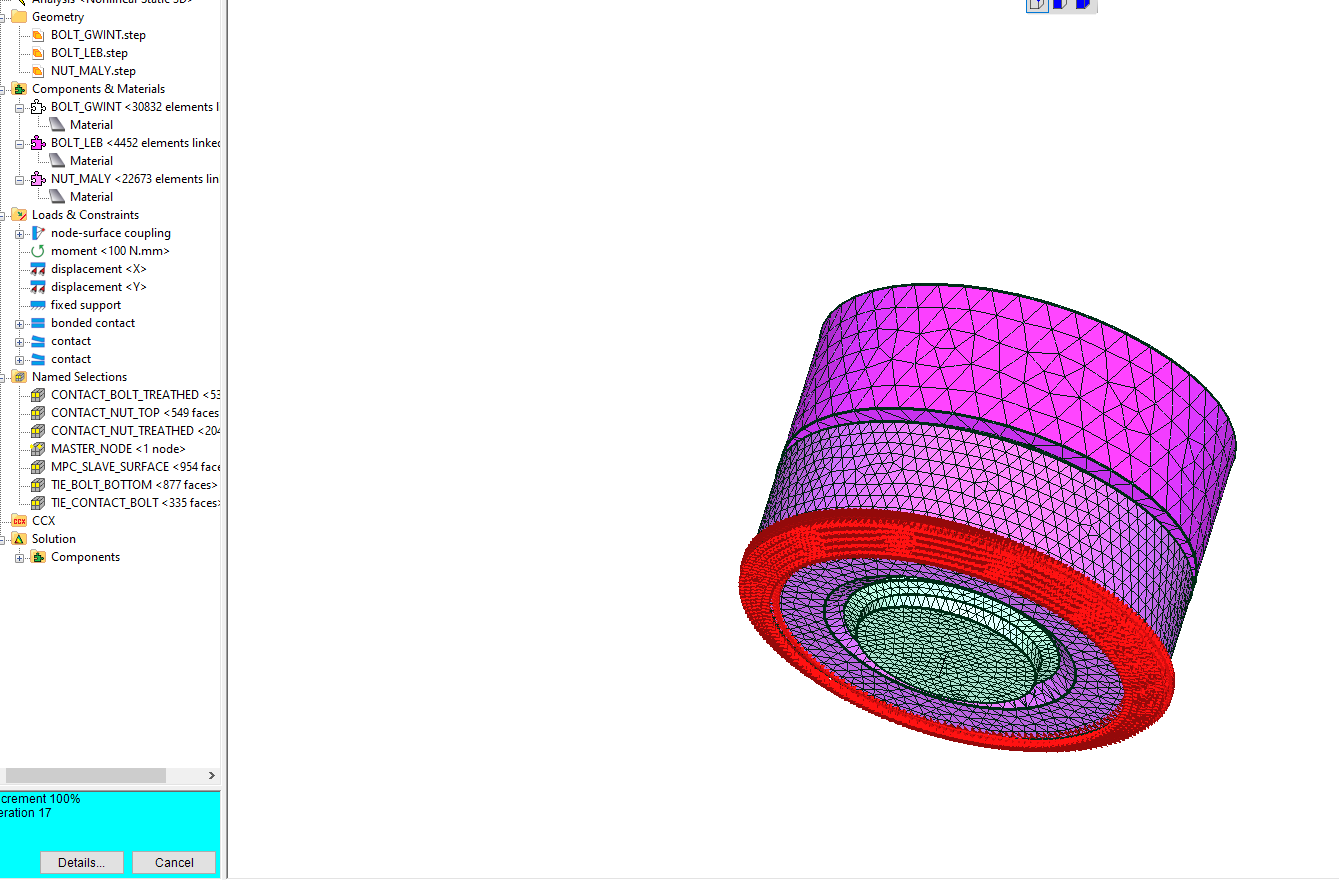

I have model as below:
Elements: 57957 TET elements
Nodes: 93673
This is analysis in CCX with contact.

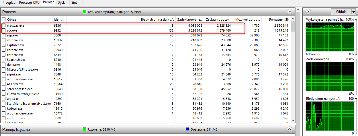

My question is: How tandem CCX and MecWay use/divided memory for calculation?
At the print screen is marked in red two values.
CCX use some memory and MecWay use some memory.
All is used in the calculations?
Another thing that's likely happening here is Mecway has a problem of wasting memory as you use it. I think it's caused by the undo history which keeps as copy of the entire model every time you make any changes and that can grow to several GB. Re-opening the file should clear that. The reduced memory use may not appear in task manager straight away.
Thank you.
I thinking in the same way. I found that the MecWay ceep memory during work and add more in each operation.
I planed to ask as a next question about run without GUI, but You give the answer befor qestion I write;).
