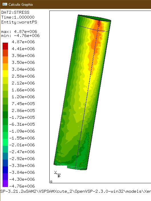

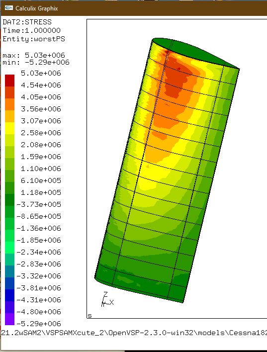

In a cgx display of semi-monocoque wing forces, since the skins must be unloading stresses to the ribs (and thence to the spars), one would expect that those stresses would take a discontinuous jump along the wing skins at the junctures of the ribs (and of course not to do so with a pure monocoque wing without ribs.)
But in the ccx+cgx calculation/display of a simple wing drawn and meshed in OpenVSP, the stress (Worst PS or Mises or Tresca) there's no great difference between the semi-monocoque and pure monocoque cases, even at high G-loads. See attached (semi-monocoque first image, monocoque second).
But since you're here, a couple of general ideas to bear in mind:
A solution that looks continuous is consistent with a discontinuous one for small enough discontinuities. If you estimate the expected difference in stress on either side of a rib, you'll know if you can expect it to be visible on the plot or buried in discretization error.
The .frd file format (and CGX, think) can't represent discontinuous stress in a connected mesh because it only stores values at the nodes and discontinuities get averaged out. So you may need a finer mesh to see them.
Any ideas?
