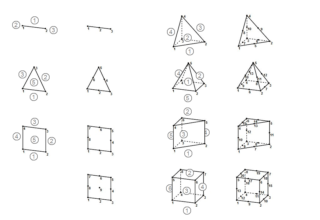

What I want to get is the thickness of the shell for any quad4, quad 8...etc using the existing API commands. Currently I am stuck at 'mw.surface_area(face_id)' command. I can get the ID of any element as an input data and it works in order to get the mass and volume of any finite element based on its element number, but I get an error for the 'FaceID'.
Based on Victor's API Reference, the FaceID is 'The area of the element face'. Also, FaceID is defined as command: FaceId(element_id, face_number), having the element ID and the face_number. Based on the attached file, the Face ID for all elements is: faceid="5".

mw.surface_area(FaceId(1,5))You could get FaceId using
mw.selected_faces()if you've already selected it manually before running the script.Face numbers are the circled numbers shown in the attached picture as well as 6 for the opposite face of shells.
'The area of the element face' refers to the value returned by the function, not the FaceId parameter.
Thank you for the Element Shape pictures, that makes it easier to understand how it works.
