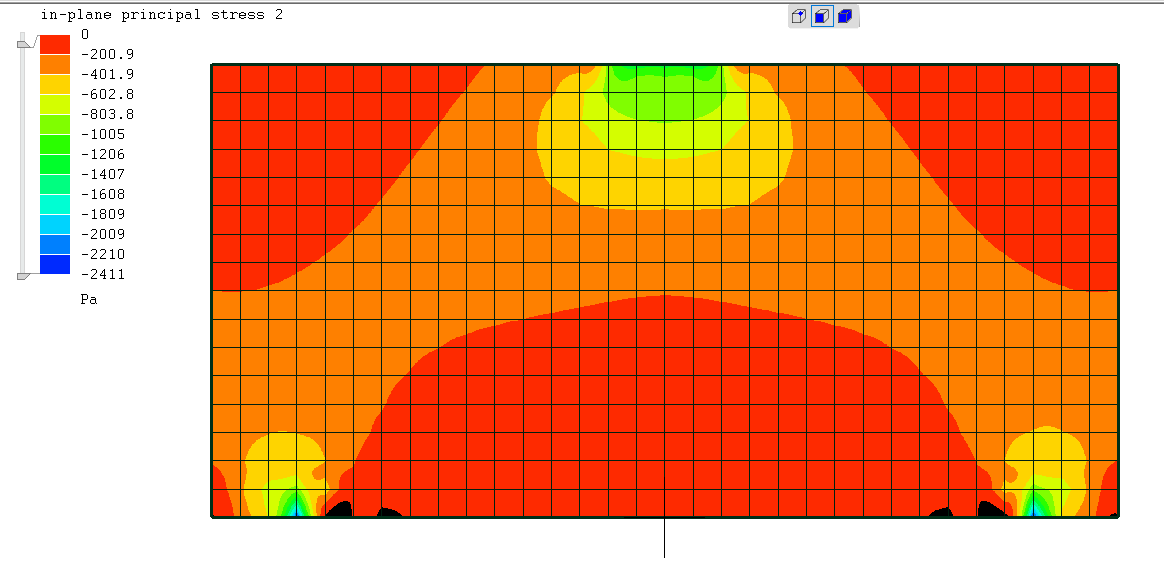

I've modeled a simple wall element (using shell elements), supported at the bottom ends & with a point load at the top in the middle, as shown below:
The results are as one would expect, with compression struts forming in between the load and the supports, as shown below.

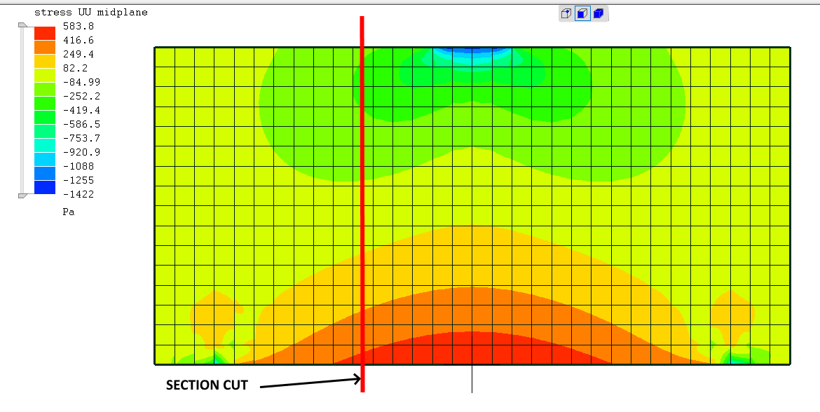

My question is, how do you find the resultant of forces at a certain cross section cut? Ideally, this would be for the total effects from all the stresses. But I could also work with it if it was split up by the different local direction, for example below, showing stress in the UU direction.

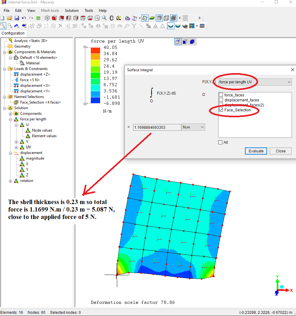

    1. Create a face selection for the internal faces along the section cut, which has to be aligned with element boundaries.
    2. Solve
    3. Add Solution -> New force and moment -> force per length
    4. Use Solution -> Surface integral to integrate the force per length components over the face selection.
    Here's an example where we expect the internal force to be 5 N in the U direction and 3 N in the V direction. Obtain them by integrating force per length UV and force per length V respectively.
    You could probably use stress in element coordinates instead of force per length and skip a couple of steps.
