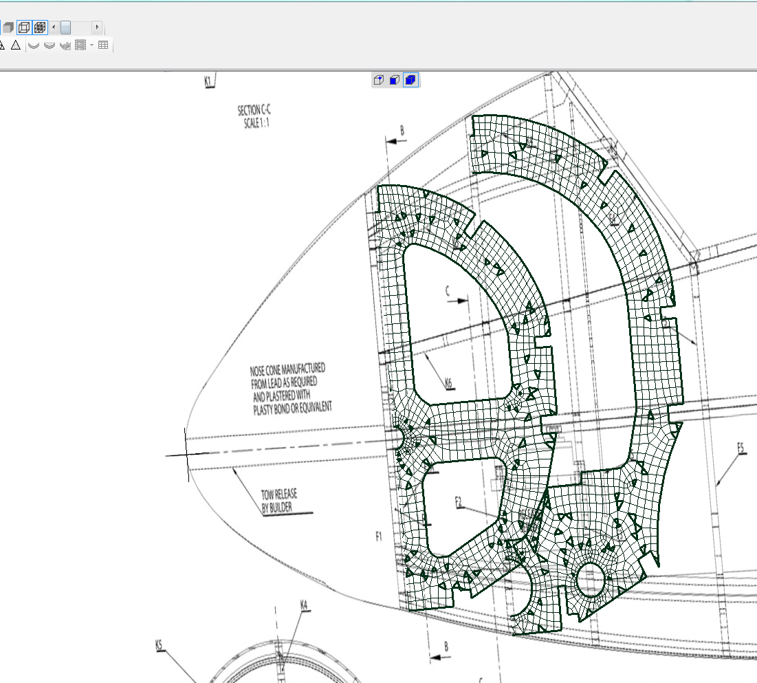

Is there an easy way to save nodes and line elements from Mecway as a dxf?
I am doing the FEA on a balsa model fuselage (ASK-18 Balsa model glider) and later would like to send dxf files to a laser cutter.
As you can see I am using Mecway to build the model by clicking on nodes and then making 2d meshes of the fuselage formers. It would be nice if I can save the fuselage former 2d meshes as a dxf somehow.
I hoped GMSH could do it directly but it can't.
Any ideas?
<img
Watch out for all those little thick edged triangles. They indicate boundaries between tri6 and quad8 where the midside nodes aren't connected. That's probably a consequence of a bug with some of the meshing options which is fixed in Mecway 13. Use Merge nearby nodes to join them properly.
Also thanks for the suggestion/warning on the tri6. Problem solved:)
Much appreciated
