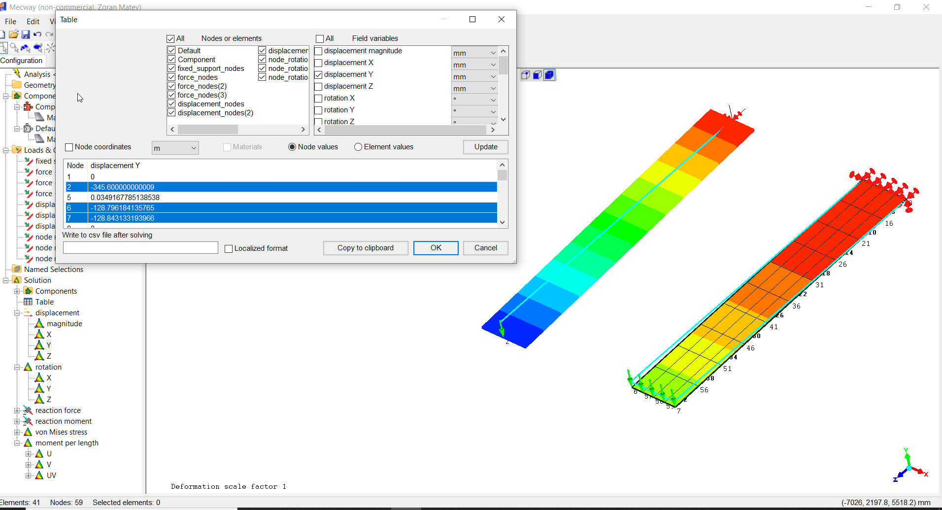

Dear,
Please see the snapshot below, could you please assist to clarify why there are discrepancies in deflection between the element beam and the shell beam.

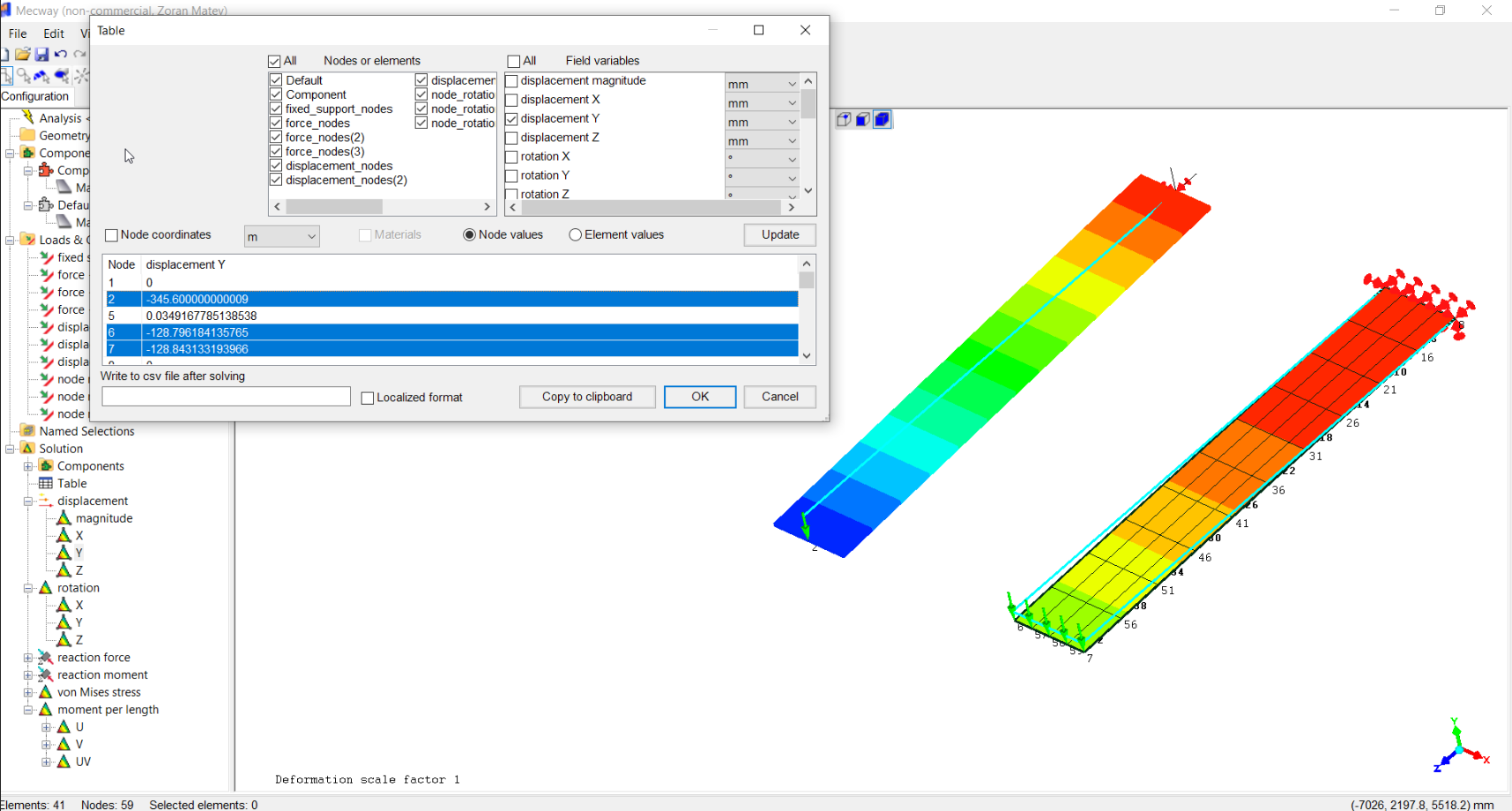

  • Dear Viktor,
    Kindly note that I have changed the elements to quad8 and I am still getting the same deflection on the shell beam.
    Refer to the attached file.

  • The load is only 4.0 kN on the shell because the value you specify in a force item is its total force, not force per node. If it's applied to multiple nodes, it gets distributed equally between them.
    You can also save some effort manually specifying the special end node forces if you use the edge "face" instead of nodes, as shown in this attachment.
