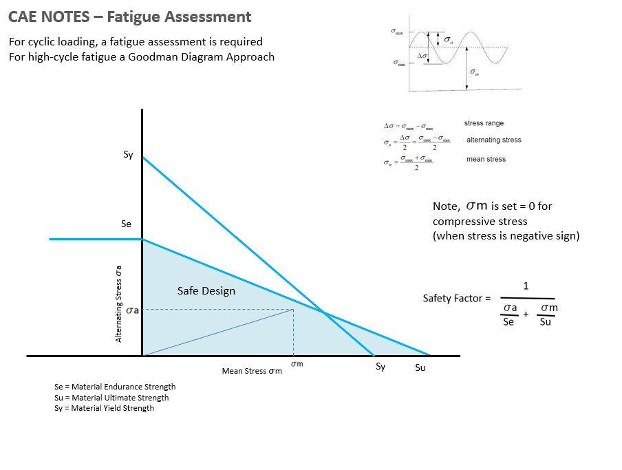

We use Mecway to perform basic fatigue analysis. The slide and notes attached shows the basic idea for high-cycle fatigue for typical engineering materials. I don't expect this to be the "lock" on how to do this, but it is a good start.

Now that you have Sa and Sm, you simply apply the formula in the graphic:
SF= 1/(Sa/Se+Sm/Su)
where Se is Endurance Strength Su is Ultimate Strength
(if Sm is negative it is set to zero)
SF= 1/(Sa/Se+Sm/Su)
where
