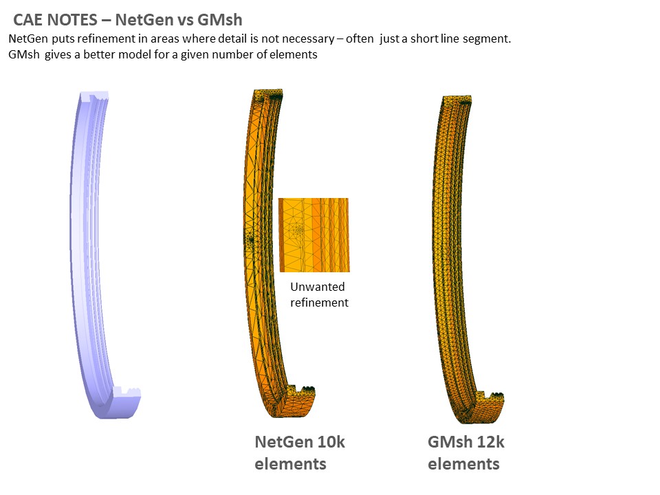

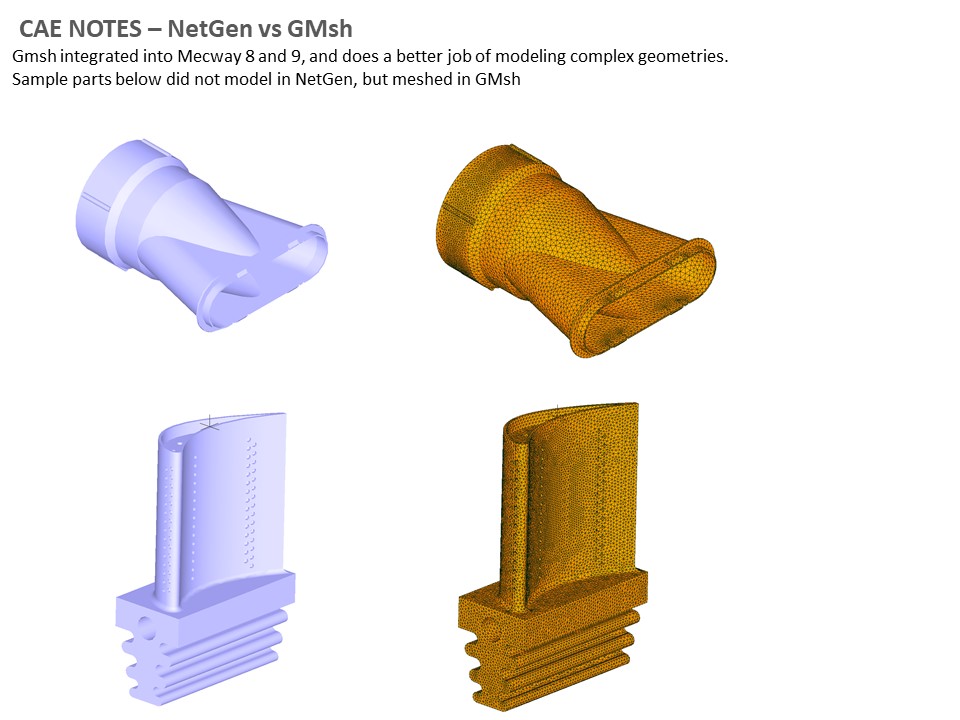

    I have heard your exact comments from other forum users, that's why I started this thread! Here are two slides from some old group notes using GrabCAD examples. It would be great to understand what I don't know about Netgen.
    I have found Salome to be bloated(GBs to install!) and a bit crashy. Whenever I see YouTube examples, they take 20minutes/many steps to do something I can do much more easily with internal options. Again, it would be great to understand what I am missing!

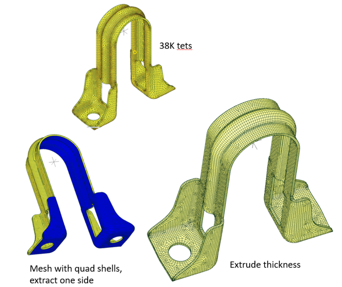

    MESHING STAMPINGS/SHEET METAL
    Parts with a single thickness (like sheet metal) can be meshed with hex solids by first meshing quad shells, selecting one surface, and extruding through thickness. These models are usually smaller and better quality. Example below: 38K tets, 22K hex

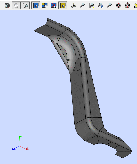

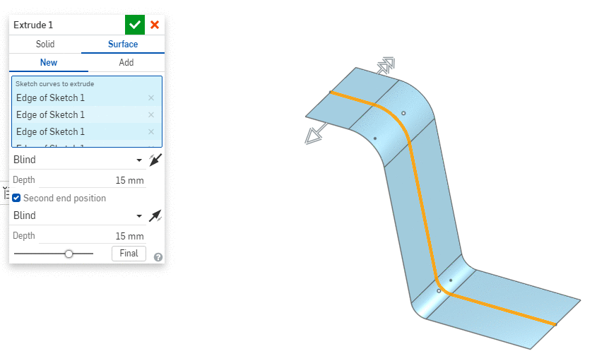

  • Hi, just to revive this thread, attached is an example of the secuency of modeling (with OnShape) and meshing (using Salome) with quads and then extruded to get hexas of a bracket made in steel sheet, very similar to the one of @JohnM . It takes a little of planning before start to meshing in order to identify and divide the surfaces in mapped masheables areas (this work I made in the available CAD program as is always ahead of Salome usability). The results are high quality meshes with accurate representation of small radius (very often free quad mesh fails to follow small radius in case of using big or medium size elements), but with very reduced (and exactly controlled) quantity of nodes/elements, ideal for plastic/contact analysis.

    Well, there are a lot of steps to get the mesh
    1) Be carefull while modeling, keep radius constant and realistics, better to model as surface and then add the thikness to check that also the mesh could be extruded
    2) In CAD add extra face divisions to get mapeable surfaces (four sides) were is needed
    3) When the part is imported in Salome, first extract (Explode) all the surfaces of one side of the part, and after extract all the edges of this surfaces (yep, a lot of Explode operations)
    4) For meshin faces with four sides, i found that the algorithm "Quadrangle: Medial Axis Projection" is the most that I use. I have found that sometimes for curved sides the node distribution is not 100% equidistant, so I made a submesh for forcing this equidistant distribution (and be able to combine with the adjacent face)
    5) Is possible to combine (adding a 1D submesh with algorithm Composite Side Discretization) some sides of a surface to get a mapeable one, like in the main vertical surface of the example
    6) Be prepared to go back to CAD and add new divisions as you found at the middle or finishing that you cannot follow without that.
    Best regards, and have a nice (mapped) meshing weekend!

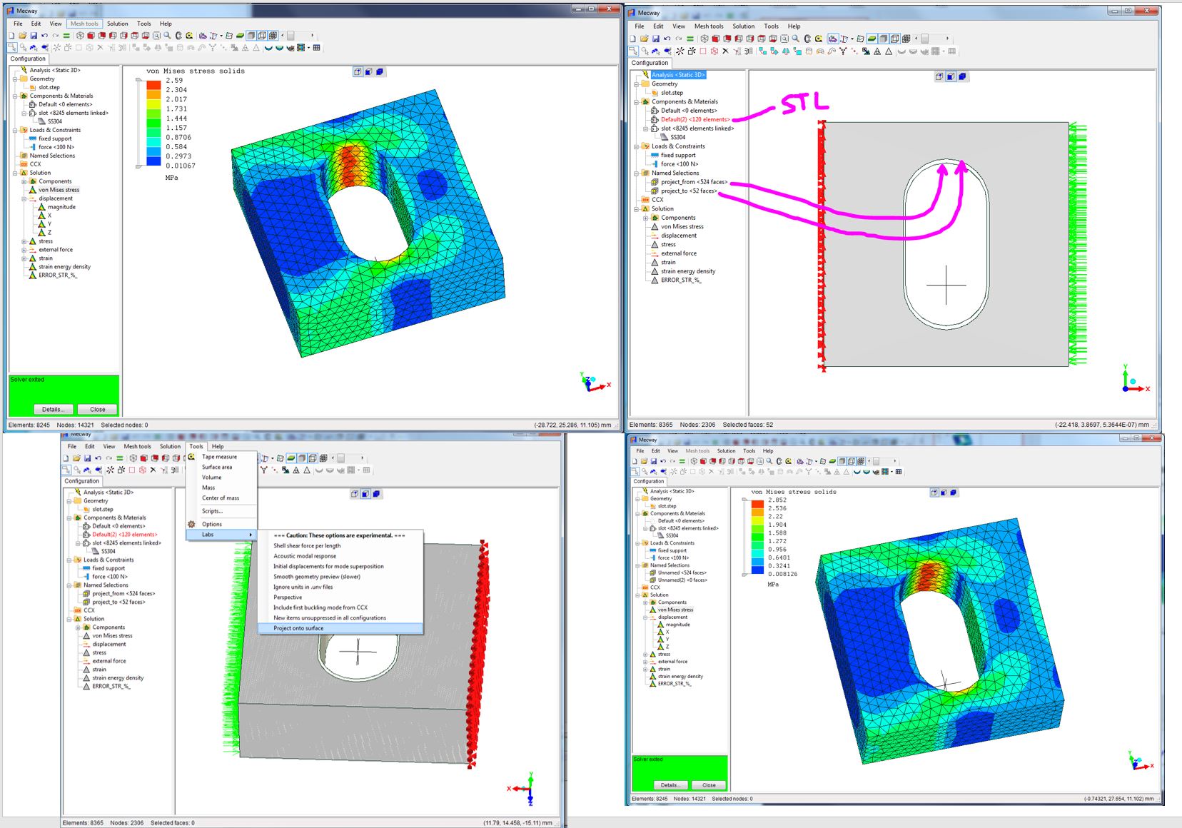

    Victor has put a Lab in place at 13.1 that I am finding very useful.
    Often we have a model "all set up" and then we want to look at the effect of tolerance or what impact a small modification might make. In these cases, try this:
    1- Read in STL shells of the modified geometry
    2- Select project_from and project_to surfaces
    3- Use Lab feature "Project onto surface"
    4- Delete STL, run model
    This can make quick work out of subtle changes without the need to re-mesh and set up boundary conditions. It is advisable to temporarily switch projecting elements to lower order, and then switch back after projection, but this goes quickly.

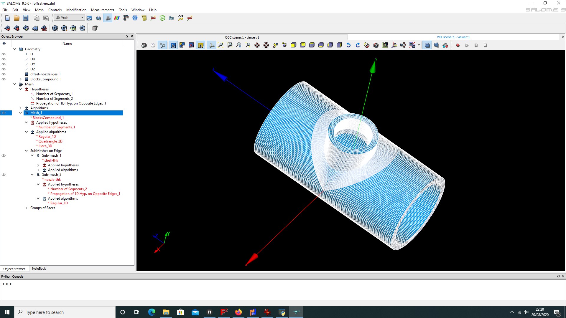

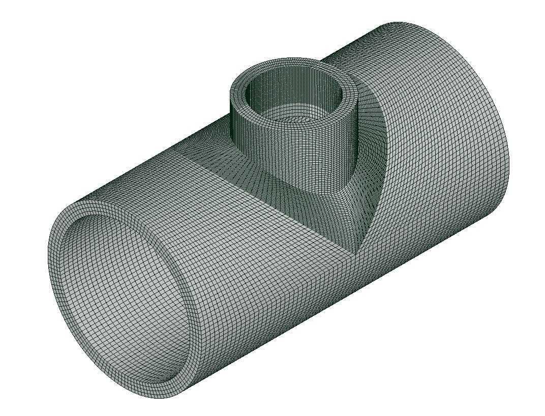

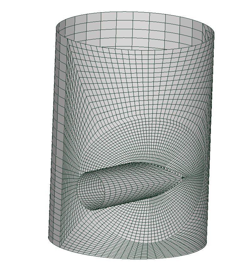

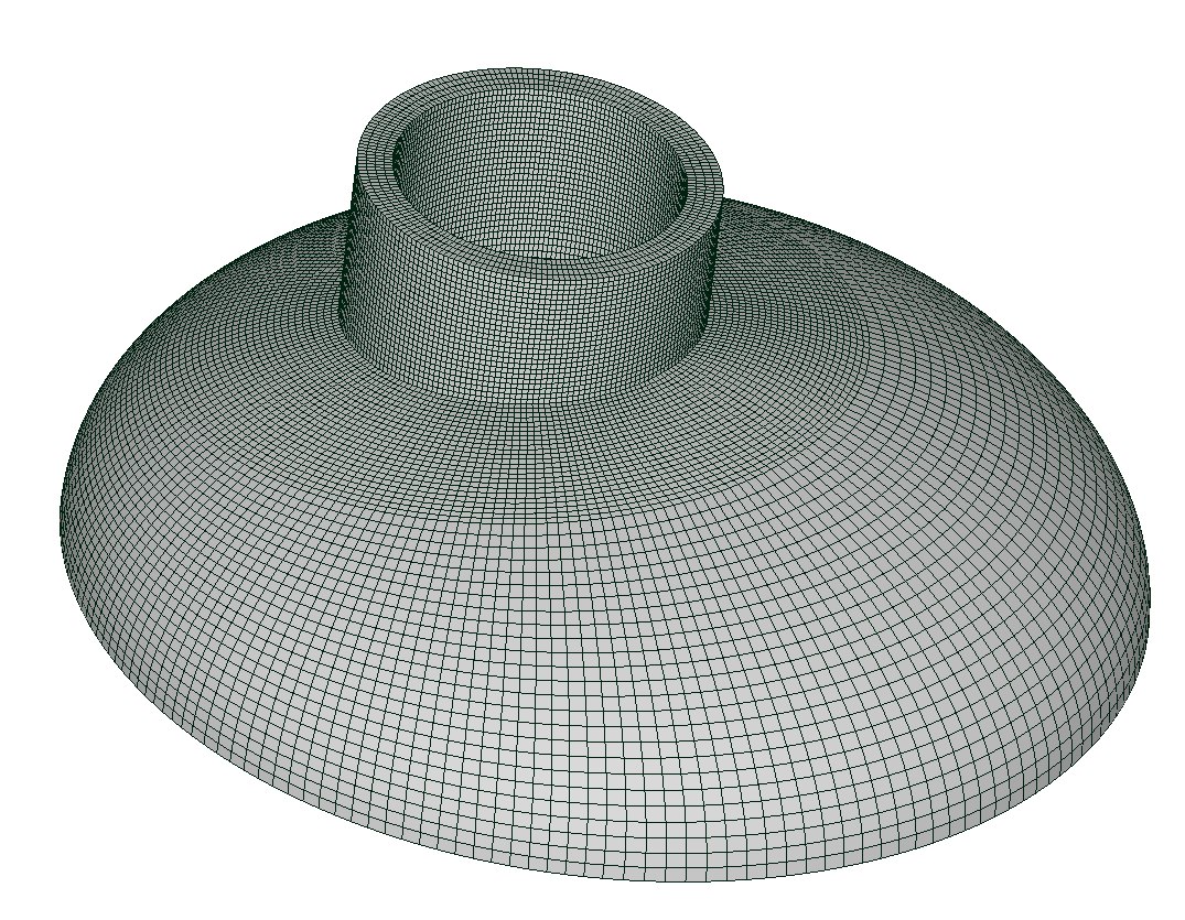

  • Freecad & Salome hexa meshes
    hopefully this may be of use to some people
    I've been trying to produce hexa meshes for vessel nozzles & finally got good results
    modelled and split in freecad fixed, if required, in salome then meshed in salome
    geometry split into 4 sided areas (plus inside & outside surfaces)
    then meshed 3d hexa, 2d quadrangle mapping, 1 d wire No of segments
    sub mesh using a wire the thickness of the item No of segments (4 in the examples) plus
    additional hypothesis propogation on opposite edges
    examples are split cylinder + nozzle, split head + nozzle & tangential nozzle (this only shell elements)
    I include salome tree showing typical meshing technique
    imported into mecway as UNVs.
    let me know if freecad or step fles are helpfull
