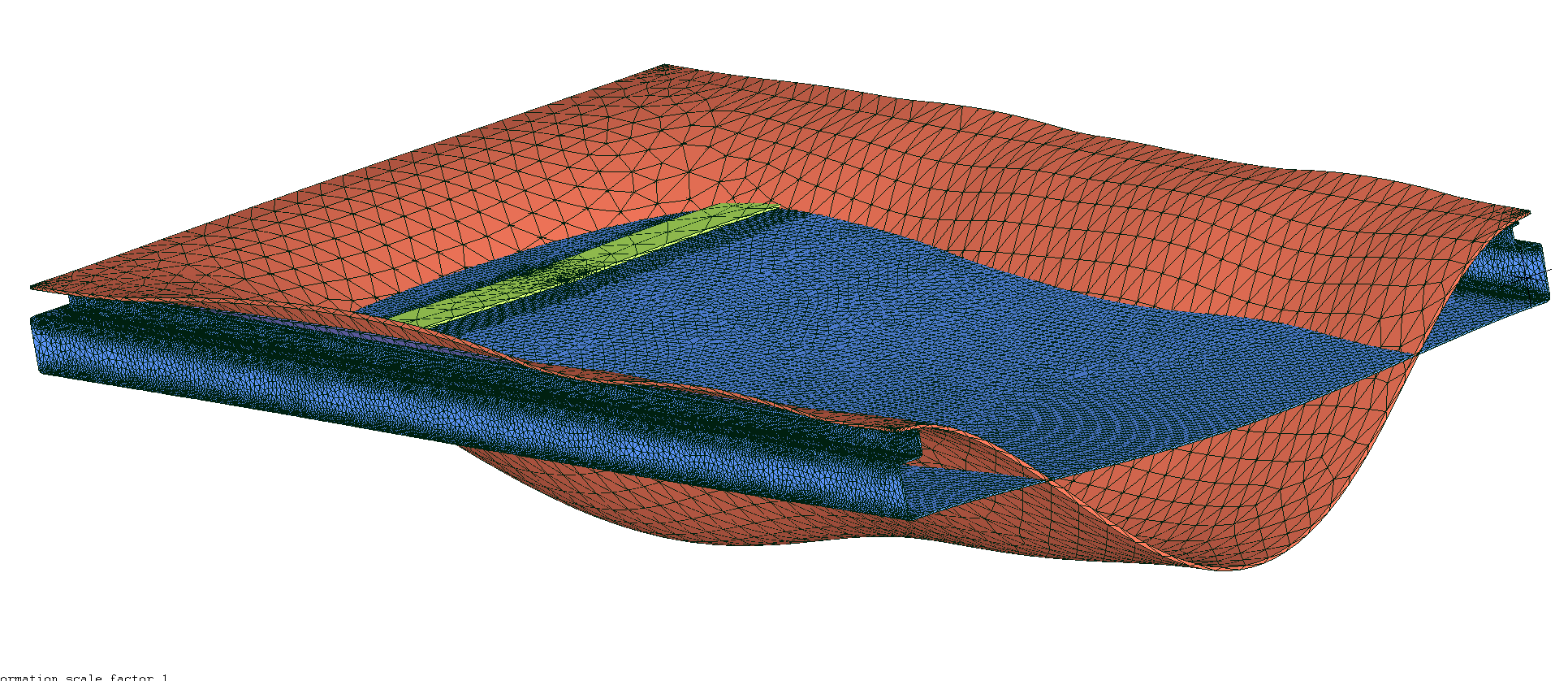

  • In the above picture blue is bonded to purple (gasket) which is bonded to orange (Acrylic lens)which overhangs the gasket by a good bit. Looks like it only attaches at a few select points.

    When bonded contact is just hanging on by a few points, it's probably because the master and slave surfaces are the wrong way around. Here, it looks like the blue part has a finer mesh than the purple gasket, so the blue should be the slave. Similarly, the orange lens has a coarser mesh so it should be a master.
    Reason is that the bonded contact is between slave nodes projected onto master faces.

  • I made the gasket mesh quite fine and the orange lens mesh a bit finer as well. I also made sure the coarser orange lens was the master. Now the bonds look solid in linear mode. I am currently running in non-linear without the c3d errors. Thank you all for the help.
