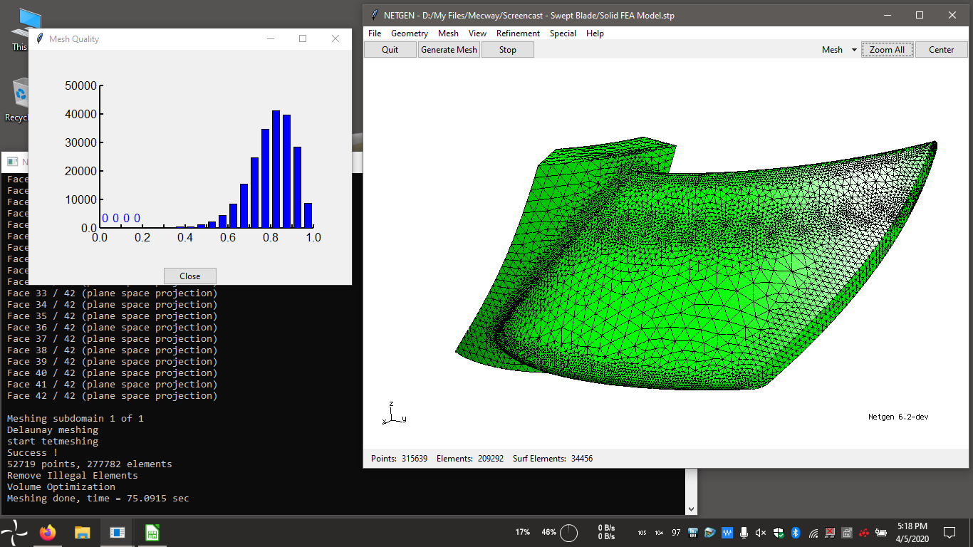

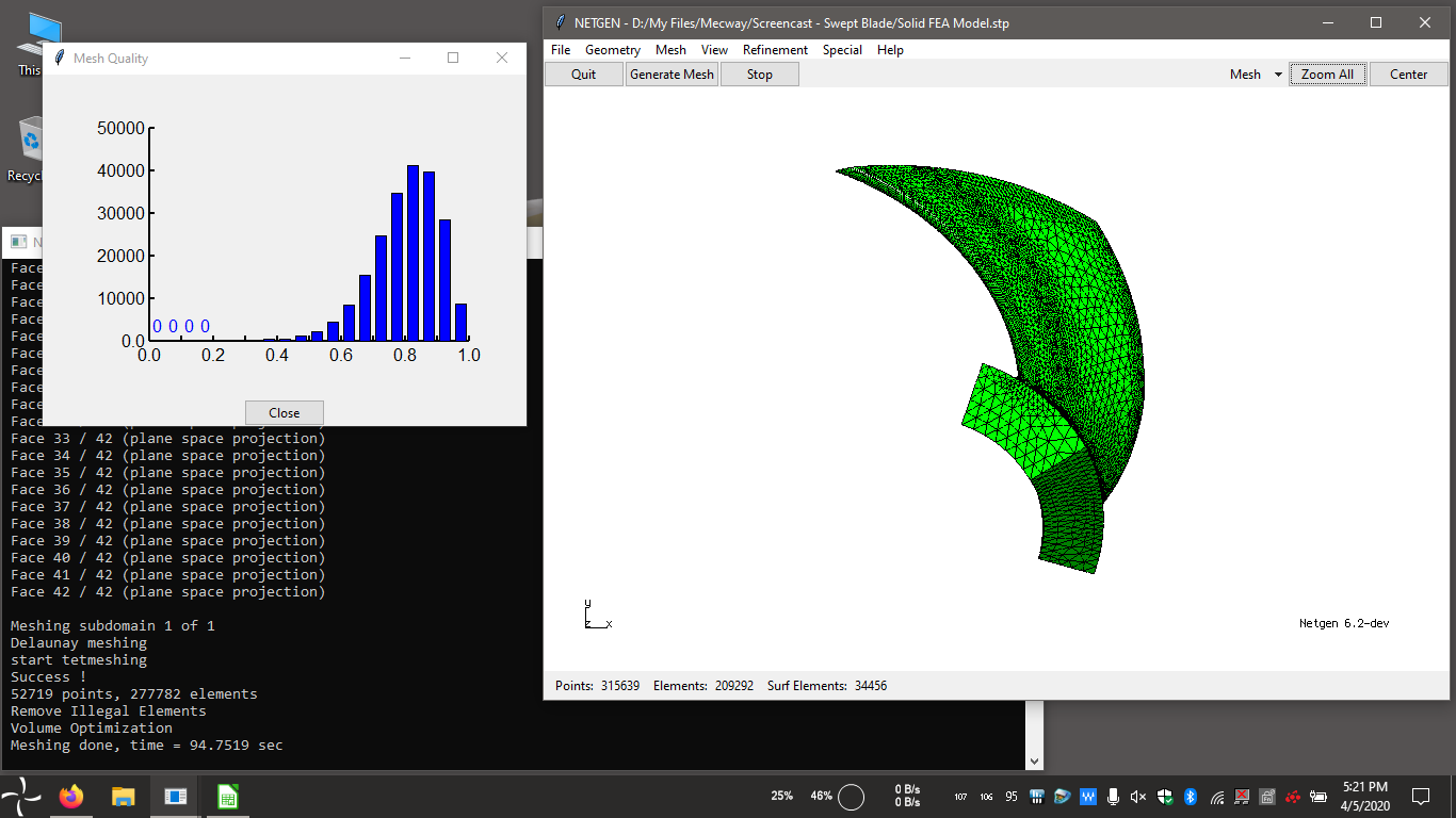

    so on one model i tested i got a 20% speedup. this was comparing 1 core to 2 cores. all mesh settings were the same. my laptop doesn't keep a consistent speed. so any multi-core testing is impossible to predict or understand. but still, 20% is nice. it feels like it's much faster than that to me. the times are in the command prompt window of the attached pictures.
    75.0915 sec for 2 cores
    94.7519 sec for 1 core
    the mesh has 315,639 nodes. far too big for me to solve.
