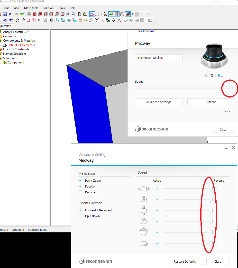

  • Did some minor testing last night with it and I am really liking the addition of the Spacemouse navigation option. Sensitivity seems fairly low, even when the mouse's settings itself are maxed but I may have just missed a sensitivity setting in MECWAY.
  • @cmmcnamara, there are no speed settings for the SpaceMouse in Mecway.
    Could you please measure roughly the time taken to do a 360 degree rotation and to pan across the whole screen with the controller at its limit? And also the speeds you prefer.
    Are all 6 DOFs of motion similarly slow or do you find some are inconsistent with others?

  • @Victor I suppose it's not super slow when the setting on the device is maxed out. I used Quick Cube as a baseline and it takes about 3.5-4 seconds for full rotation and about 2 seconds for a full screen pass. I could just be picky, my normal work flow usually has these settings quite sensitive in CAD and other 3D manipulation software. The 6DOF's are all fine, nothing is faster or slower than the other.
    This is only semi-related but now that the 3D mouse is included, I have to ask. Is there any way to set a hotkey for the Isometric view? In all of my other 3D work, my Spacemouse buttons are used to reset my view to Isometric w/Zoom Extents and the other to view normal to a selected face. May not be possible currently but this is a great new functionality I was curious about.
  • @cmmcnamara - the speed you described is about what I get for the default settings. But with all 7 speed sliders (attached picture) set to maximum, it does several revolutions per second and panning hard just makes it vanish off the screen instantly. Does your 3Dconnexion app have similar speed settings and is it still too slow with them all maxed out?
    The "fit" and "ISO1" preset view commands/buttons should work. There's a bug that doesn't immediately refresh the screen with preset views though. No normal to selected face command or combined commands in one button though.

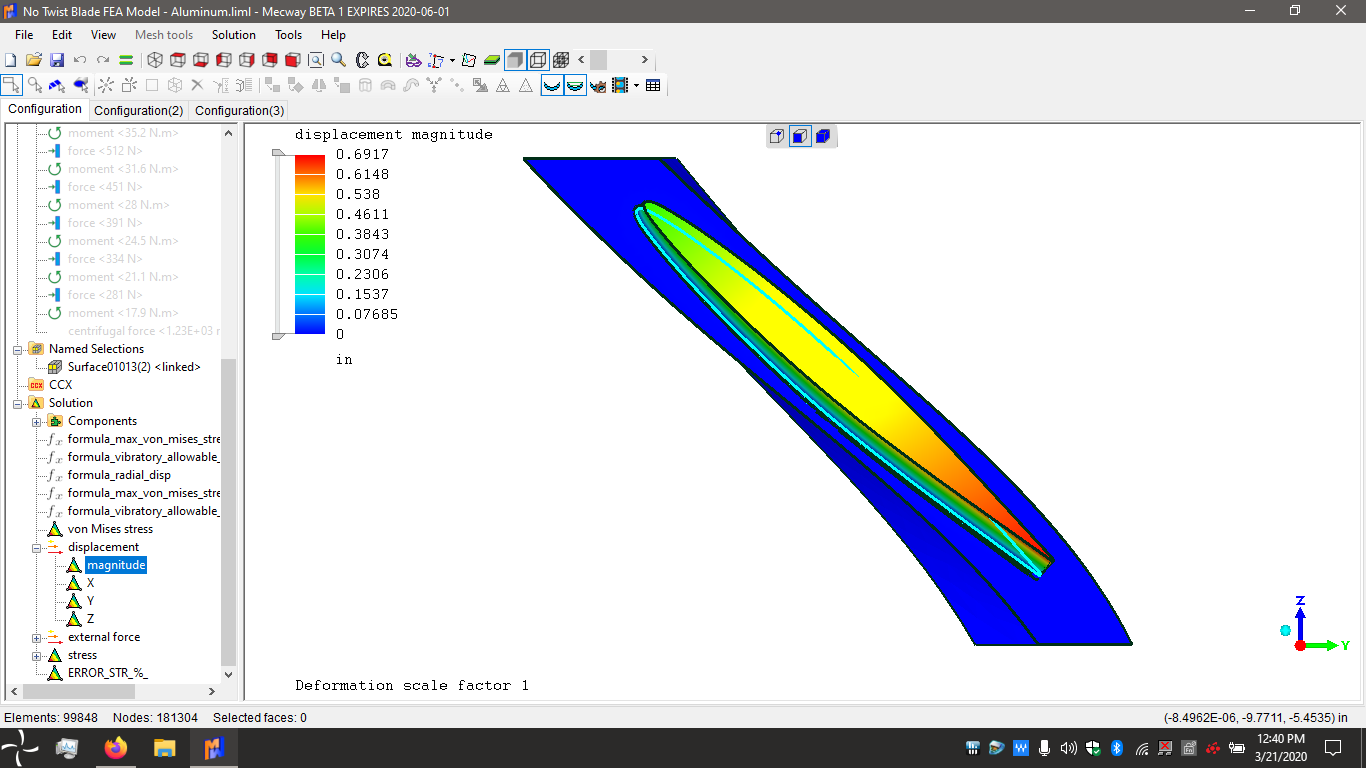

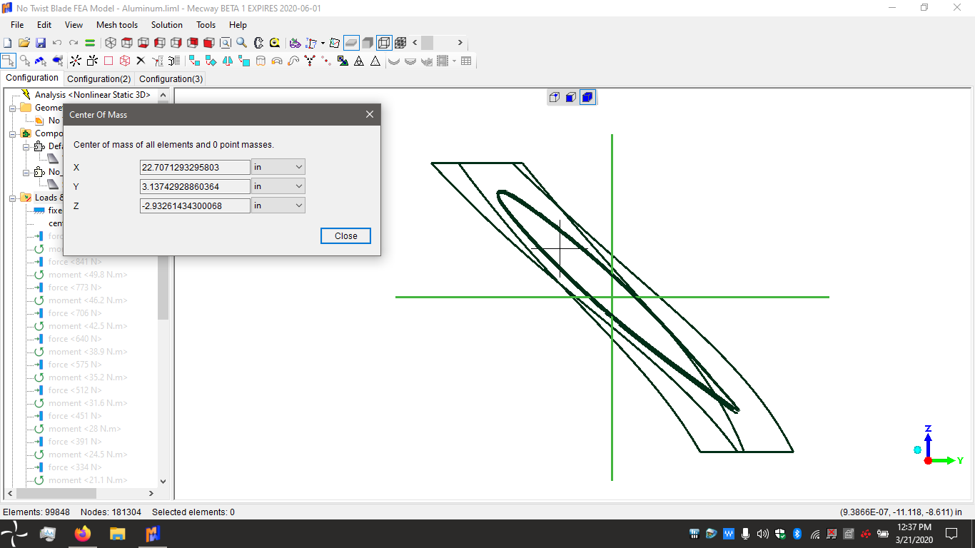

  • the new center of mass feature is very useful. i like the lines marking the location. here is an example, where the new feature helps explain the deformation results.

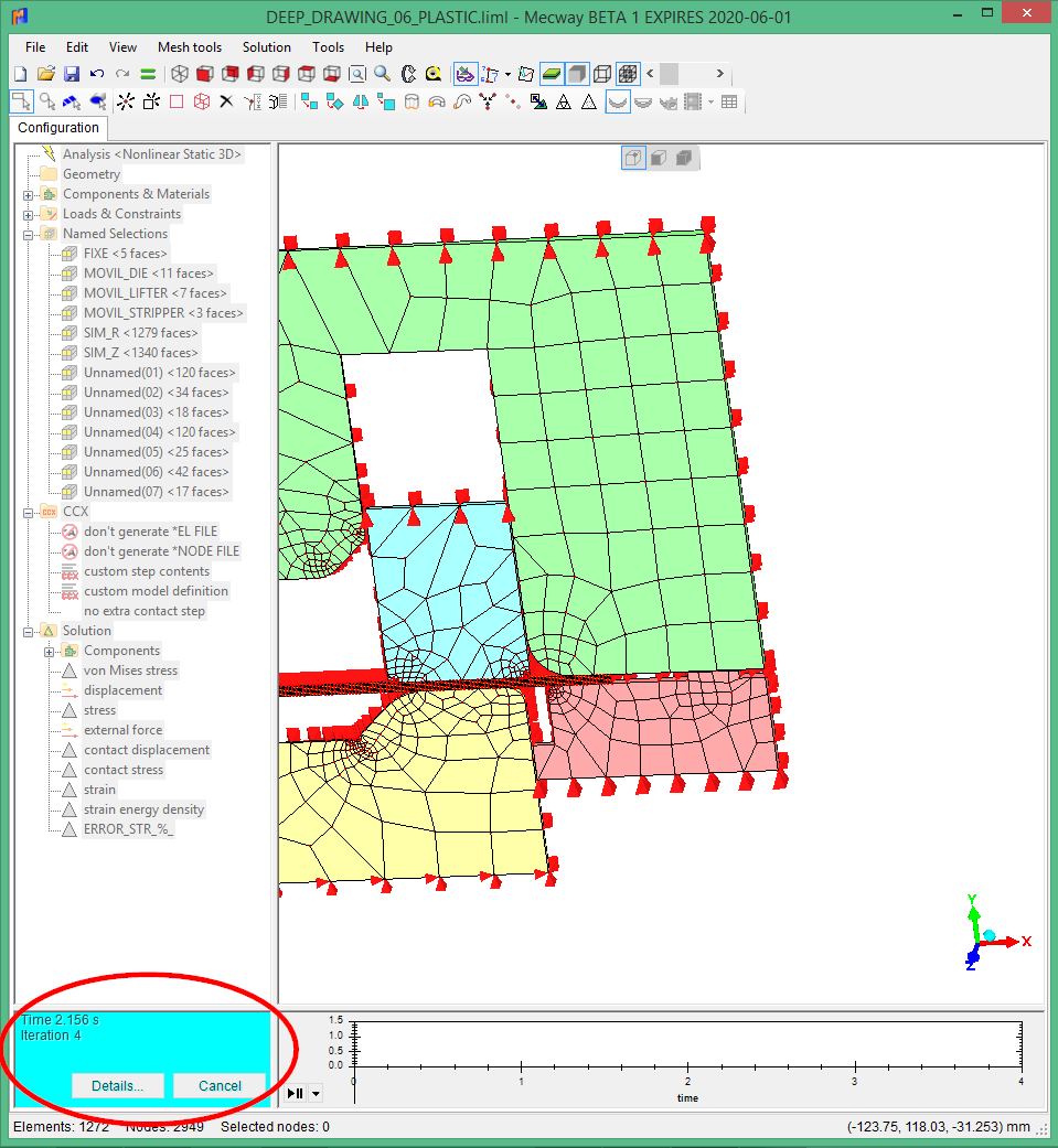

    • Bugfix: Slow and flickery title bar and no graphics context menu when timeline was visible.
    • Bugfix: SpaceMouse view commands (ISO1, etc.) didn't update the display immediately.

  • I can right-click select now, no flicker on top, looks good.

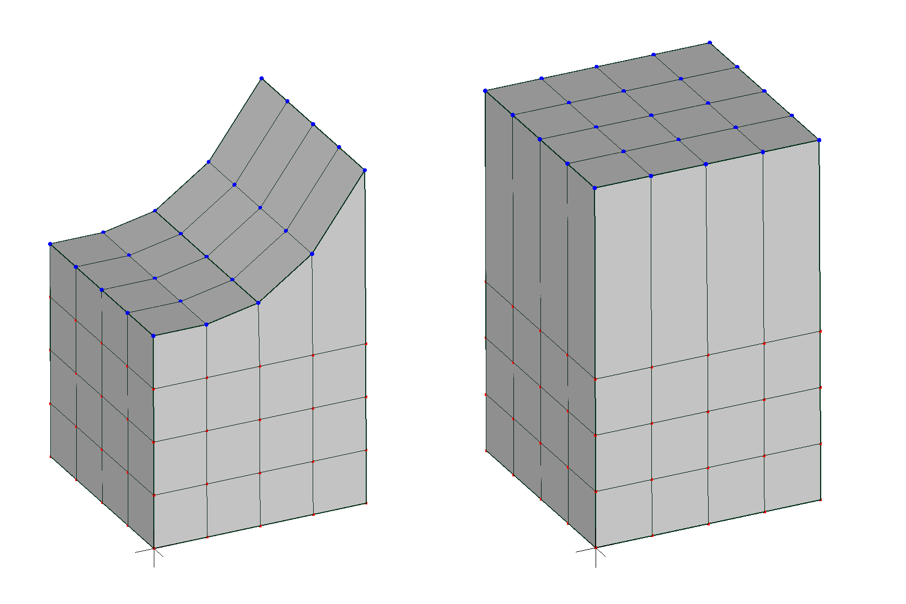

    Python API test -
    save this as modY.py
    select nodes, execute macro, input new Y value (m). It works!
    def mod_node(nodes, value):
    for point in nodes:
    mw.set_node_y(point, value)
    active_nodes = mw.selected_nodes() # Get selected nodes
    if len(active_nodes) > 0:
    value = mw.input("Input node y value: ")
    mod_node(active_nodes, float(value))
    else:
    mw.message("No nodes selected.")
