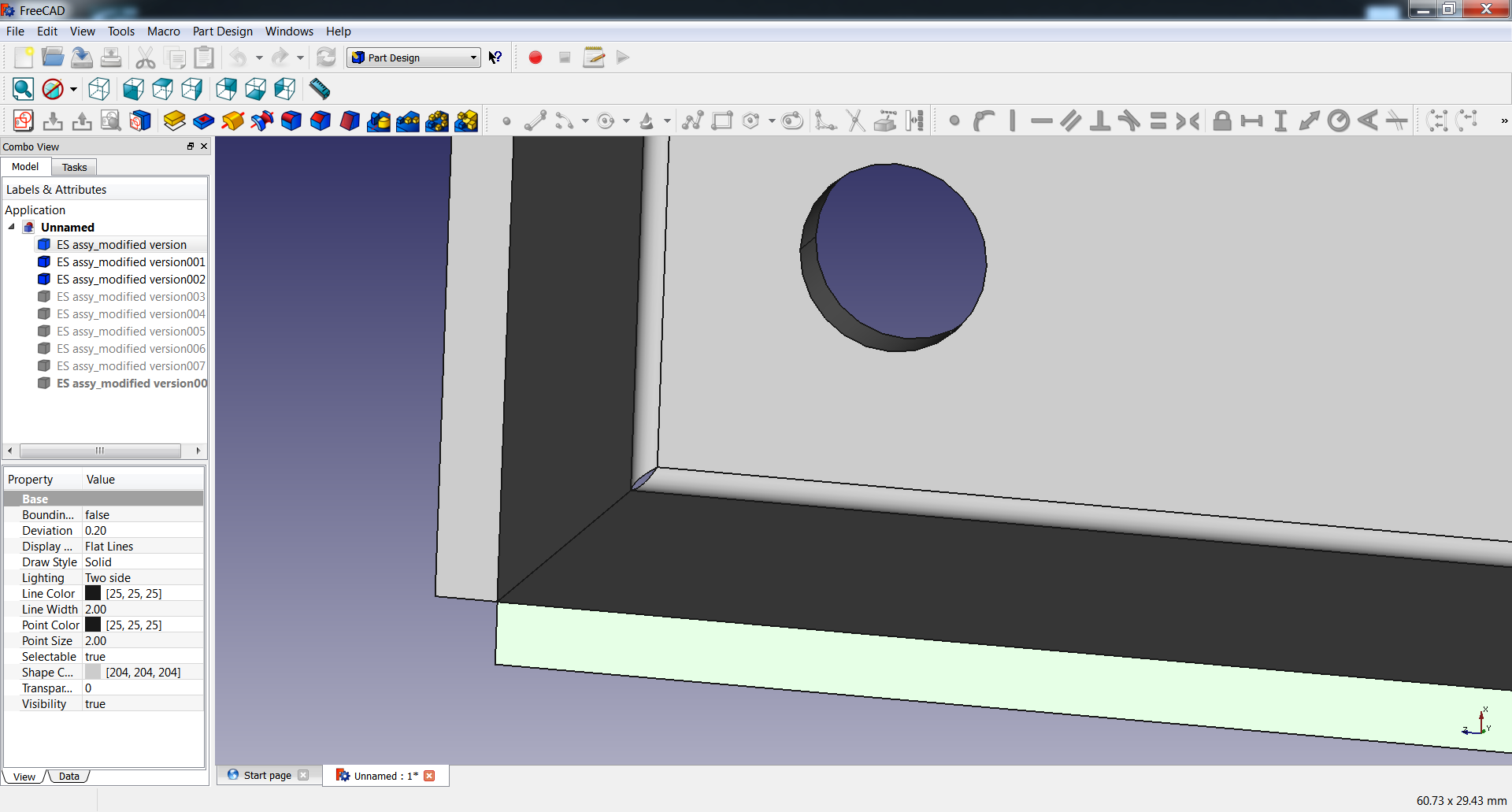

I am playing with the last version of Mecway and I bought a LISA licence few years ago. Both software gave me many problems on meshing, in particular when geometry is a mix of shells and solids "in contact" or some assembly of different parts.
I attached a typical example of an imported model that I failed to mesh. This is an assembly of shell and solid parts.
In this case geometry is quite simple (and it fails to mesh) and it can be reproduced in Mecway but often parts received from clients are more complex and the "reproduction" is almost impossible.
Is there a way to solve this problem? Is there a way to import a mesh from some other software (like Netgen or Gmesh)?
Unfortunately if the part cannot be meshed properly, Mecway becomes not useful. Or probably am I asking too much from the software?
Mario

    Indeed, meshing is a bit of a handicap with Mecway and I regret that it's causing you frustration. It can only do a single solid part in each STEP file. So no assemblies unless each part has its own file and no shells.
    Version 3 goes some way to helping with this by having bonded contact to connect incompatible meshes from each part of an assembly. You have to split it up into separate STEP files, so it's only practical for a few parts.
    Yes, you can import meshes from Netgen (.vol format) or Gmesh (.msh format).

    Mario, what was your plan for this? investigating the bottom plate and the two hinges? If yes, you can just export those three parts into step files and use bonded contact in Mecway to bond it or you can union them together first and export as one step file. In either case, your model to me will be very difficult to mesh in any software because of the way it was model. It's not quite solid to solid connections and not shell/face also. see attachment.
  • Mario, nevermind. It can be meshed. You can mesh it into different part using a meshing software that can mesh it and export the mesh file. Then import each mesh into Mecway. Mecway version 3 has the "bonded contact" that is very helpful in connecting different part together. I would look close at the results at those connections though.
    edited May 2015
    Mario, I think the assembly needs to be defeatured or removed the small holes and long edges radius which causing the model to be very large when meshing which are not contributing much in the overall results. We can just adjust the meshing parameters to a point but can't do anything more than that.

    Thanks very much for the time you spent to answer to my post.
    So, the way to solve it consists on importing the three parts separately and mesh those once at time. Interesting, I didn't think about it.
    Defeaturing models is also a valid option for simple structures or assemblies, less for more complex.
