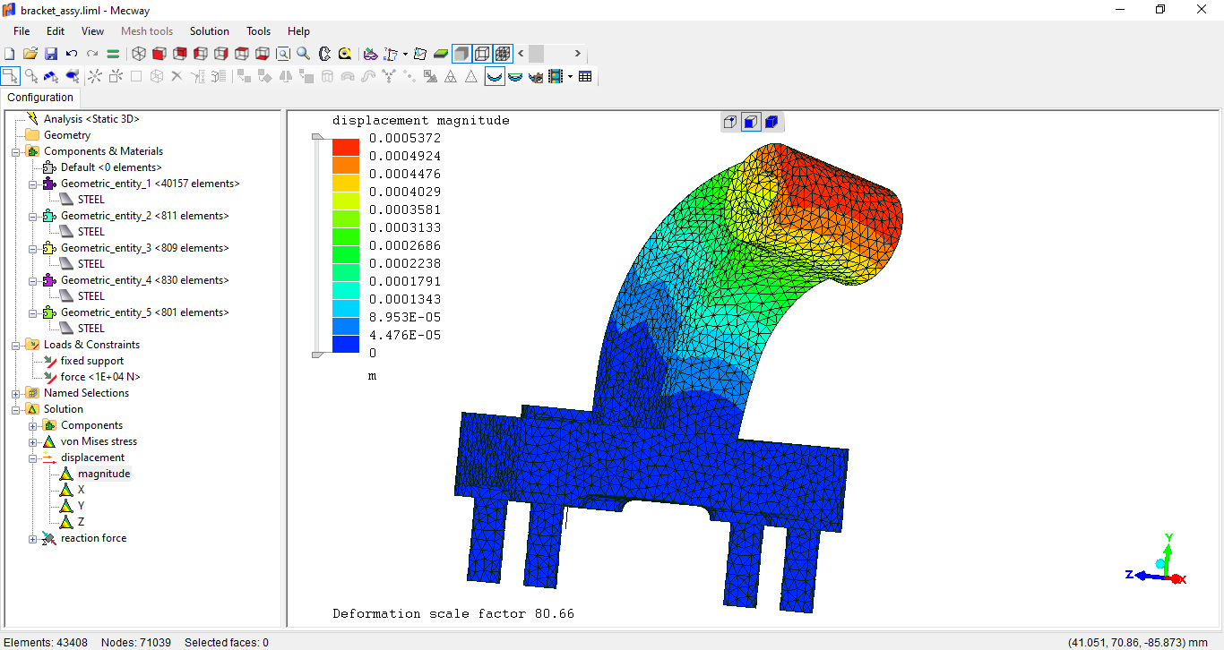

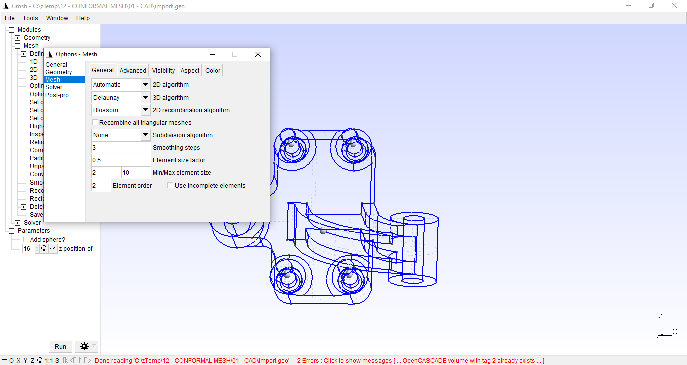

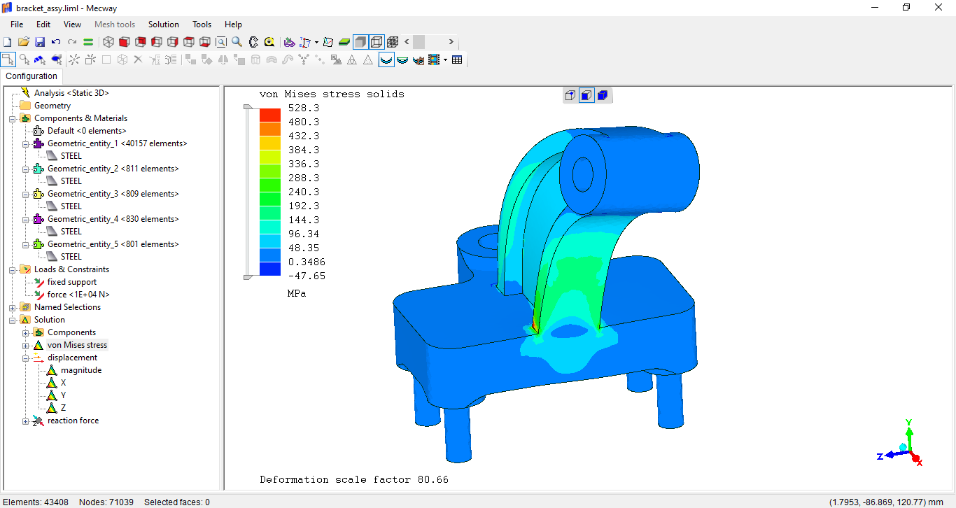

Finnaly, open Gmsh, open the .geo file (that will load the step file), adjust the parameters for meshing and mesh as usual. Then export the mesh (as an .msh file) and import in Mecway, to have the conformal mesh with the different bodies as Mecway parts, but with coincident nodes at the common faces.

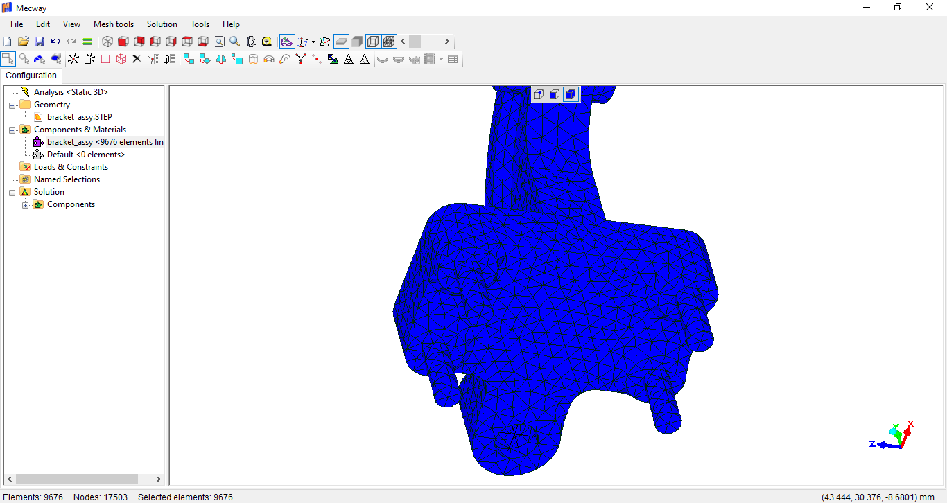

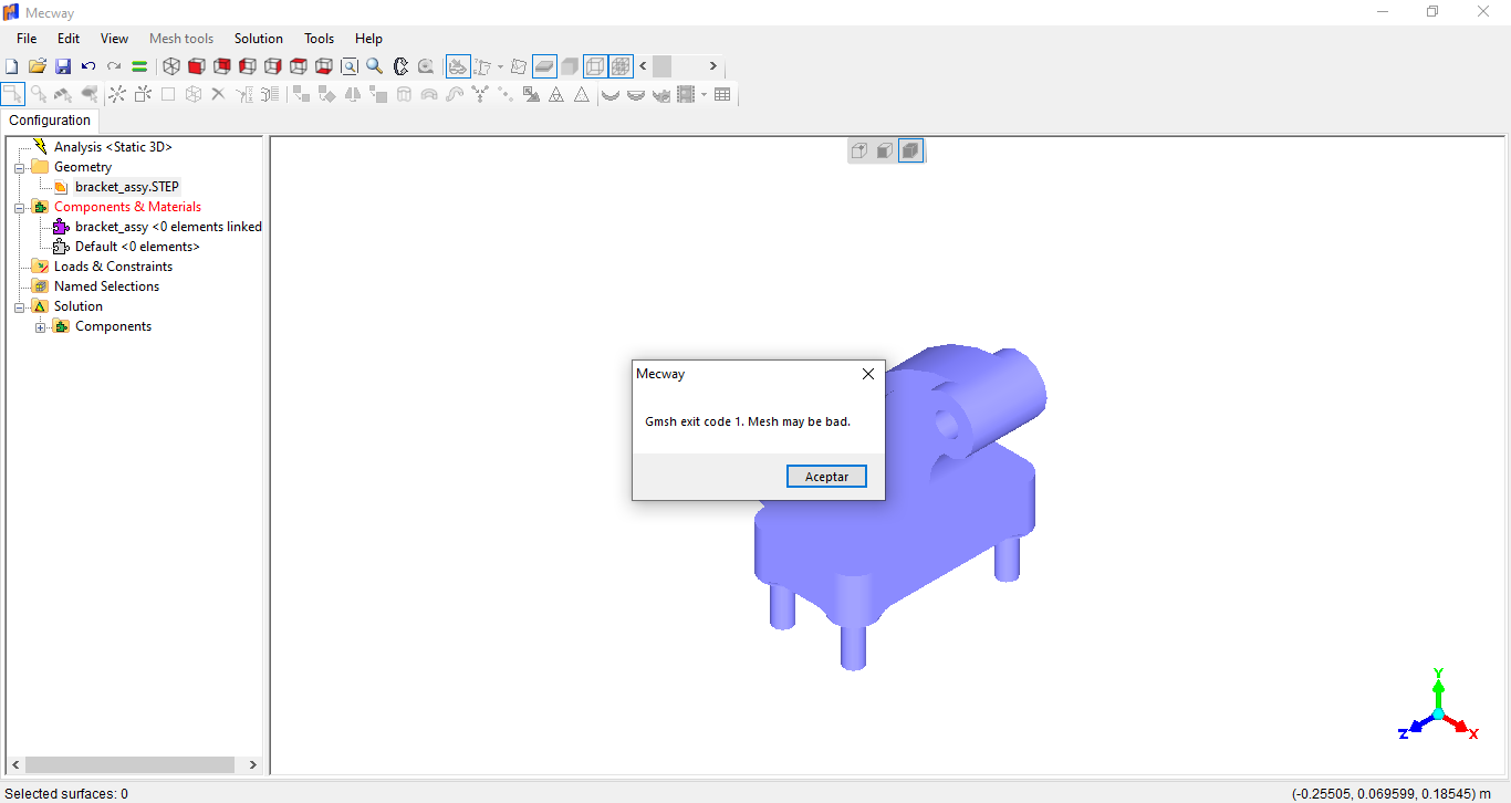

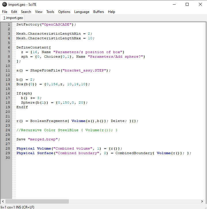

I took the import.geo file from the Gmsh install folder, it has some lines that should not be there for just importing and meshing. Have tried to do it directly in Mecway, importing the assembly step and then in the Gmsh meshing options importing this geo file, but even if a mesh is created, it shows some error and the resulting mesh is not usefull

  • Rename this file to import.geo to use it.
  • Thanks for showing this Sergio. It looks great! Especially where the edges of the holes meet the surfaces of the studs.
    What is the key setting that makes it work? Is it related to that Box and Sphere or are they just the leftover things you mentioned?
    I'll have a look later to try and work out why it doesn't work through Mecway.
  • This are the keys that make it work, still was unnable to make it work within Mecway, but works with Gmesh aplication. I has to read the Gmsh documentation to see what they are doing
    SetFactory("OpenCASCADE");
    Mesh.CharacteristicLengthMin = 2;
    Mesh.CharacteristicLengthMax = 10;
    Mesh.CharacteristicLengthFactor = 0.75;
    SetOrder 2;
    OptimizeMesh "Gmsh";
    a() = ShapeFromFile("bracket_assy.STEP");
    r() = BooleanFragments{ Volume{a()}; Delete; }{};
    Physical Volume("Combined volume", 1) = {r()};
    Physical Surface("Combined boundary", 2) = CombinedBoundary{ Volume{r()}; };

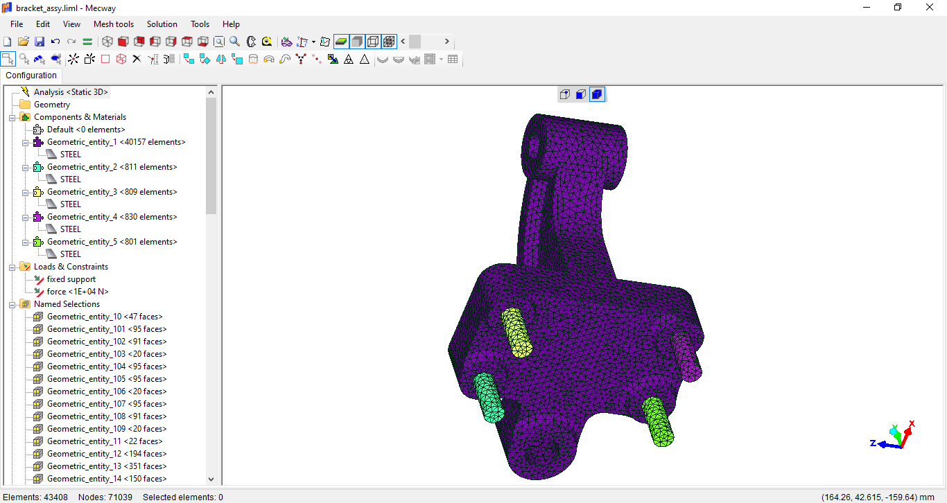

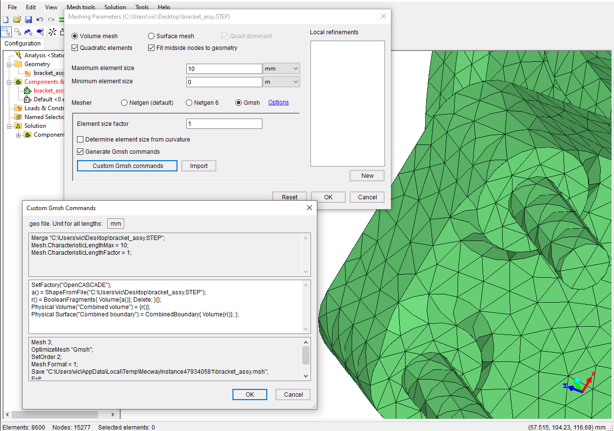

  • I've simplified that code and got it working in Mecway. I think the key is to specify the full path to the STEP file. Here's the code to add to Custom Gmsh Commands:
    a() = ShapeFromFile("C:\Full\Path\To\bracket_assy.STEP");
    Physical Volume("Combined volume") = {r()};
    Physical Surface("Combined boundary") = CombinedBoundary{ Volume{r()}; };
    A problem is that it loses associativity of the surfaces but this is still a pretty simple way to get a good mesh from an assembly! So thanks a lot Sergio!

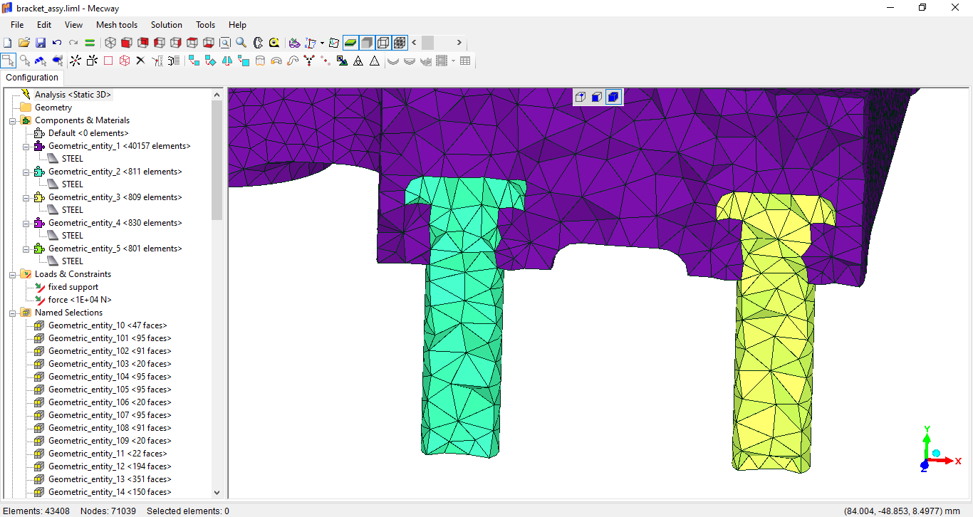

  • Have tried with two models and works, but is there a way to keep the different bodies separated?
  • No, sorry unless you open the .msh file using File -> Open/Import.

  • @disla, not sure if Gmsh identifies the separate parts. If it does, perhaps I can get Mecway to read that information. But I wonder if that code Sergio posted merges it all into one homogeneous thing?
