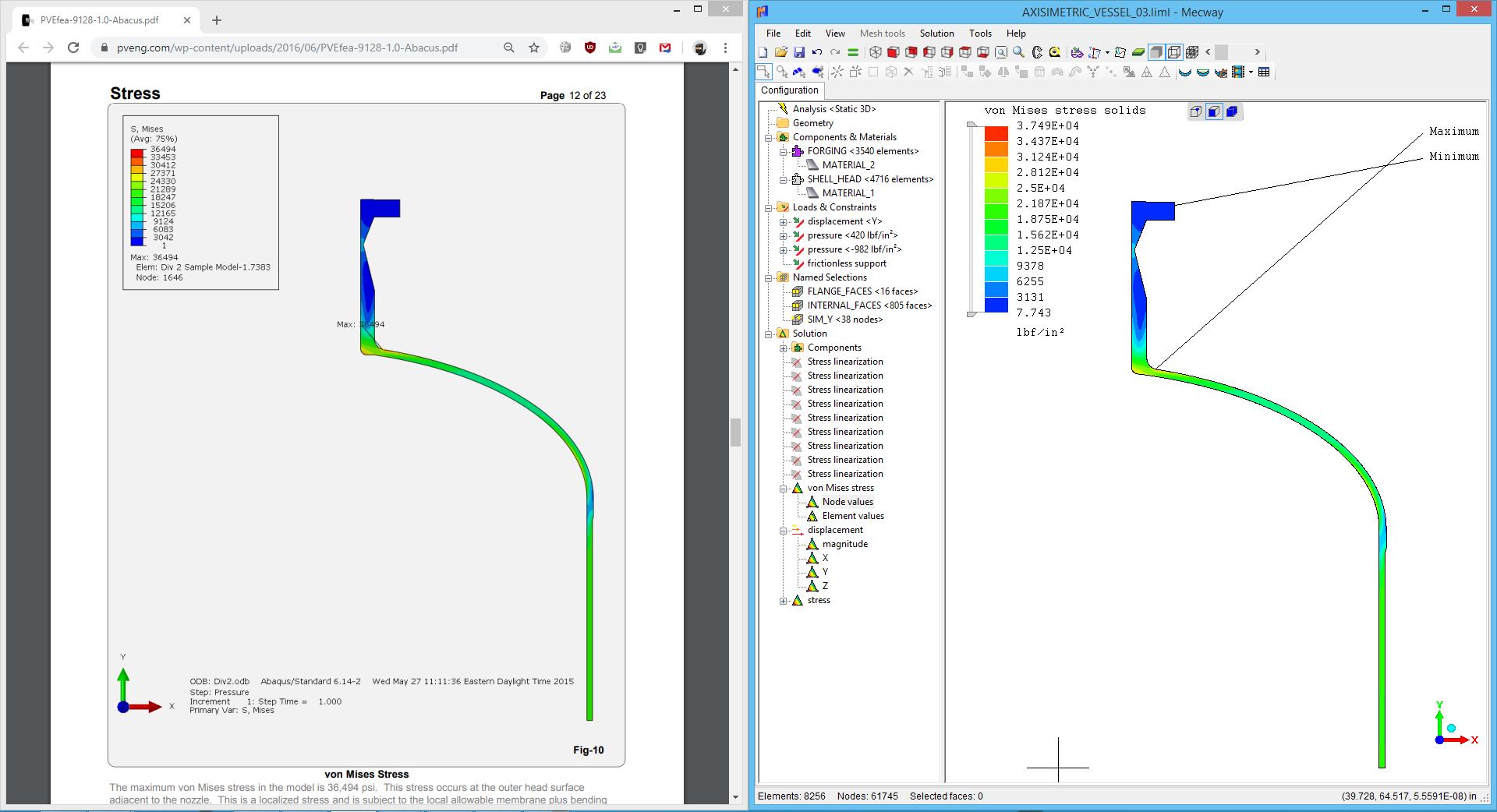

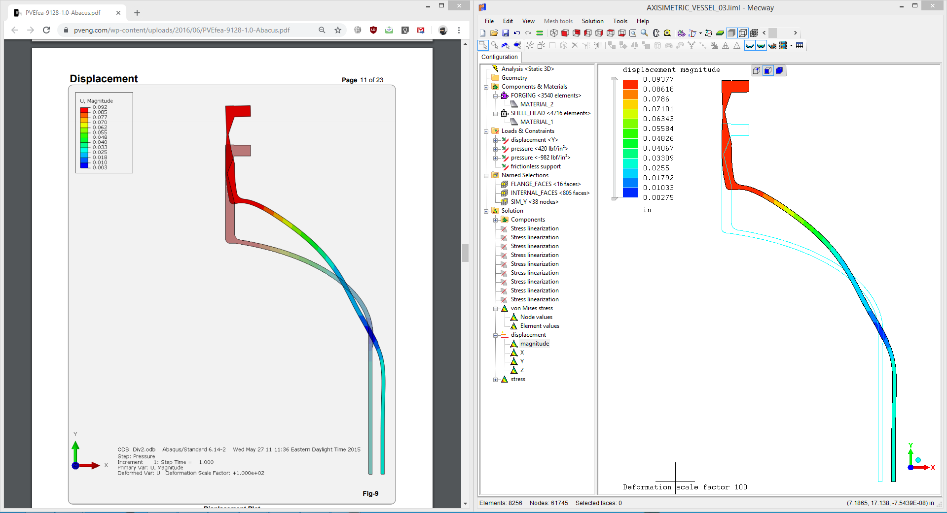

Hi, I'm working on some under pressure parts, and in order to validate the results, took as reference this problem found in the PVEng site:
https://pveng.com/wp-content/uploads/2016/06/PVEfea-9128-1.0-Abacus.pdf

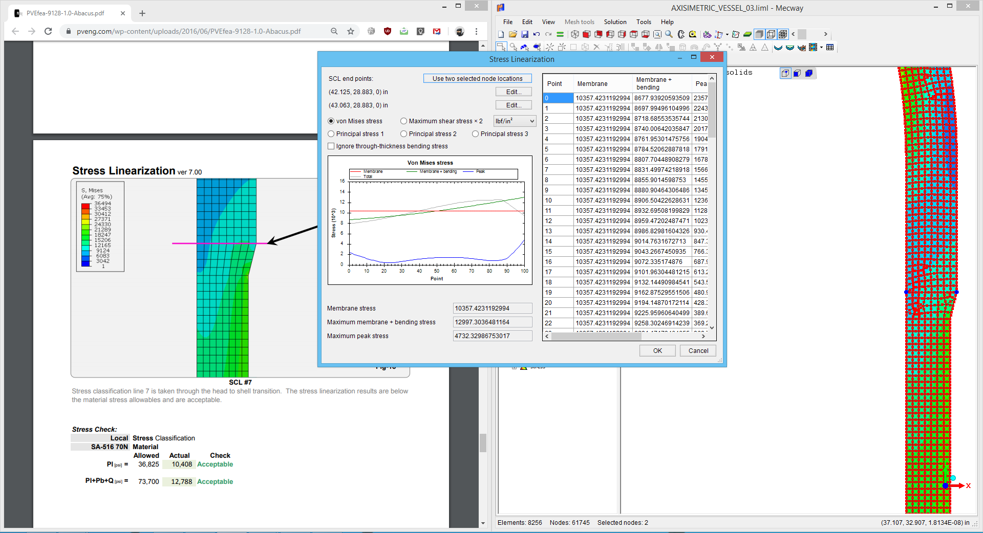

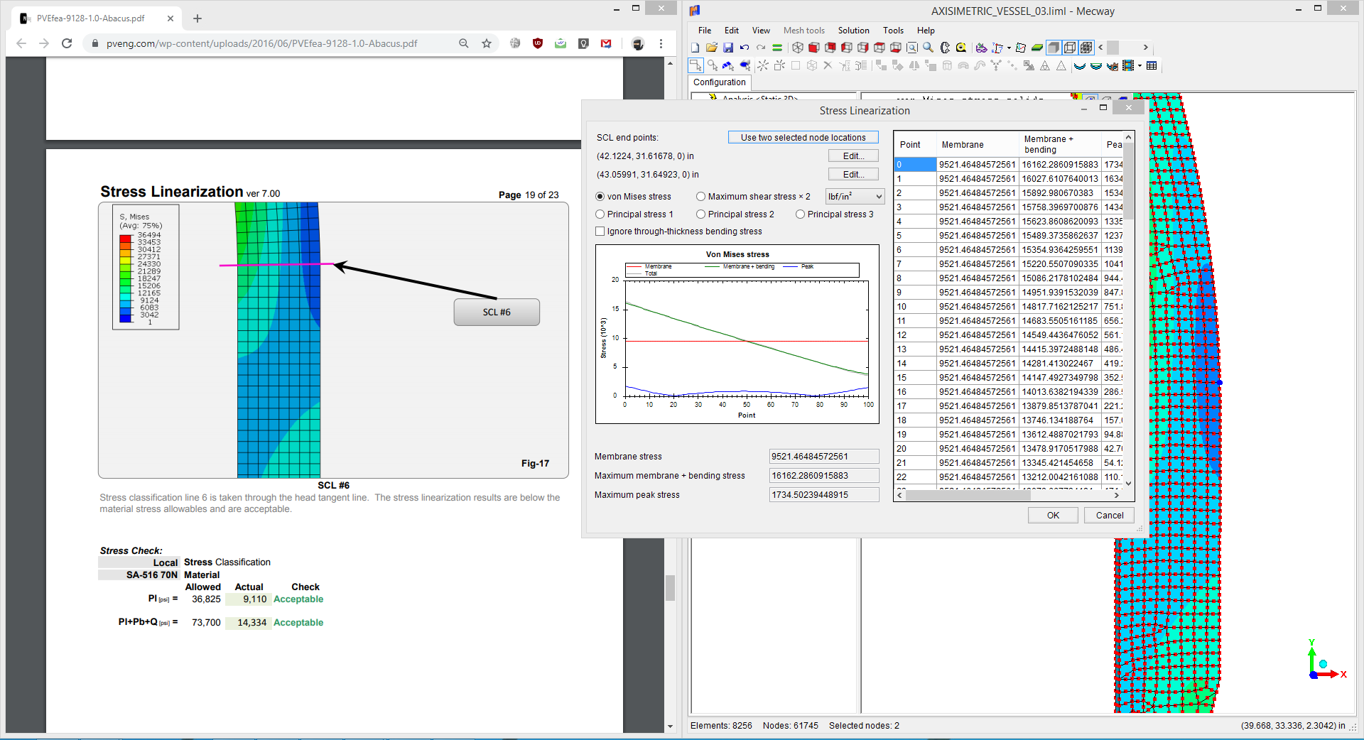

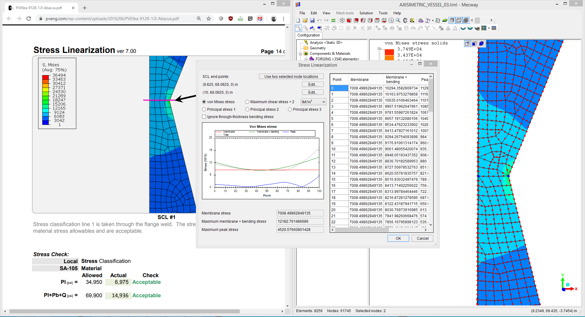

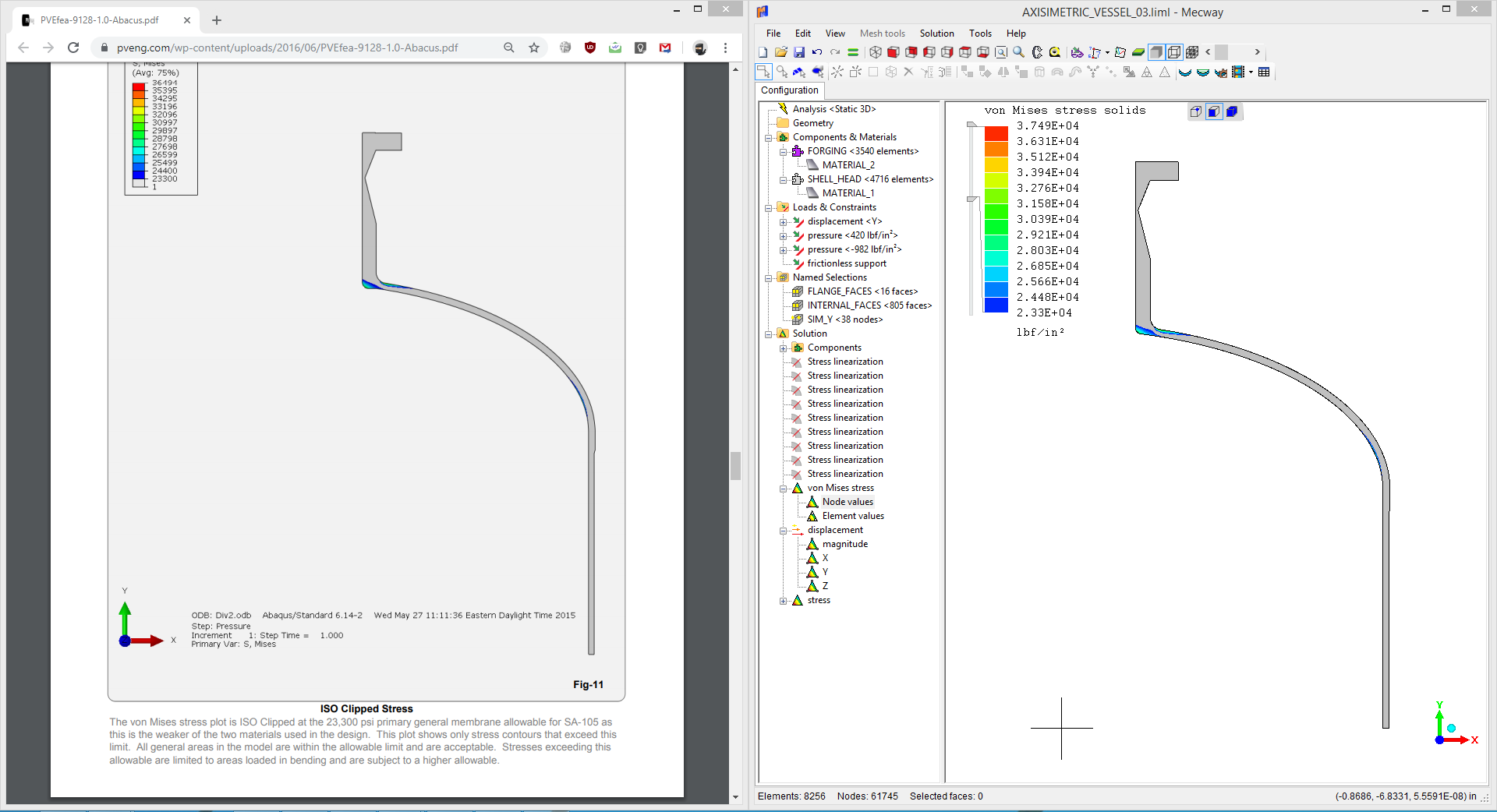

First results looks very close to the references values (probably the difference is due to different geometry in the drawing than in the model used in Abaqus report, see the plane surface between SCL#3 and 4).

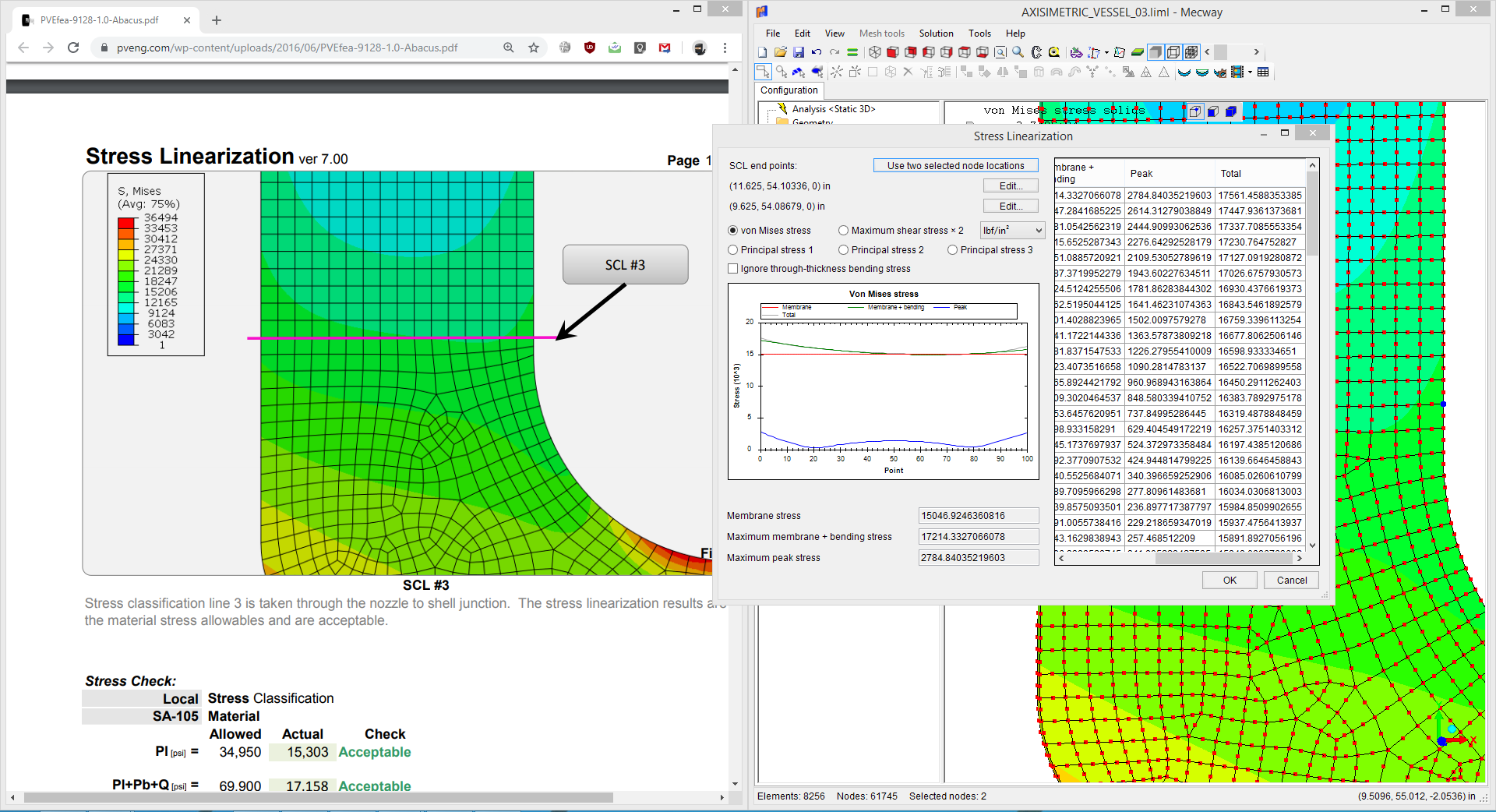

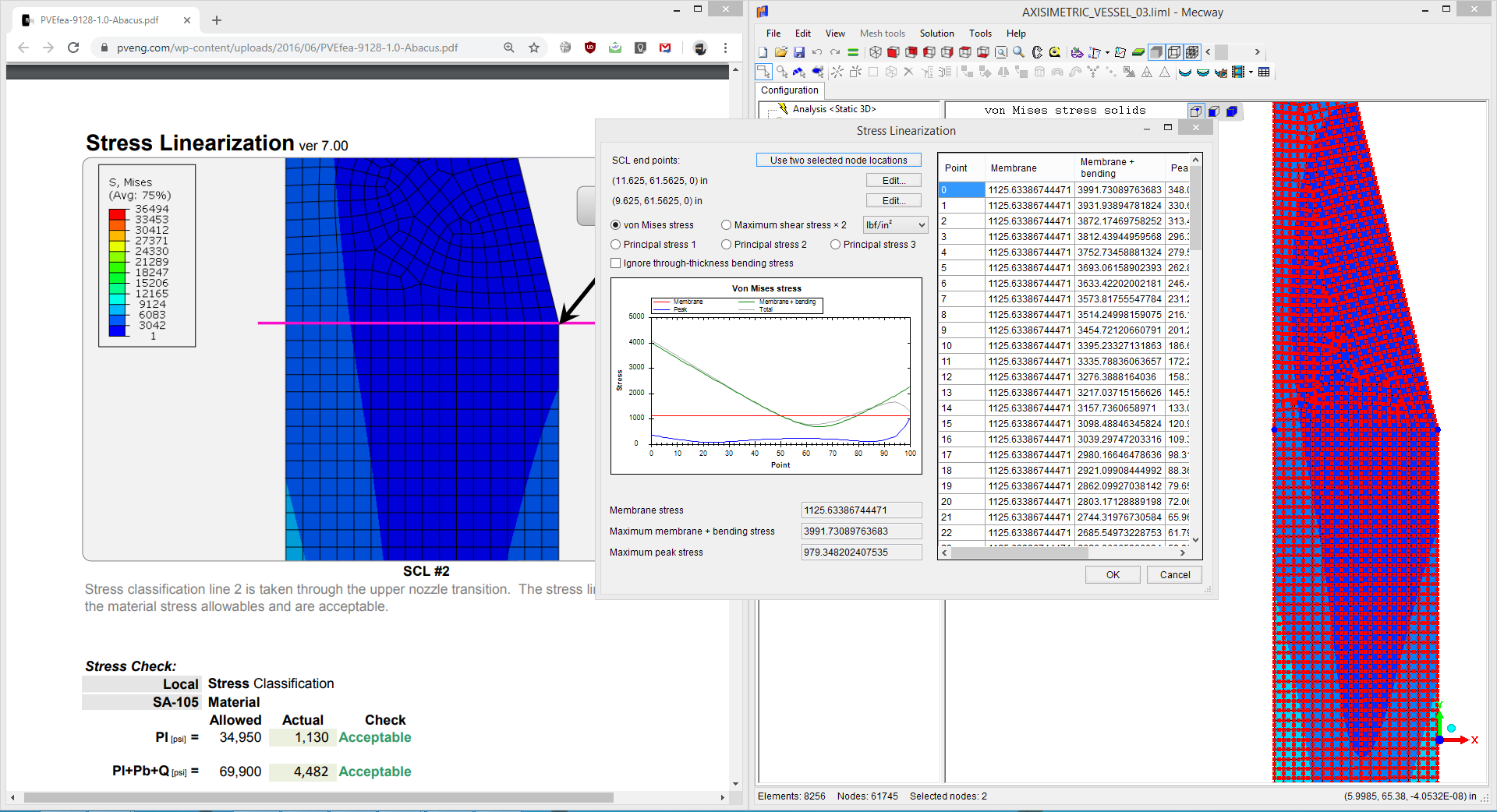

@Victor , is possible to compute the "primary membrane stress + primary bending stress + second equivalent stress" (Pl+Pb+Q) with the stress linearization results???
  • I don't know a lot about the ASME code but are you asking for it to do stress classification to identify secondary stress Q then sum it with Pl and Pb? I think that might be difficult for general purpose software because it depends on quantities like distance from a discontinuity that are hard to determine automatically. Is it possible to obtain Pl+Pb+Q in a "dumb" way from the other stresses? Can you do it manually by solving again with different loads, such as maybe thermal stress in isolation from mechanical loads?
  • Sergio

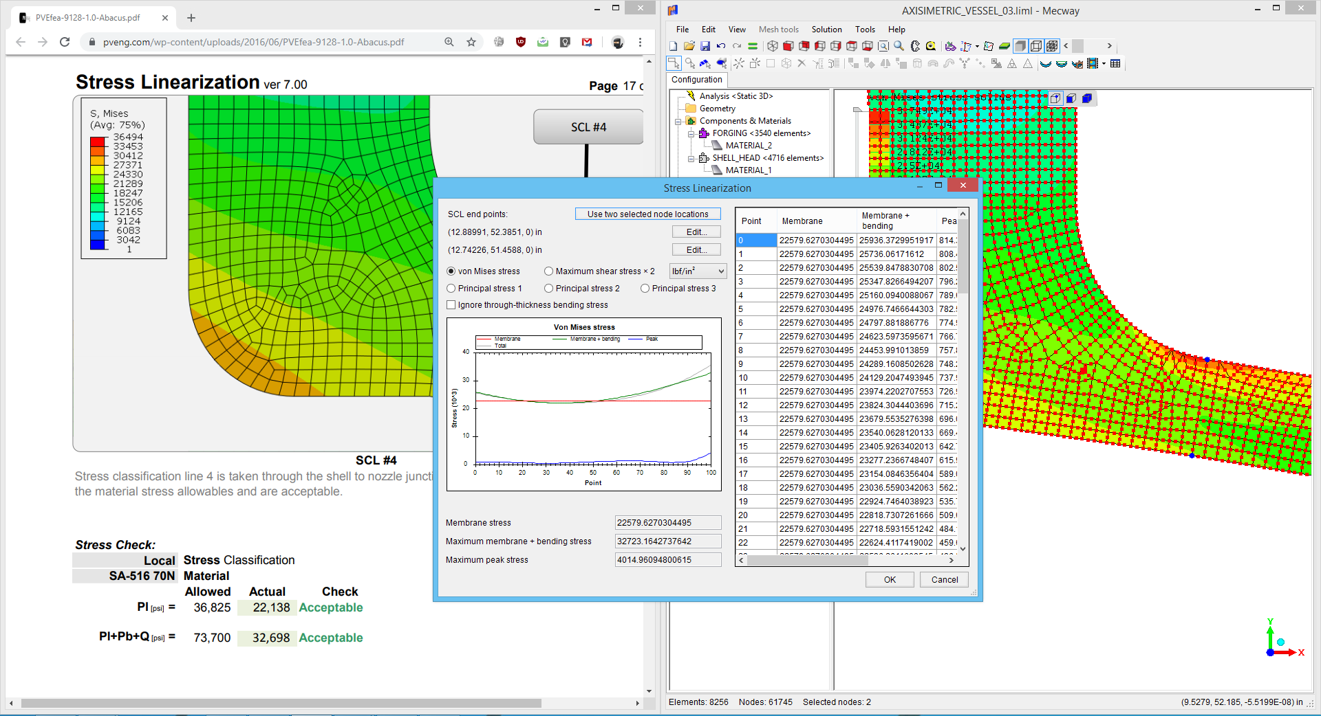

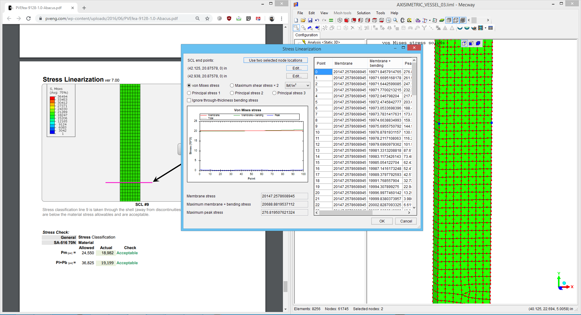

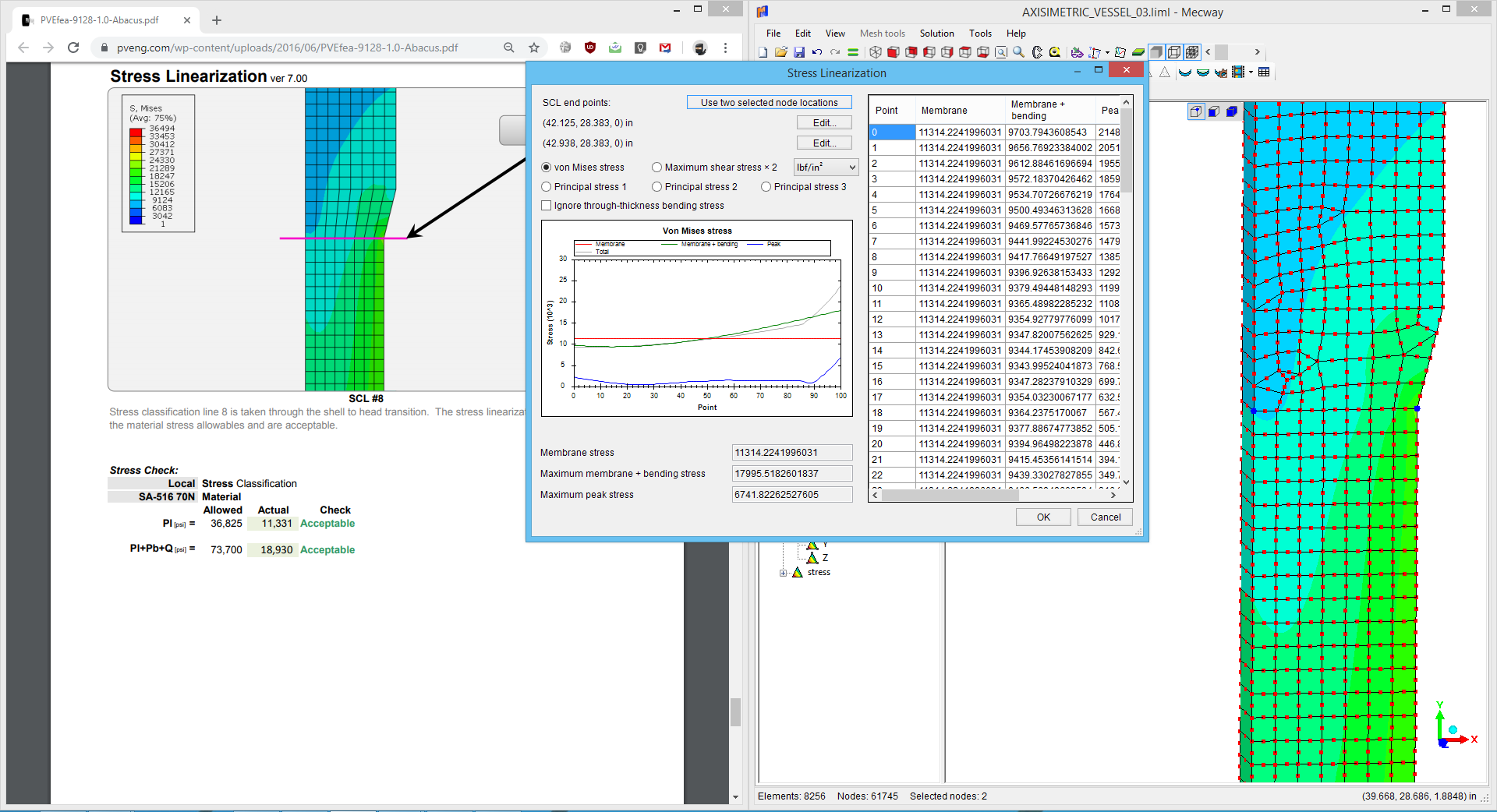

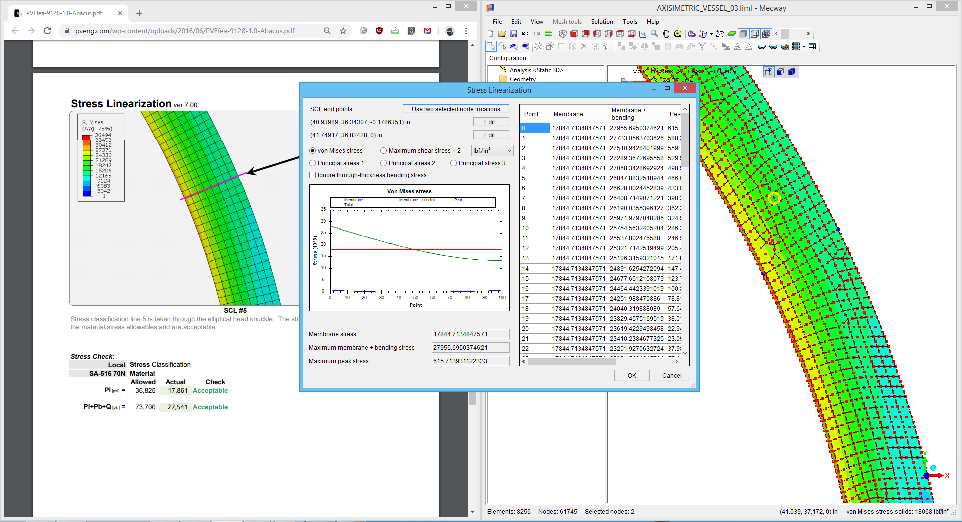

    'Pl+Pb+Q' equivalent stress calculation - is that not what has been calculated in your linearised stress results? For instance at SCL4, Mecway value for max bending plus membrane = 32723, compared to 32698 listed against Pl+Pb+Q in the reference document.
    As per ASME VIII Div 2, Q does include the effect of primary loads, its just a localised stress at a structural discontinuity.

  • There is a difference in this FEA model against the P-Veng, look in the plane zone bellow the pipe, that is present in the results but not in the drawing. I will fix as soon as I have a little of time, saddly I don't have the editable geometry, but is easier to fix even importing the step. Definitely I will redrawn in Alibre to have the whole example editable.
