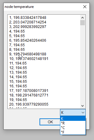

I just made a transient temperature study. After that, I wanted to use the temperature data for a static study.
I made "transfer temperature from solution" for my static study.
When you edit that constraint, if you change the units, (From K to Celcius for example), it won't update the values and consider the new units... that doesn't make sense to me... I think it would need to update the values to reflect the new units selected or just do not permit to change the unit?
  • Yes, this is a bit of an inconsistency. Complicated data like lists and formulas don't update when you change the units. So if you want to change the units for display while keeping the physical meaning the same, you have to manually edit the numbers. Probably by copy/paste through a spreadsheet in this case.
    You're right that the option to change the unit is fairly useless for Transfer temperatures from solution. It's mainly there for if you had entered that data manually. Then you would choose the unit corresponding to the values you entered. Or if you forgot to set it beforehand and entered, say -10 K instead of -10 °C, you could change it afterwards without having to re-write the whole list.
