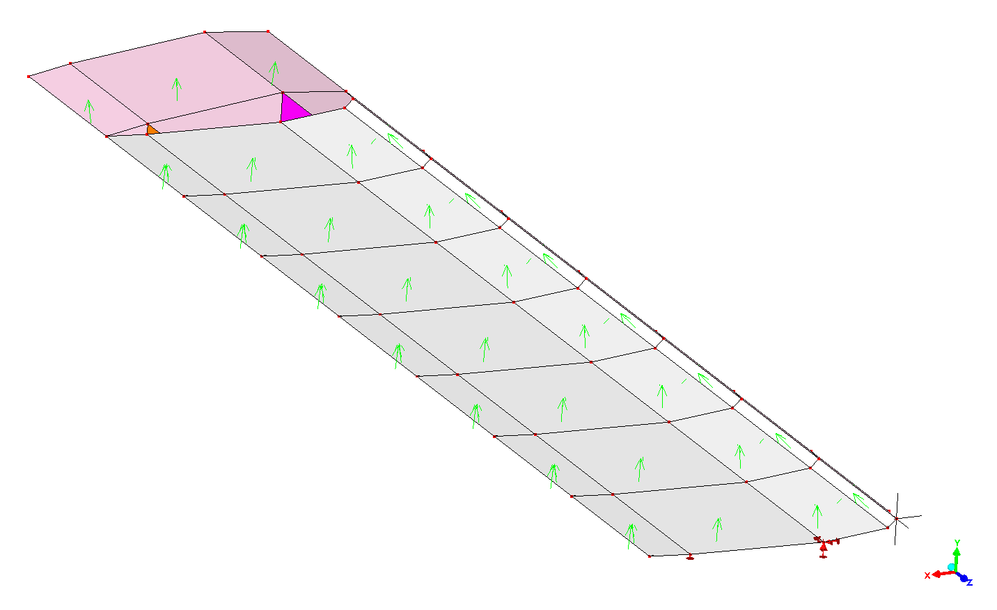

I'm modeling stresses and vibrations for small airplanes and need to input the pressure loads over the wing and aerodynamic surfaces. Since my structural elements are thin, shell elements are most convenient. I start with the airfoil profile and import as a dxf file, then extrude or loft into a wing of shell elements. But manual adding hundreds of pressures over the surfaces for each angle of attack is not practical. So at Victor's suggestion, I edit the liml file for the element geometry and use a math program to read in text files, find the pressure (from aerodynamic program) for each surface face, and prepare an output file in Mecway format. Then I use cut&paste in WordPad editor to add the pressures to the liml file under loads. Now I can readily assign the detailed pressure distributions for as many elements as desired. Attached is a png graphic of my test case for a crude airfoil with 32 quad4s on top and 32 on the bottom. By clicking on each pressure load in the tree, I quickly verified that each face was assigned the correct pressure value. Initially some pressures were backwards and I found that surface faces could be a 5 or a 6 from the same extrusion, so now my math program reads in the face as well as element number and so assigns.
In my test case, I used elliptic loading for the span distribution, constant pressure on the bottom and a linear chordwise suction for the top of the wing panel. The graphic shows the positive pressures applied to the bottom of the wing. Unfortunately, Mecway now displays suctions as from the inside so I have removed part of the bottom skin to illustrate this; front and rear spars are visible as well. After applying the pressures, I change the shell elements to quad8 and can refine as desired for stress calculation.

  • Here's a simple example of an elliptic pressure distribution done with a formula in the pressure load.
