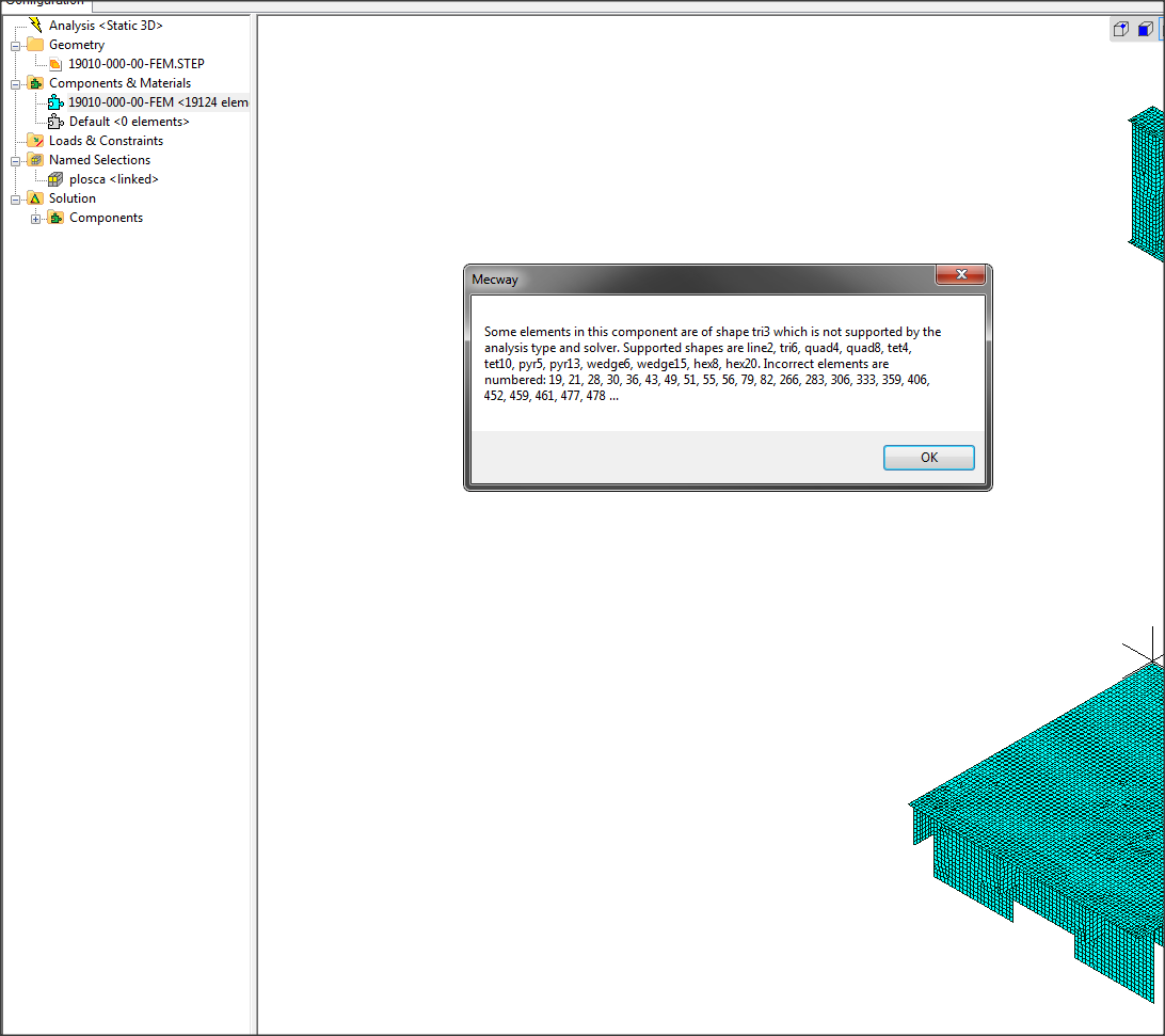

tri3 element error for Static 3D analysis type
When I generate a mesh with quad4 elements I get some tri3 elements in the mesh. I try to tweak parameters, that there is as less as possible tri3 elements.
But I have an error that says that tri3 element is not supported by Static 3D analysis. What is the correct solution here? To change elements to tri6 and quad8?
  • Yes, change to tri6 and quad8. Check Quadratic elements in the meshing parameters window or use Mesh tools -> Change element shape if it's an orphan mesh.
    Or you can use the CCX solver which allows them, but beware that accuracy can be poor.
  • Ok. I thought so. Thanks for answer.
