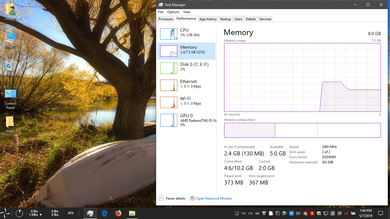

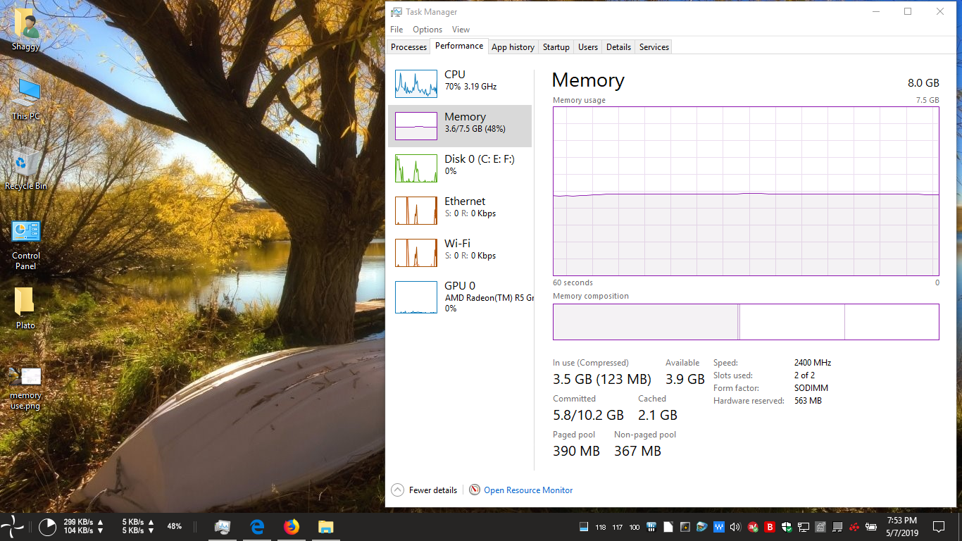

  • hi victor and sergio,
    i'm just curious how much memory windows uses on your computers. i think victor has said he has 16gb of memory and sergio said he had 32gb of memory. i guess on my laptop the 3.5gb of usage was with my web browsers open. i also have some hardware monitors running in the system tray and taskbar. as well as open shell. if i close the browsers it drops from 3.5gb to 2.4gb. i'm curious how much windows will take if i get a laptop with more memory in the future. i attached some pics of the memory usage. this is before opening mecway or anything else.

  • Mine says 2.9 GB (out of 16 GB) with not much else open. I wouldn't make any decisions based on these numbers though because how memory gets used is so complicated.
