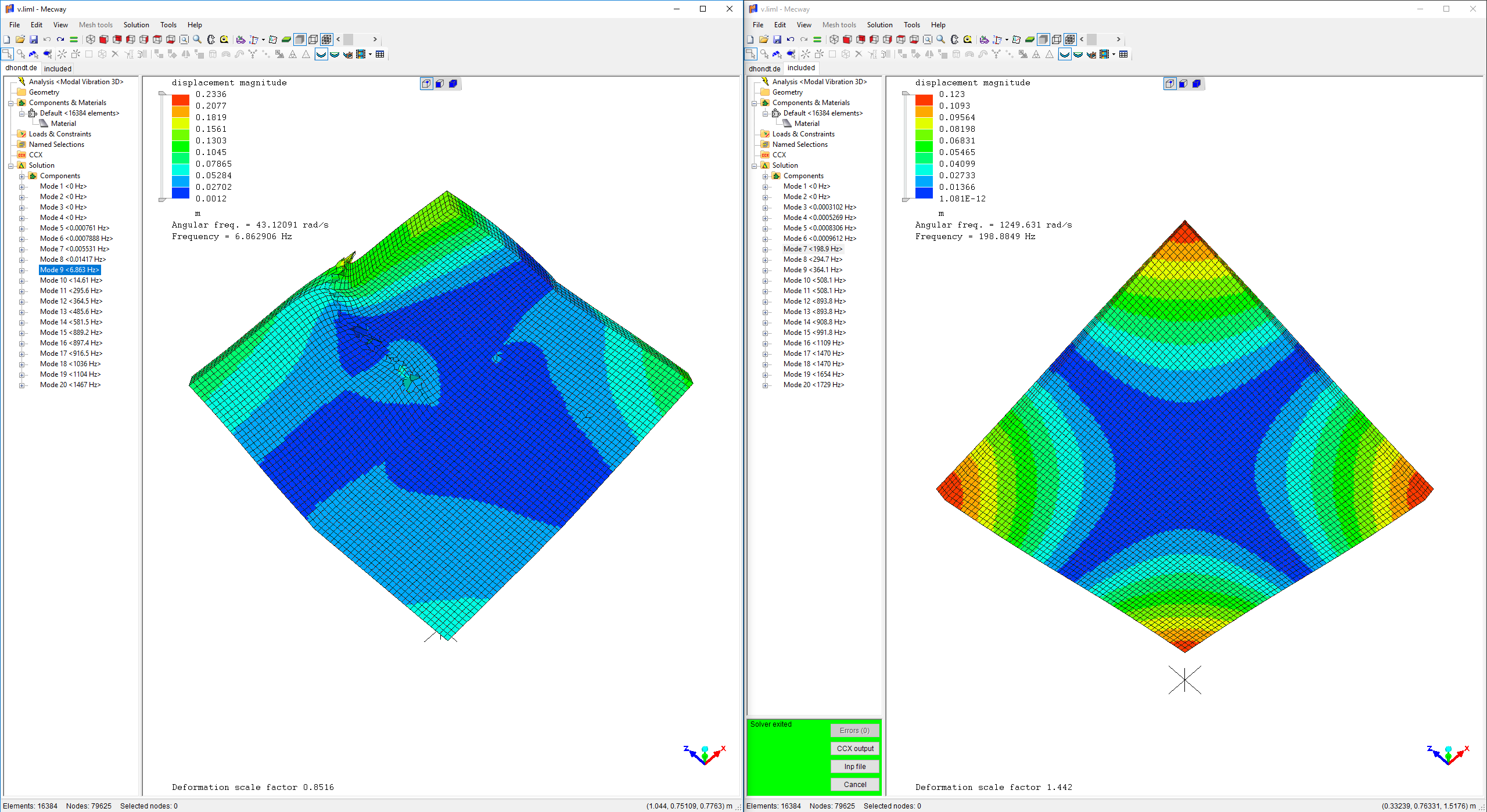

  • I've reproduced the problem that the ccx.exe 2.15 on dhondt.de can have obvious random errors with modal vibration (*FREQUENCY) that the single-threaded version included with Mecway doesn't. Here is a solution from the multithreaded one on the left and the single threaded one on the right.
    I had the environment variable OMP_NUM_THREADS = 8 and my CPU has 8 logical cores (4 actual cores). It worked OK with OMP_NUM_THREADS = 4, 2, and 1. So it might be OK as long as you set that variable appropriately.
