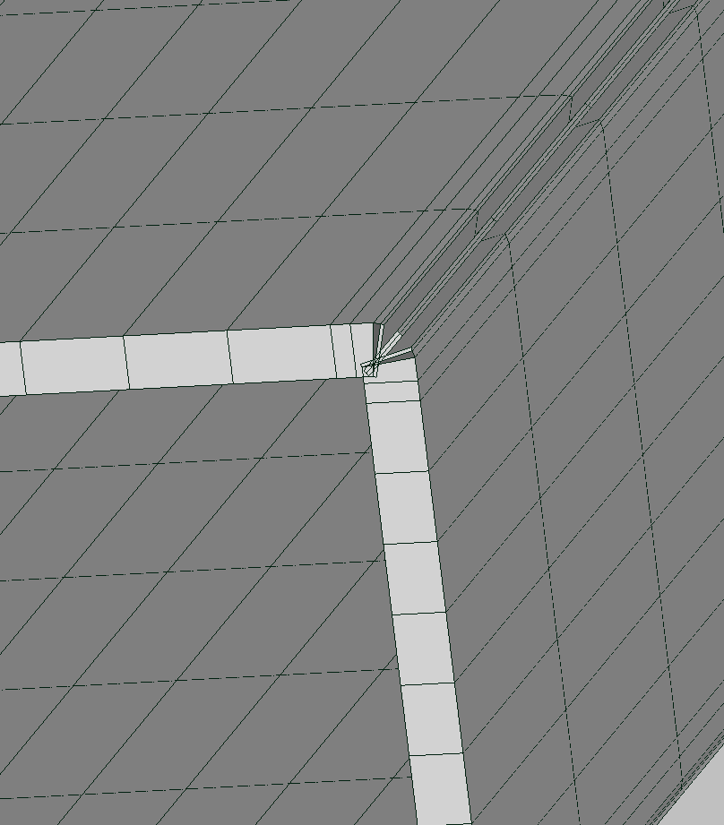

As the title states, when I run an analysis with shell elements with CCX, the components in the solution become solids. Is it possible to view the results as a shell without the thickness? This makes it difficult to see details on corners.

Yes, that's the problem and it's a big limitation of CCX's 2D shell output. The internal solver keeps those 3 values (top, middle, and bottom stress) separate in its 2D element solution so you can view each layer's stress individually whereas CCX averages them.
That corner in the picture might be too sharp for shell elements, as you can see by them intersecting each other. So the stress there might not be much use anyway. It would be safer to model those details as solids if they're important.
