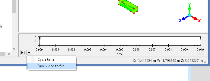

Hello Louis
Yes, there's a separate menu next to the play/pause button for the transient animations, as shown in this picture.

Thanks Victor, but I don't see this as an option in the version 1.1 which I am now running. Do I need 2.0 or later to have this option?
March 2015
Oh, yes. MPEG export is only in version 2 and later. An alternative might be to use a screen capture program like Screencast-o-matic.
